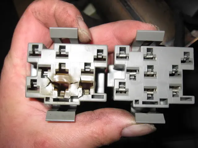

Check for this kind of problem like the other guy did. :)
My headlight switch connector looks like that. (I assume PO left lights on and it got super hot.)
Anyhow where is that connection in the picture? And is it ignition related? Link to other thread?
I don't foresee a headlight switch being connected to the ignition system in any shape but if I'm incorrect or it could have any adverse effects that could be related please fill me in.

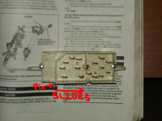

yeah,thats the headlight switch connector in pic above.i think he's using that as an example of the damage to look for on the ignition switch connector harness that connects to the ignition switch in pic below.
when you turn the key,it moves a slide within the column that is attached to the pin,which selects either ACC,RUN,START,or LOCK on the switch.depending on which way you turn the key.

I'll have to pull out my Ford book and see how to tear apart the column to get to that switch.
disconnect neg battery cable,wait a few mins
remove steering column shroud
disengage wiring harness connector from the ignition switch
insert key,turn to RUN position
remove two screws attaching the ignition switch
disengage ignition switch from actuator pin and remove the switch.
----install----
adjust new switch by sliding the carrier to the run position
ensure key is in the run position
install ignition switch onto actuator pin
align switch mounting holes and install attaching screws,50-69 inch pounds
attach electrial connector to ignition switch
connect battery,check switch for proper function in START,and ACC position.make sure the column is locked in the LOCK position
install shroud
(Chilton's)

Davis3 is right, that's a sample of the kind of damage a headlight switch can cause. However, it will not cause ignition trouble, just trouble with your headlights.
