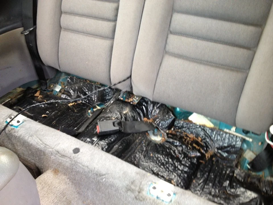

Ok well here it goes, I started the interior restore project today by removing the bottom portion of the rear seat. The 1st one came out easy but the 2nd not so much the clip was giving me troubles. But anyway the rear bottoms are out. I replaced the headliner a few weeks ago so now all I lack is everything else. Which I guess carpet and having the seats recovered being the "big ticket" items. I also want to touch up the console and other areas with a rattle can. Do y'all gents have any recommendations on a paint that would adhere well to plastic?

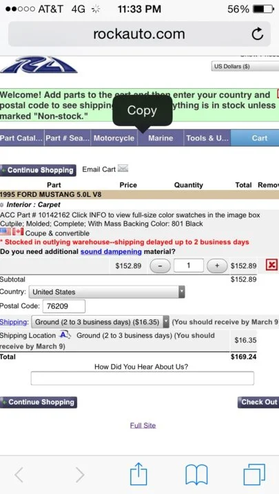

Alrighty slow progress due to weather, time and money but. The backseat is out but nothing picture worthy. Anyway I just wanted to pass along that the cheapest price I've found for ACC carpet w the mass backing is $169.24 shipped from rockauto. Even after paying for shipping it's still cheaper than lmrs and Cj pony with cj's and lmrs discount figured in. So unless they'd price match I guess rockauto it is.. @Steve@CJPony @Tyler@LRS

Rock Auto is great. No free shipping, but it usually ends up cheaper anyway. Better part selection, too.
Yeah I ordered some balljoints from em once and the order got screwed around so I ended up canceling and buying from the parts store for a little more. That's my only experience w em and I'm sorta gunshy about ordering from them again but for the price difference I may take another gamble.
Not going to lie, I can't even come close to matching that price. Sorry.
