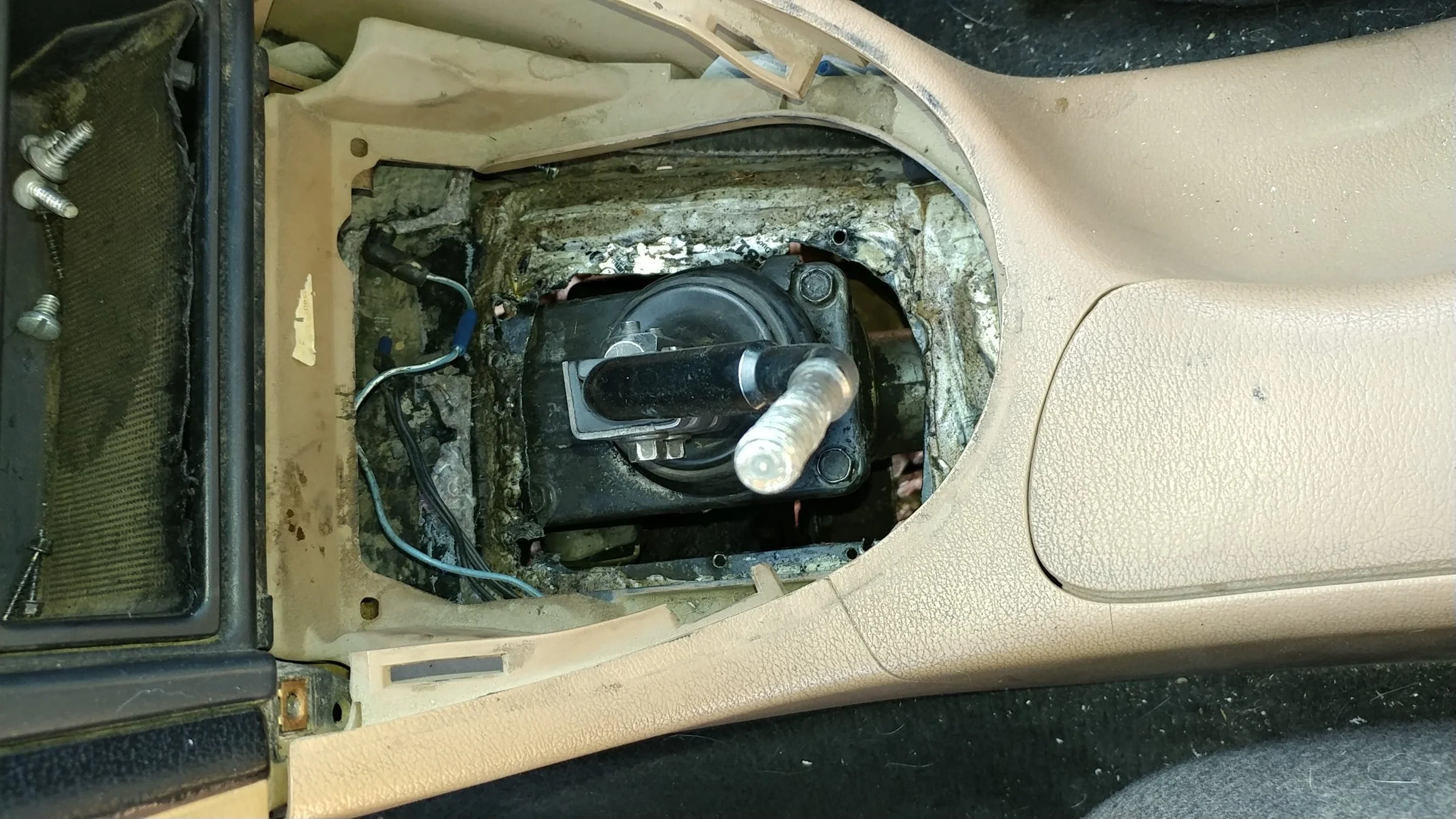

2) on my 95, as @95BlueStallion put it, I probably have a fox body T5 installed in the thing, but, I think they may have used the incorrect transmission mount, or cross member, as the shifter mount almost hits the tunnel and it looks like it may have because the forward portion of the opening is actually bent up (going to include a pic) , so I question the pinion angle being too high also. What mount and cross member could possibly do this? What mount and cross member could drop the pinion angle, in turn dropping the tranny to actually fit correctly in retrospect to the tunnel?

Your shifter actually looks to be sitting right where it should be, as far as front to back placement. Get under the car and look to see if someone added washers/spacers between the trans mount and crossmember, or between the mount and the transmission itself. Its possible the crossmember is fine and correct, and the trans mount is either incorrect for the car, or installed incorrectly. I feel pretty confident that you have the right transmission for the car after seeing that pic though.

There is no difference in the body between auto and manual cars, just a different trim bezel in the console around the shifter. I cant say with certainty if different brand mounts have different thicknesses to be pressing the transmission against the floor of the car. That is why I said youll have to get under the car and check it out, because its definitely not normal to be touching the car. You could have a different crossmember, but I dont know why anyone would change it out unless they went to aftermarket for a high horsepower build. I guess stranger things have happened though, youll just have to check it out.
That car looks swapped to 5 speed. The body is different between the two in the trans tunnel. The 5 speed should have a hump spot welded over the trans tunnel allowing the shifter lower boot to bolt flat to the floor. It also gives you an extra 1/2 to 3/4 inch above the trans tunnel for shifter access.

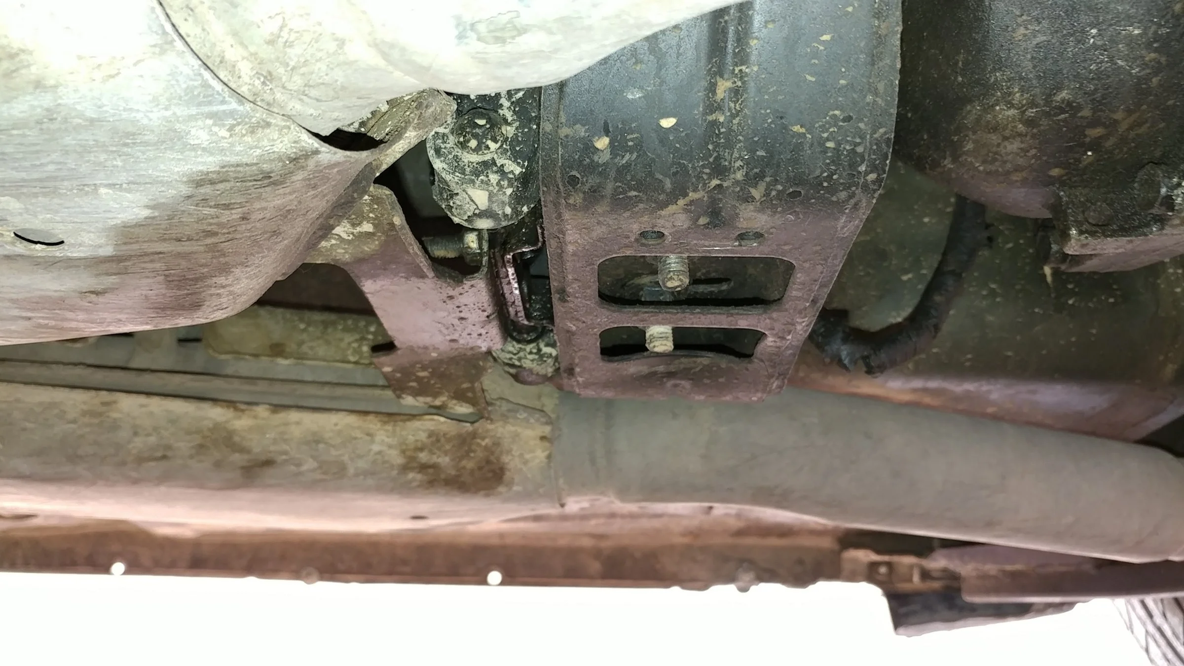

I am sure this doesn't help either (check out the pick) ....seems as though the tranny cross member has taken a serious hit to , and if i look at the transmission compared to the floor pan, it actually sits twisted.
Thank you both so much for the help, this explains everything, and im off to either get a stock double hump or aftermarket one , and a shifter tunnel cap.
