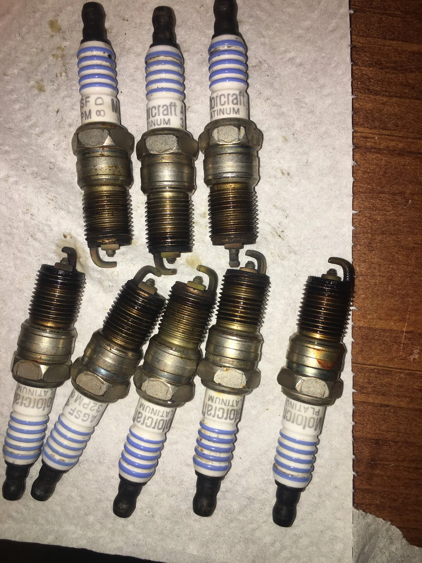

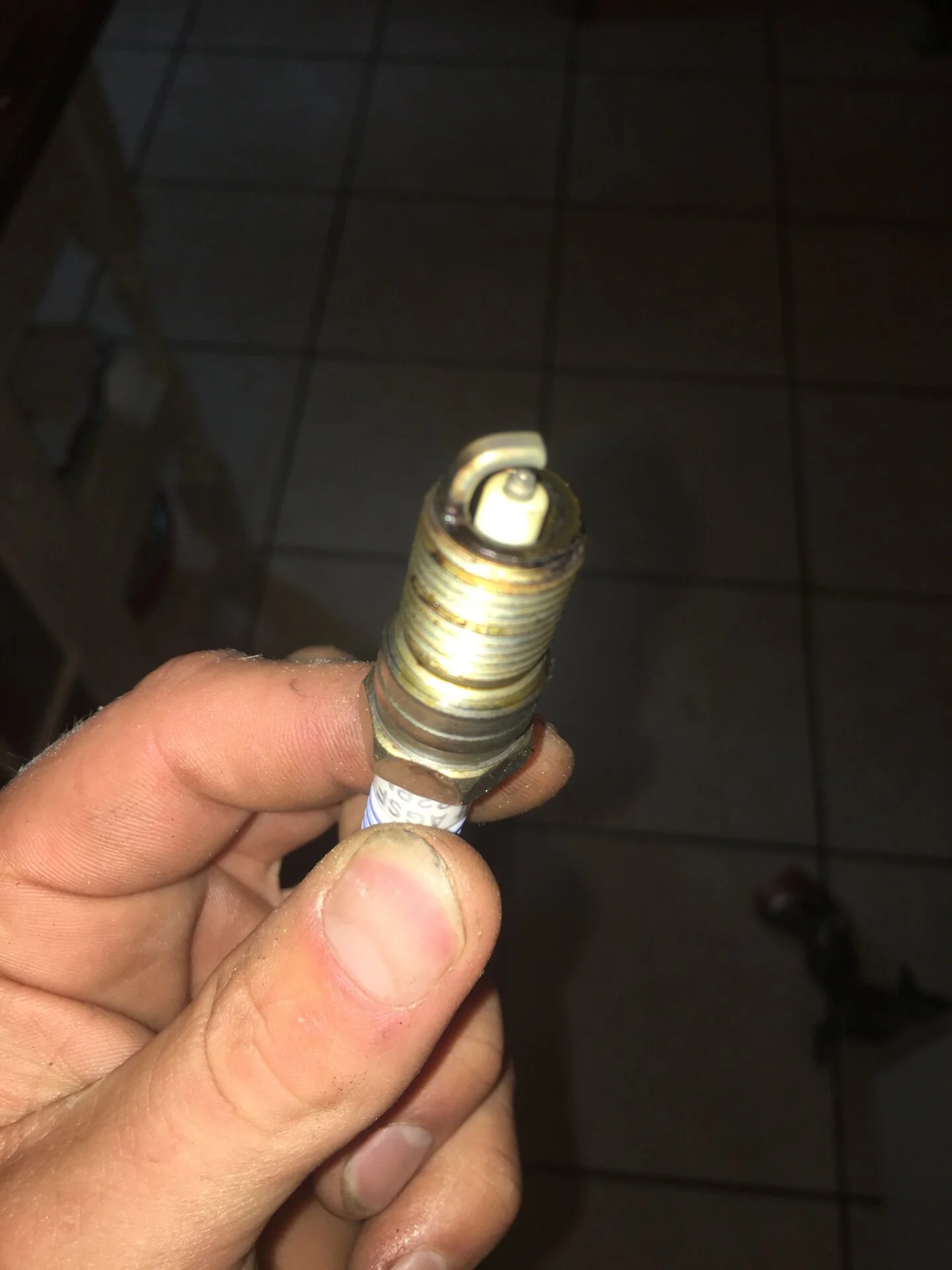

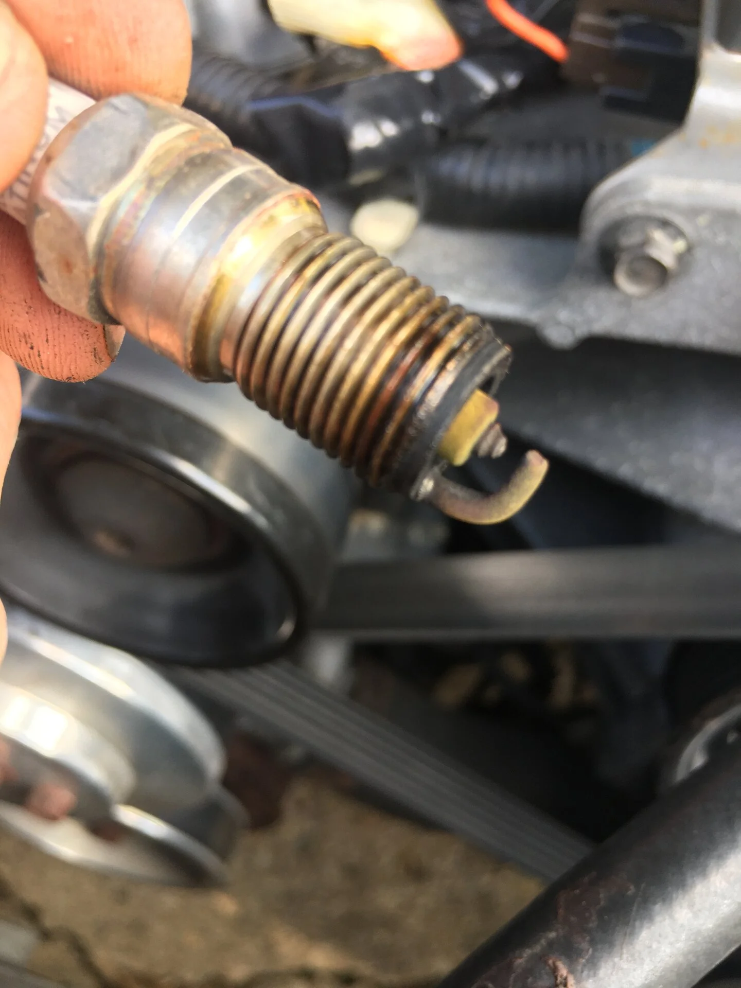

That's a big gap, what kind of plug?
.54 stock plugs I’m pretty sure Motorcraft platinum... The guy got the car from I messaged him asking him he told me he just put the new plug wires on it that he didn’t mess with the spark plugs they all look fouled out... I put the new ones in it’s running so good but one of the plug wires break on me and I can’t get to the back plug on driver side yet... I took it for a ride a lot more power a lot smoother but I can still tell the miss like it’s choking. But when the RPMs was dropping from 2 1/2 to 1 1/2 RPMs it only had a little shake it was before it was jerking... I just feel like something could seriously be wrong.... i’ve never seen spark plugs look like this I mean every single one
