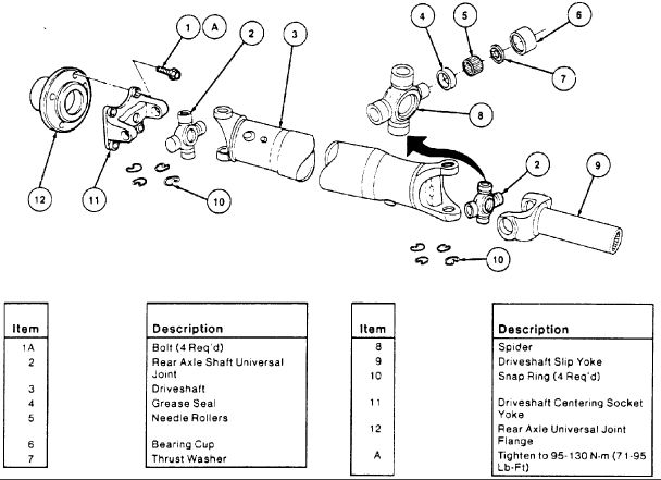

How about the rear axle shaft universal joints?
