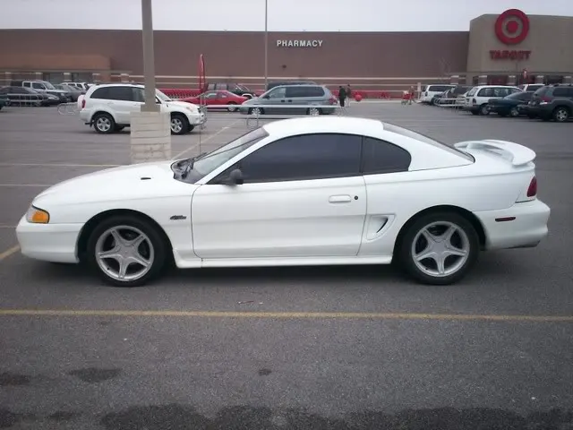

if you're looking for a minimal drop you wont be dispointed w/ Ford C-Springs and Tokico shocks - worked great on my car. People may sometimes say on this board it needs more of a drop, but it's my DD and any lower and i would no longer have an X-Pipe from my college's speed bumps. When you first lower it you'll see 1" front 3/4-7/8" back tops, after is settles for two weeks you'll be at about 1.25" front 1" back. Best things is i didn't ne C/C plates
I mean look how it looked b4!!

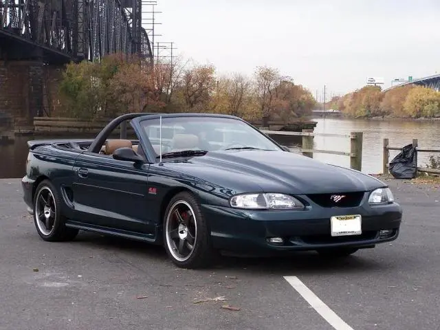

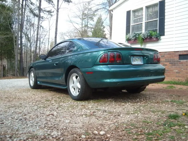

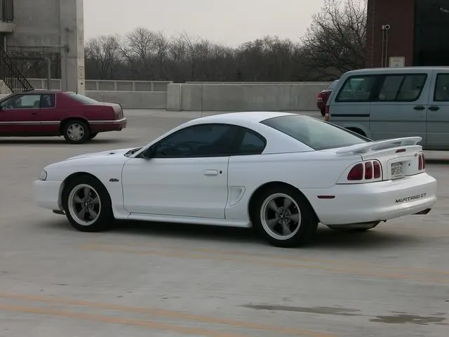

Here is a few pics of my dropped SN95's. The Green one is on Sportlines(2"Drop), the black one on Pro Kits (1.5" Drop), and the yellow one on stock cut springs.
see that sportline drop look so sexy! but i was reading the reviews and some were saying their driveshaft was rubbing, others say the car leans and it never settled, i think some even said it didnt drop it a complete 2" along with alot of " too lox for my x-pipe" comments and the steeda superlites look like a sexy ass drop too and their sopposed ot be a very light weight spring, i just know i would like to bring the fender gap all the way down to the wheel itself i just love that look but... i dont know what spring to go with and i sure as hell dont want to regret spending 250 for springs and 60 bucks an alignment for it to be not what i want IMO DropTopPony has the sexiest drop i've seen and thats exactly what i want something similar to that
