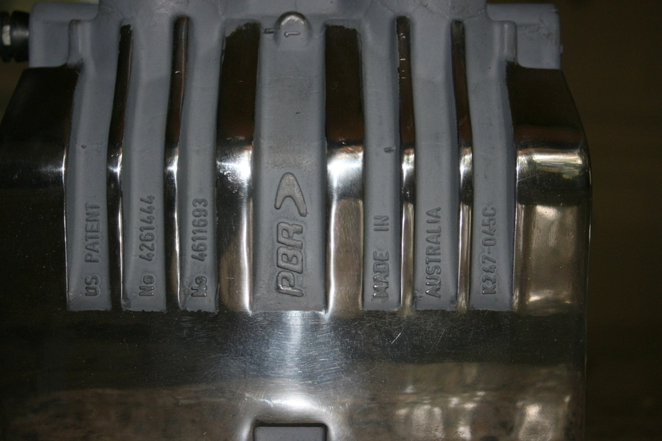

I just picked up some calipers off a 96 gt i saw at pick n pull...

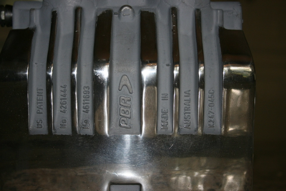

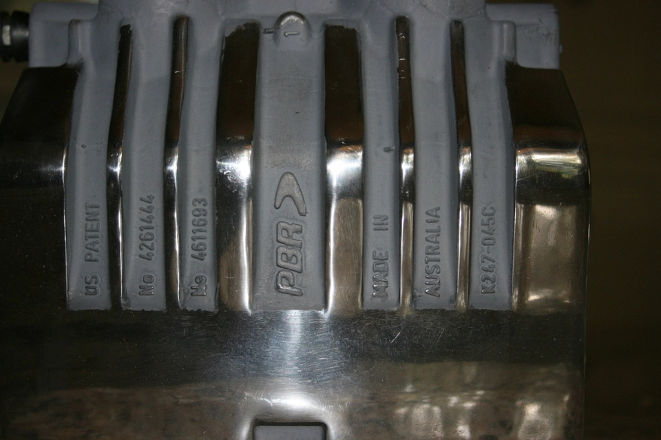

these numbers are on the caliper it self:
no 42614444
no 4611693
how can i get these on my 88 and is will it be worth the headache? im planning on getting 94-95 spindles for a 5lug in the future..
i got the calipers, bolts, banjo bolts and break lines.
tomorrow im goin back to get these 94 spindles....
so i can i get these to work on the 88gt??? thanks:flag:

i dont think these are 'standard' brakes for a 96... when i searched the numbers i put up there it came back as like a cobra brake from some years like 94-04 or some thing.. but these ones i picked up are two piston aluminum calipers... alot bigger than fox ones... by not standard i mean i think the guy took those brakes off another car as an upgrade i also saw some after market stuff like bushings shocks springs and lots of stickers... haha but mostly the car was torn up...

Do ypu have pictures of the calipers? Really need to know what you have to make proper recommendations. There are three PBR calipers, and two designs of the cobra type. Which one you have will influence which MC you ultimately choose to run.

Those aren't 94-98 cobra calipers...they look like c4 corvette calipers or 1LE camaro calipers. Did you get the rotors or the mounting bolts as well?
Any pic of the brackets?
They should work if they are c4 vette calipers as they are the same as what is used on the 1993 cobra r and what was on the 94-98 cobra.
If they are 1LE calipers, they are 12" and you'll need the rotors

What do his part numbers in the first post come up as?
Well yes, the design is just like the Cobra calipers, but the only year the Cobra received the "ribbed face" caliper was the 1993 Cobra R. Some aftermarket kits may have come with the calipers as well.
I think SSBC sold kits with those calipers as well..but they were also OEM on the vette. Difference is the vette uses larger mounting bolts so just want to make sure the spindles werent redrilled for them

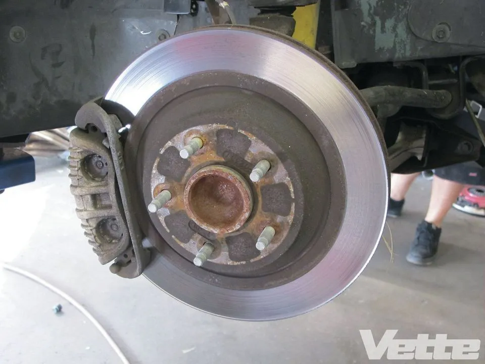

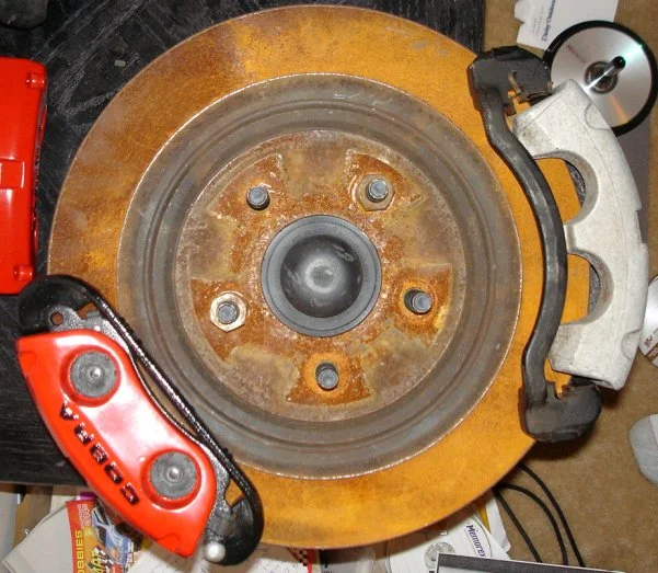

Do they look like the caliper on the right?
If so, those are 99-04 GT/V6 PBR's. 10.8" rotor.

they do look like 1LE calipers now that you say that..... i did get the bracket and bolts. But no i didnt get the rotors cuz they were f'd up.. they look like around 12" or so but i didnt measure they were deff bigger than stock... i have the p/n in my first post if that helps.. vette stuff did come up when i googled the p/n's... but so did cobra stuff...

More than likely they are 38mm calipers compatible with the mustang. Post a pic of them side profile with the mounting bracket. I'll be able to tell from site.
As to which size caliper, look at the pistons. Ribbing on the pistons like left are 38mm pistons like 94-98 cobra. Flat piston bores like right are 99-04 cobra/bullitt/Mach calipers and are 40.5 mm pistons

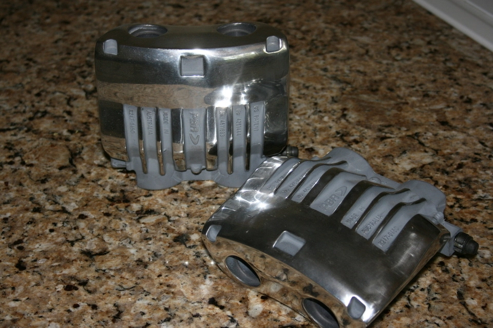

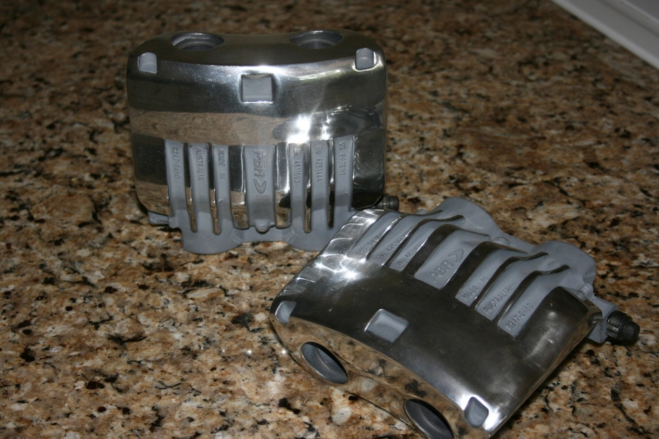

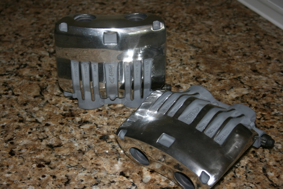

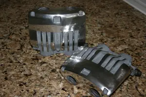

5L5.... Here's the ones I've got:
sorry i didnt post a pic in time... but the one here is exactly what i have...shape p/n and all... so how can i use them?? is it possible to use them with a 4 lug config?? prob no but thought id ask...
They'll bolt to a 94+ spindle but I've not heard of anyone trying to use them in a 4 lug configuration. Even if you could, it uses a 13 in. rotor... be kinda hard to find a rim large enough to accommodate, that wasn't a 22 and 4 inches wide. lol
