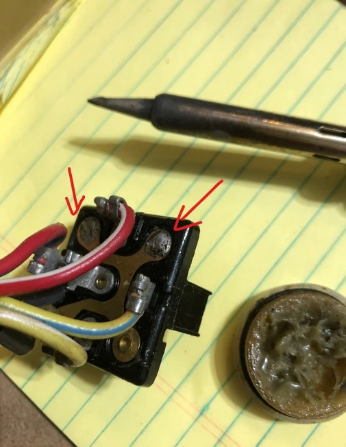

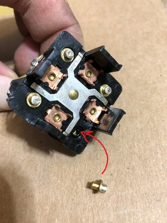

While this is 13 years later than the original poster, my '96 Mustang Cobra power seat switch stopped working in 1 of the directions. Disassembled the switch and everything looked fine. Cleaned. Same problem. Volt meter read inconsistently. Hmm, after looking at prices and availability for parts in 2023 online and local junkyards, I was measuring to model a 3D replacement built from two DPDT switches (because that's all the joystick/switch is).,,,and I happened to tip the part over and gravity pulled out of the corner contact pins out. It likely was manufactured with a subtle defect. So, if your switch is mysterious broken, carefully examine the pins. For the solve, I used some flux and solder to bond the pin to the right area and then the volt meter read consistently. Good for another 27 years.
