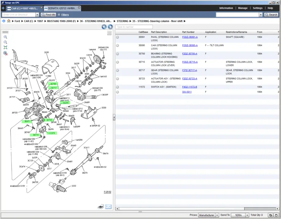

From what you describe, I'd be inclined to say it's the ignition switch inside the column behind the lock cylinder.
I forgot the SN95s still used that complicated system with the switch mounted to the outside of the column and a bunch of different parts that push and pull on the switch. Here's the diagram from the parts catalog, with all of the related parts highlighted for you, with part numbers.
Thanks for the diagram! I began taking the column apart. Guessing that I will be able to take just the front off and see if I can find something broken or just replace that part. Is it possible to connect the battery back up so I can move the seat back? I removed the airbag and steering wheel.
As long as nothing is touching anything that will short it out, it should be okay to do for a short period of time to move the seat.
