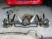

Like was said earlier 93-98 Cobras all came with a solid rear axle from the factory. 99-04 Cobras have the Indepentant rear suspension (IRS). It's possible the owner did a swap but you would they would have told you.
Here's a picture of a soild rear axle (93-98 Cobras)

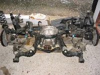

Here's one of the IRS (99-04 Cobras)

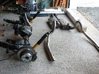

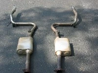

If you need more take a look at your exhaust, for the soild the exhuast will curve up and over the axle
The IRS will look like this, going under the diff, toward the rear tires and then towards the rear bumper.
Hopefully the visual comparision helps
