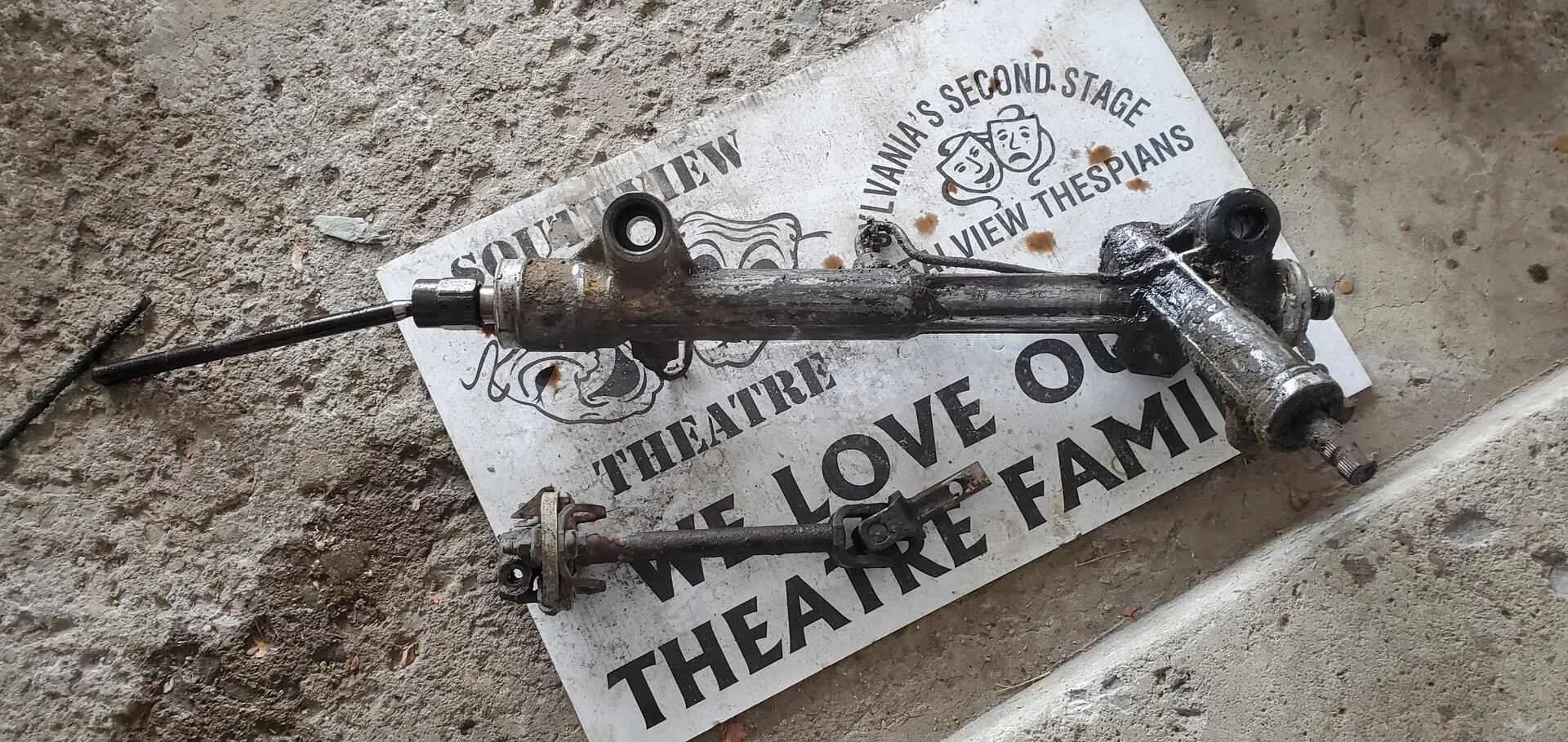

This project has turned into replacing damn near everything I hadn’t in 2014 because everything I come across needs to be lol... rack and pinion, power steering pump, lines, sway bar (bushings weren’t even in place), splurged on new BBK Long Tubes (old ones were rusty), lots more cleaning (more on that in a second).

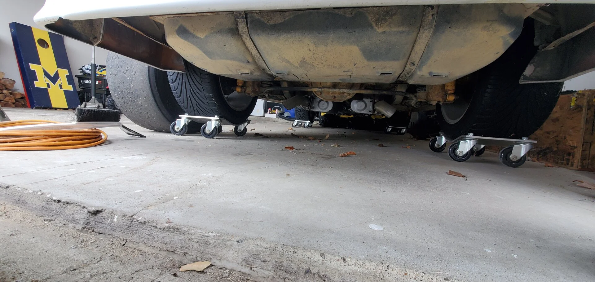

Onto the rear... I decided to clean the underside similar to how I did in the front. I knew when I bought it that the underside was crazy dirty, as in it had a coating of dirt. I kinda figured that the prior owner after getting the car back from his engine build went on a joy ride either down a muddy dirt road or got drunk and actually went in a field lol. All these years of ownership it’s been like a bucket list thing to buckle down, and clean up the underside and make it like it should be. So I’ll list my cars engine, tranny, etc details below and start some sharing some pics in follow up posts...

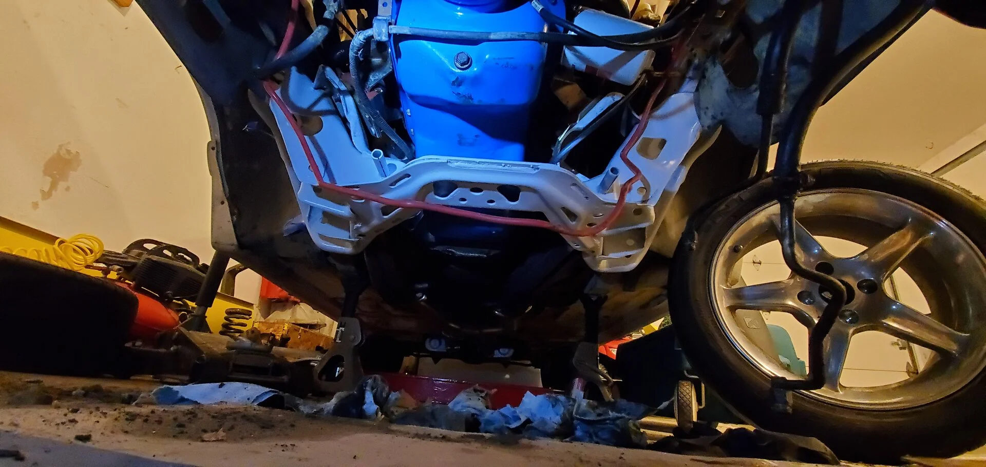

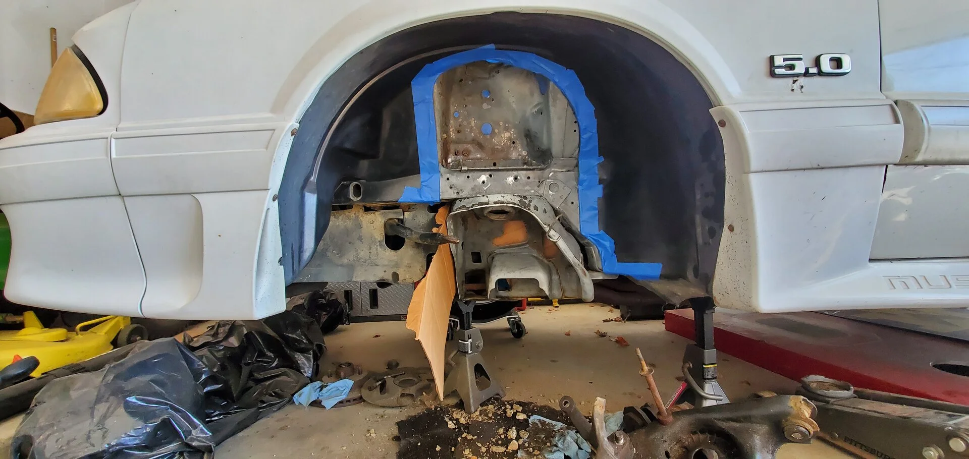

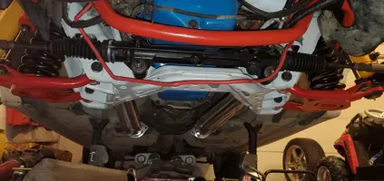

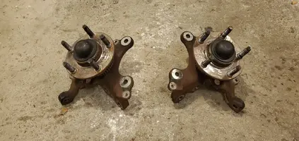

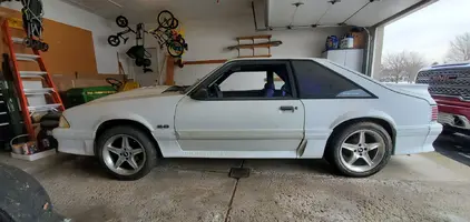

January... some pre-tear down pics

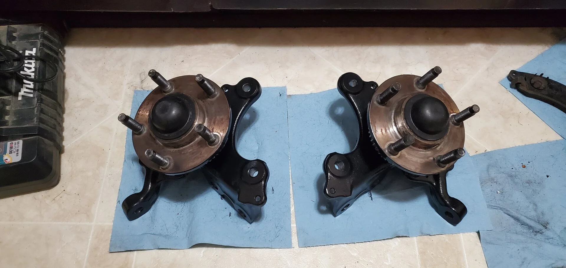

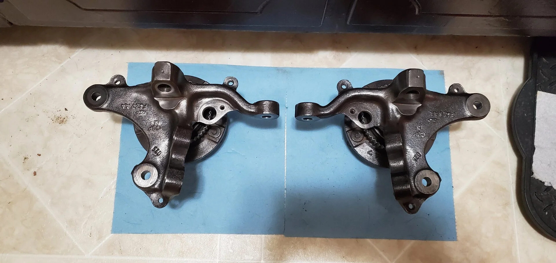

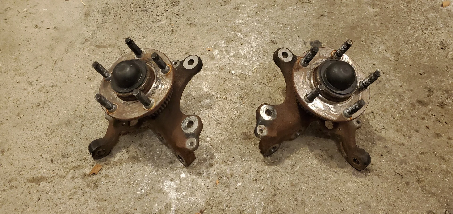

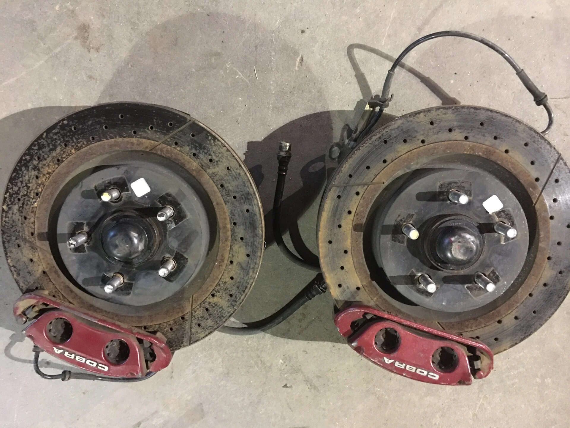

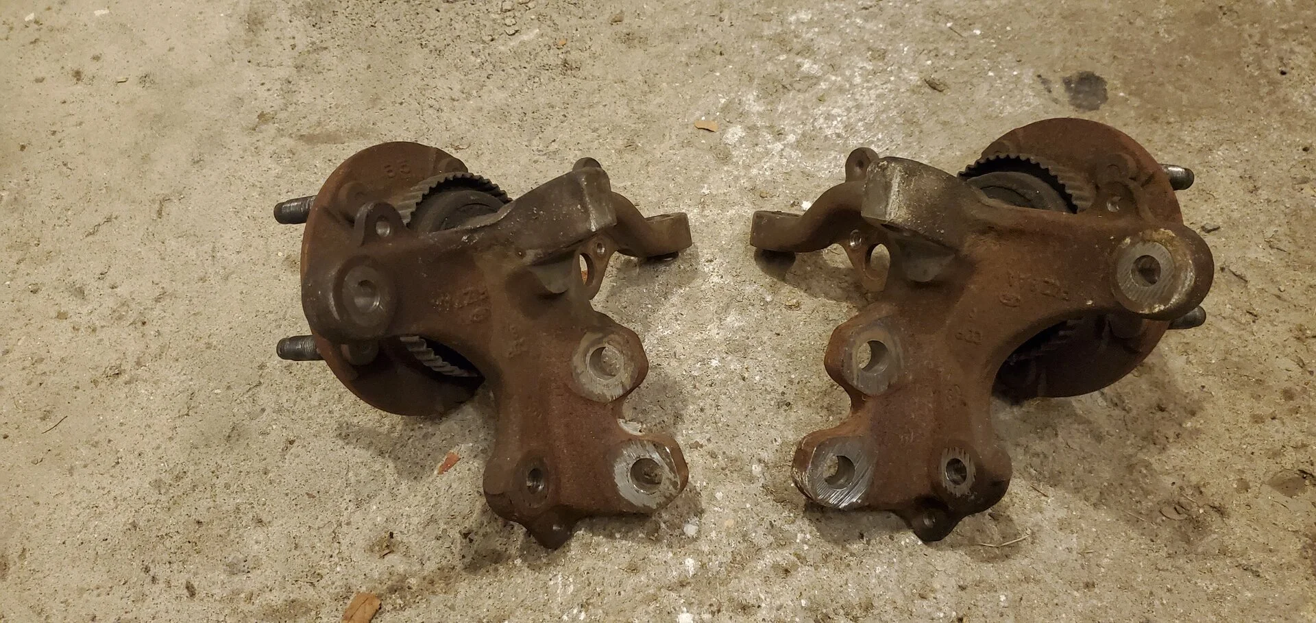

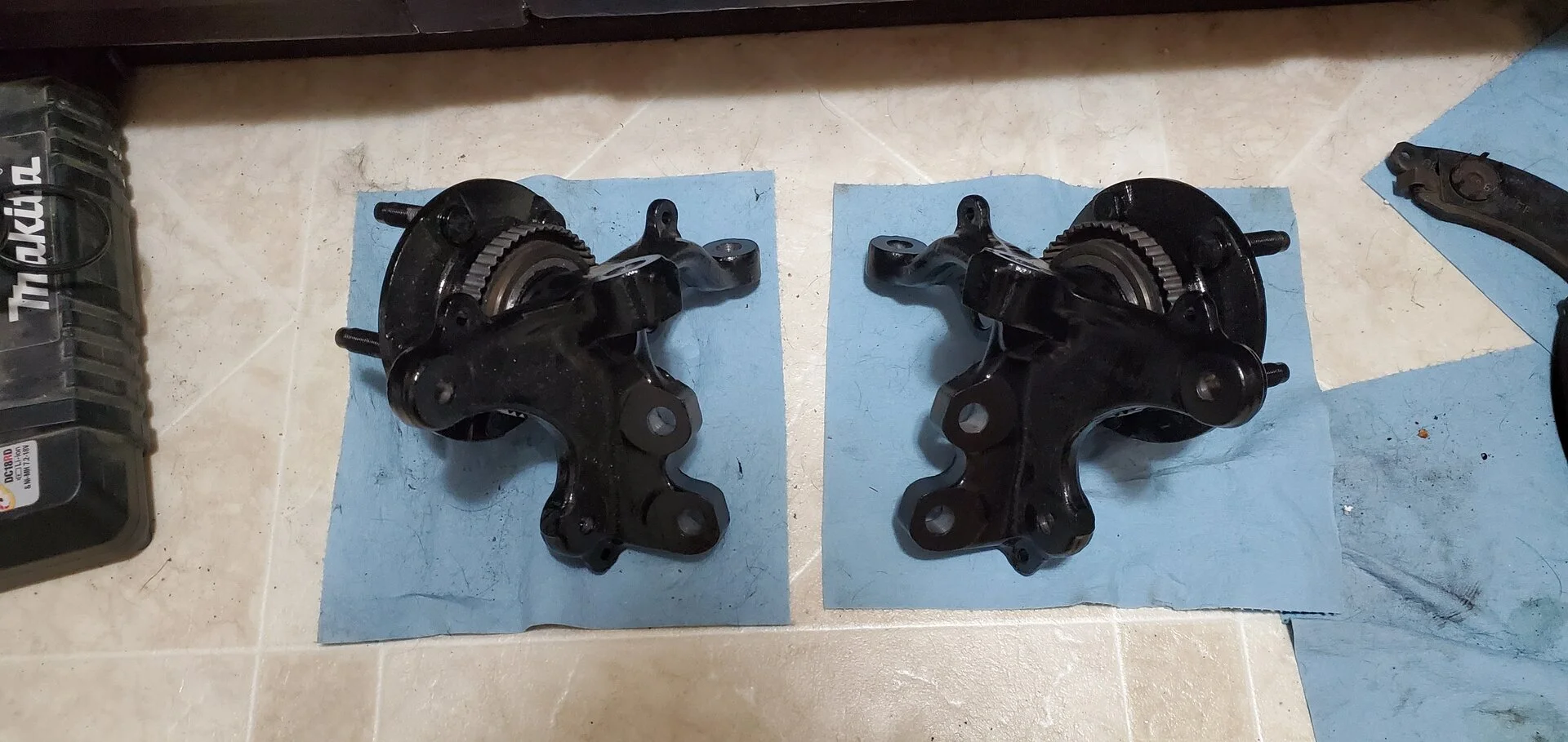

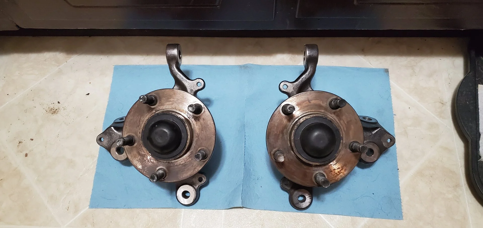

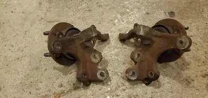

95 Cobra Spindle Refurbishing...

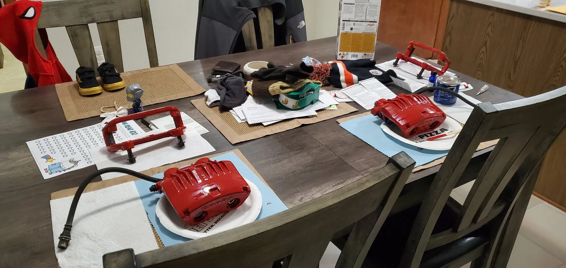

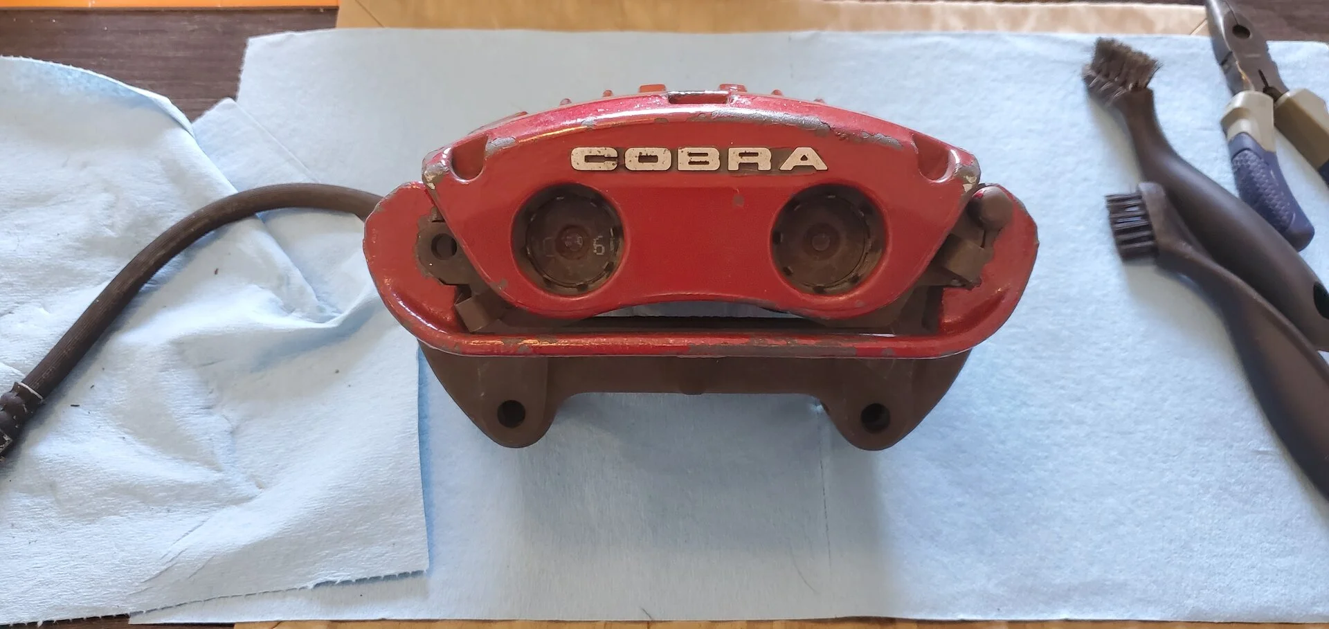

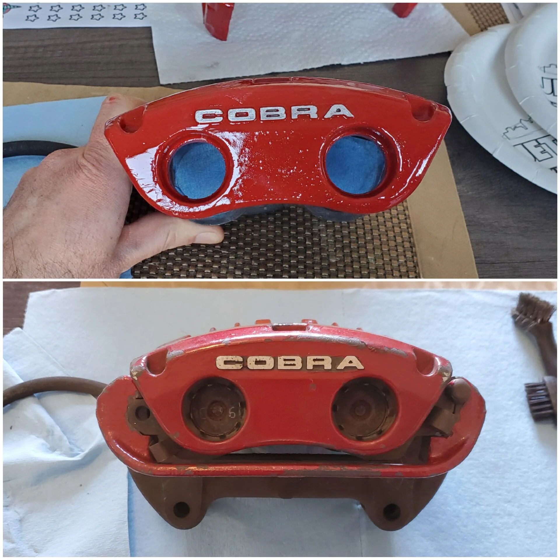

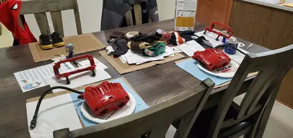

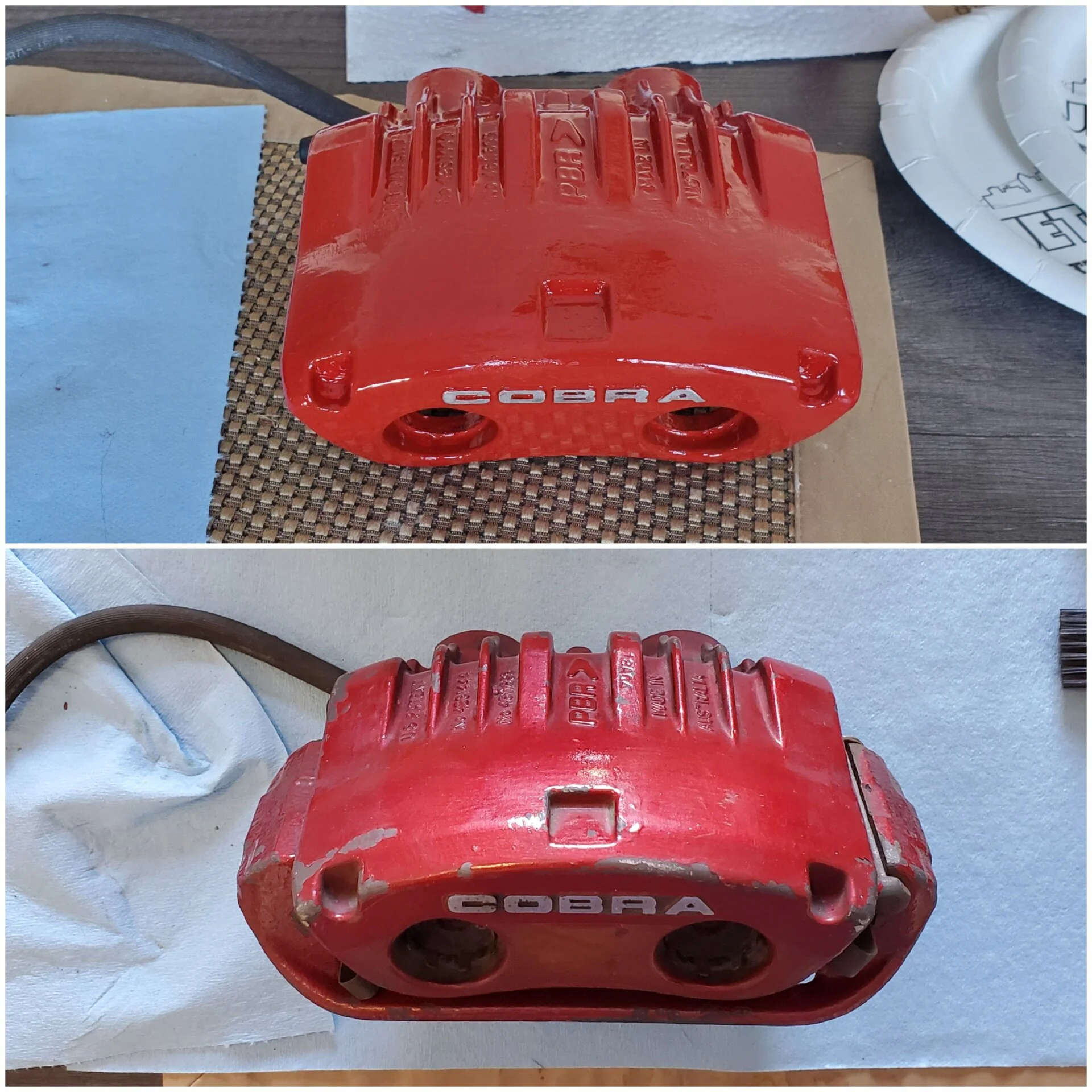

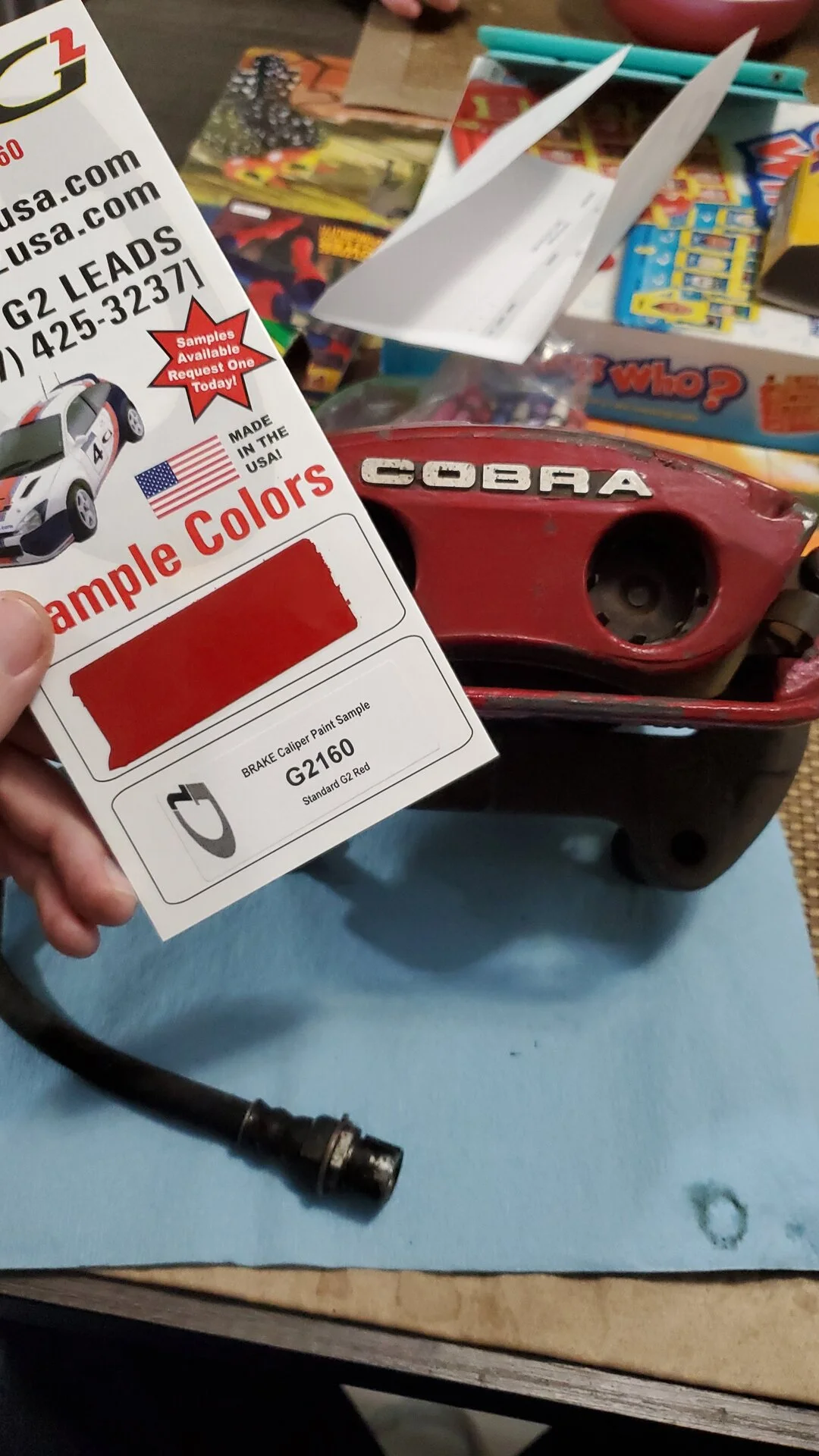

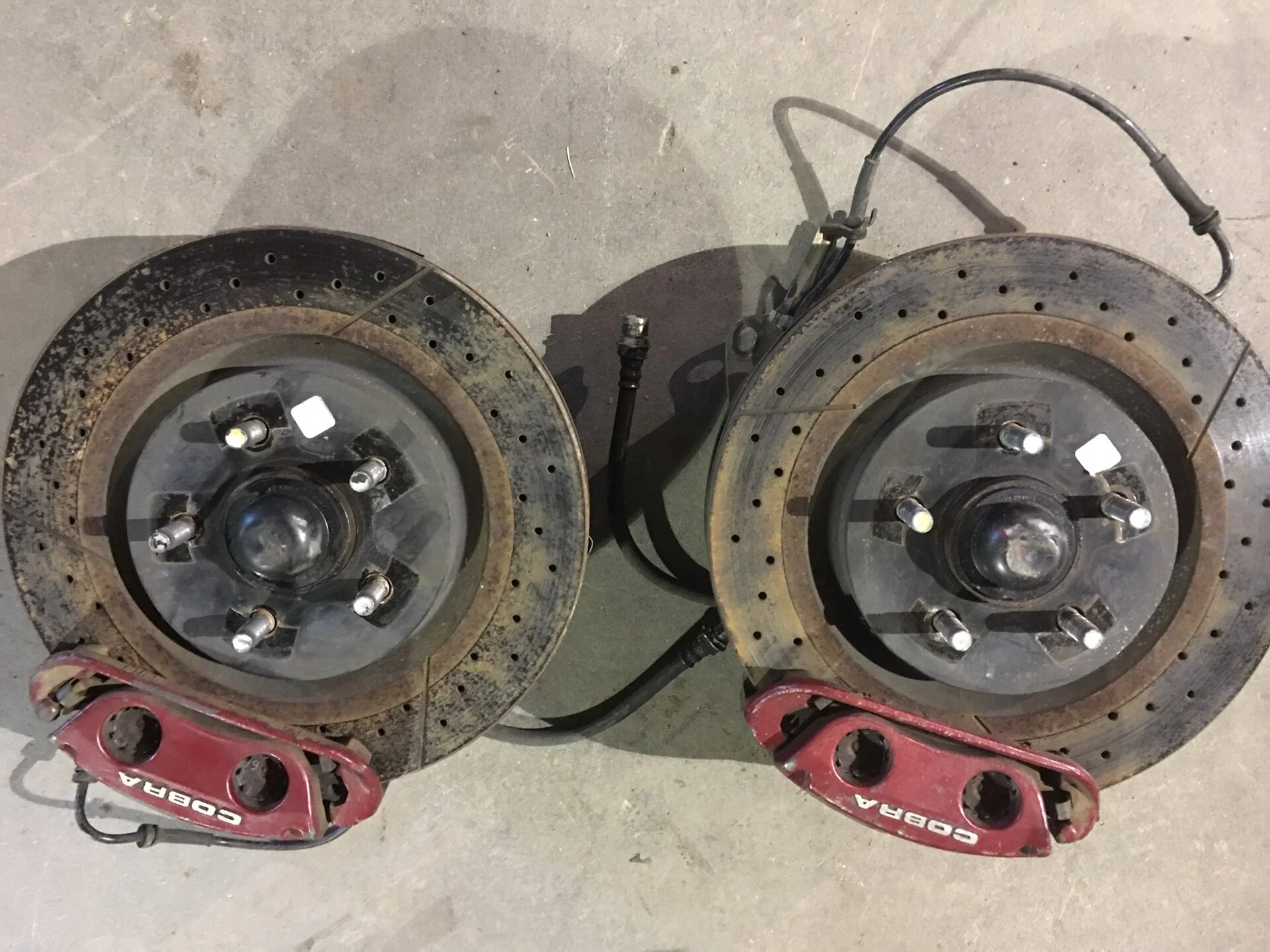

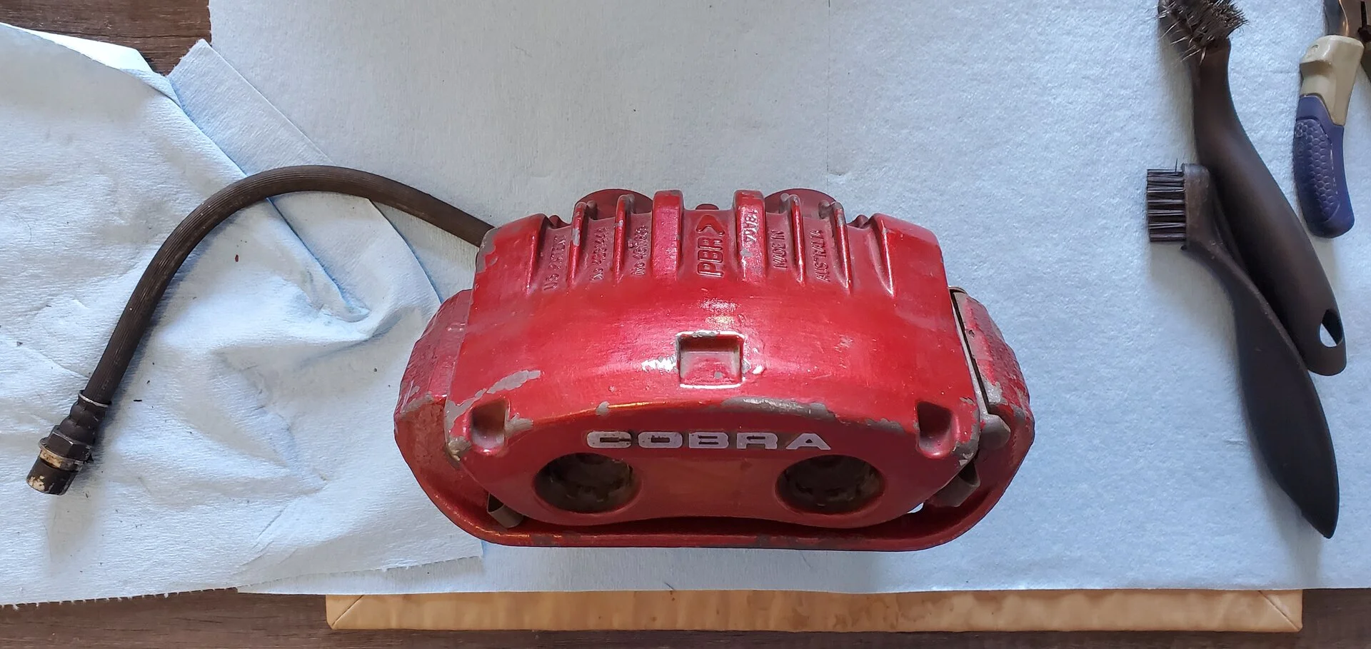

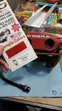

Redoing the Cobra Calipers/Brackets

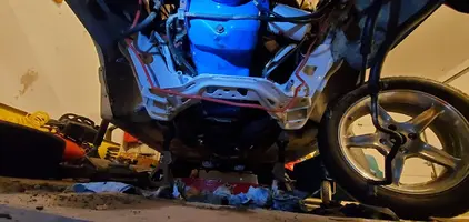

Man, it feels like I did this front end work ages ago - it was late February... but here ya go, as I continue to update my project
Front end disassembly, suspension clean up/paint work

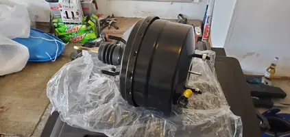

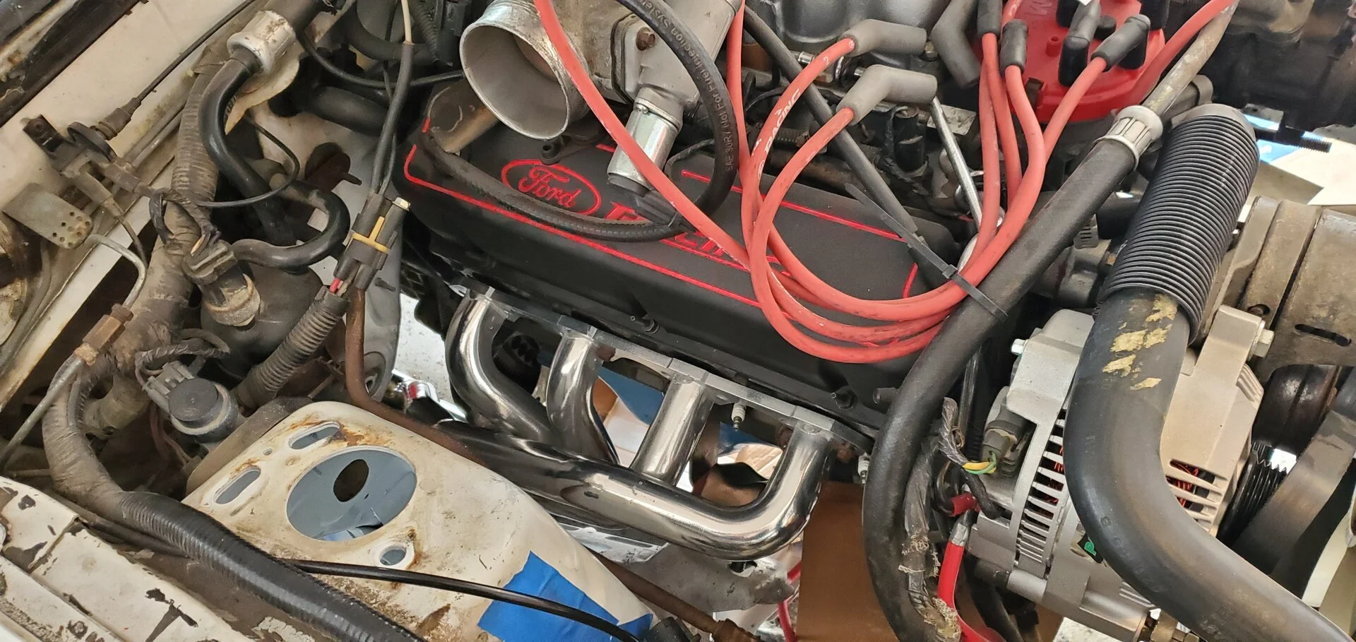

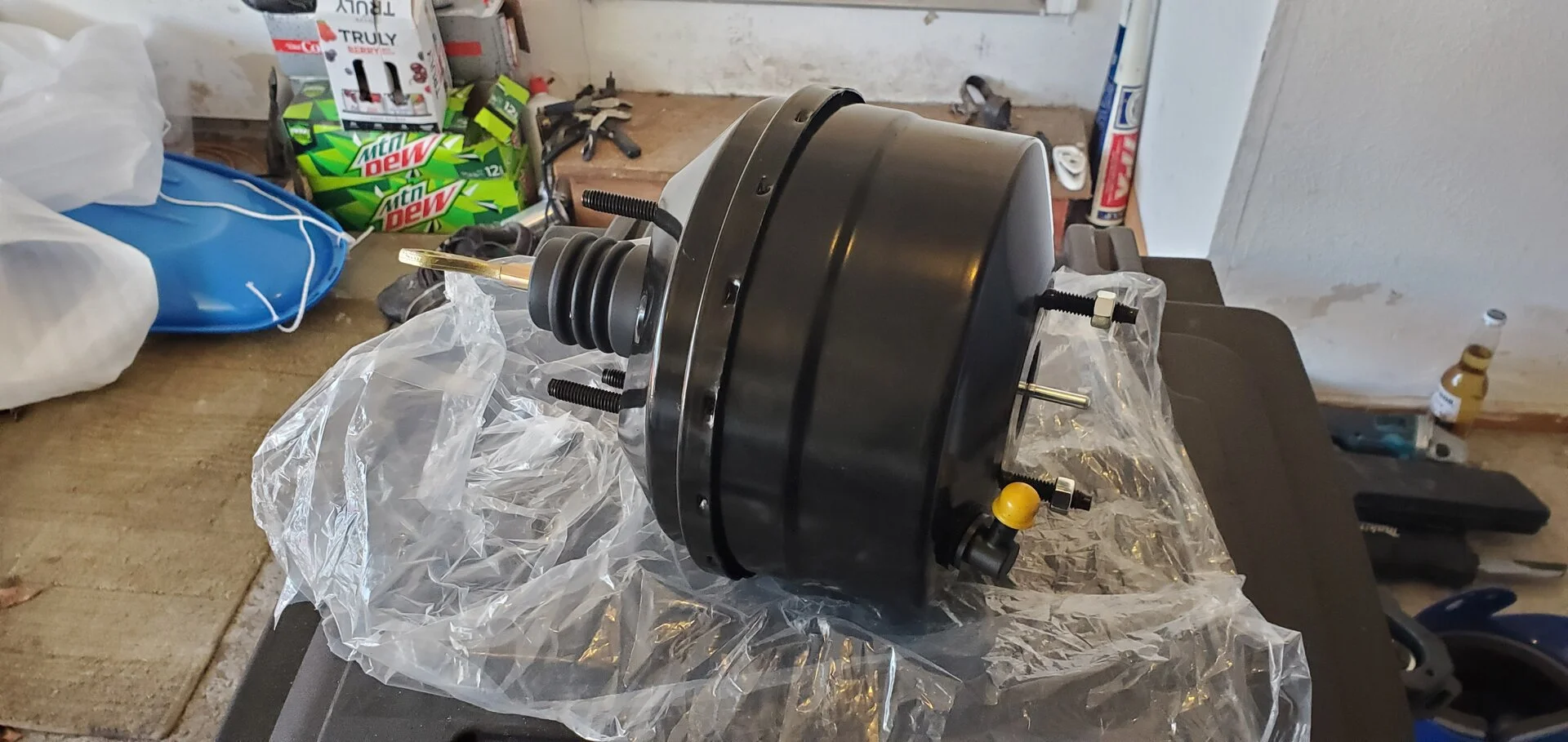

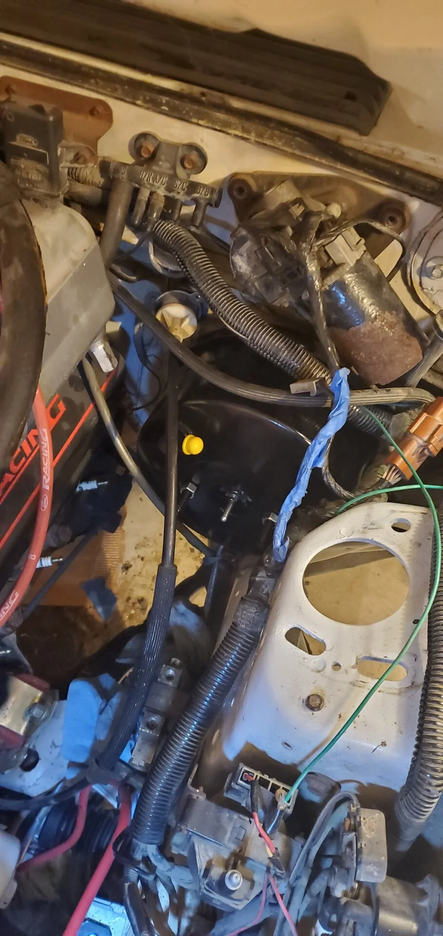

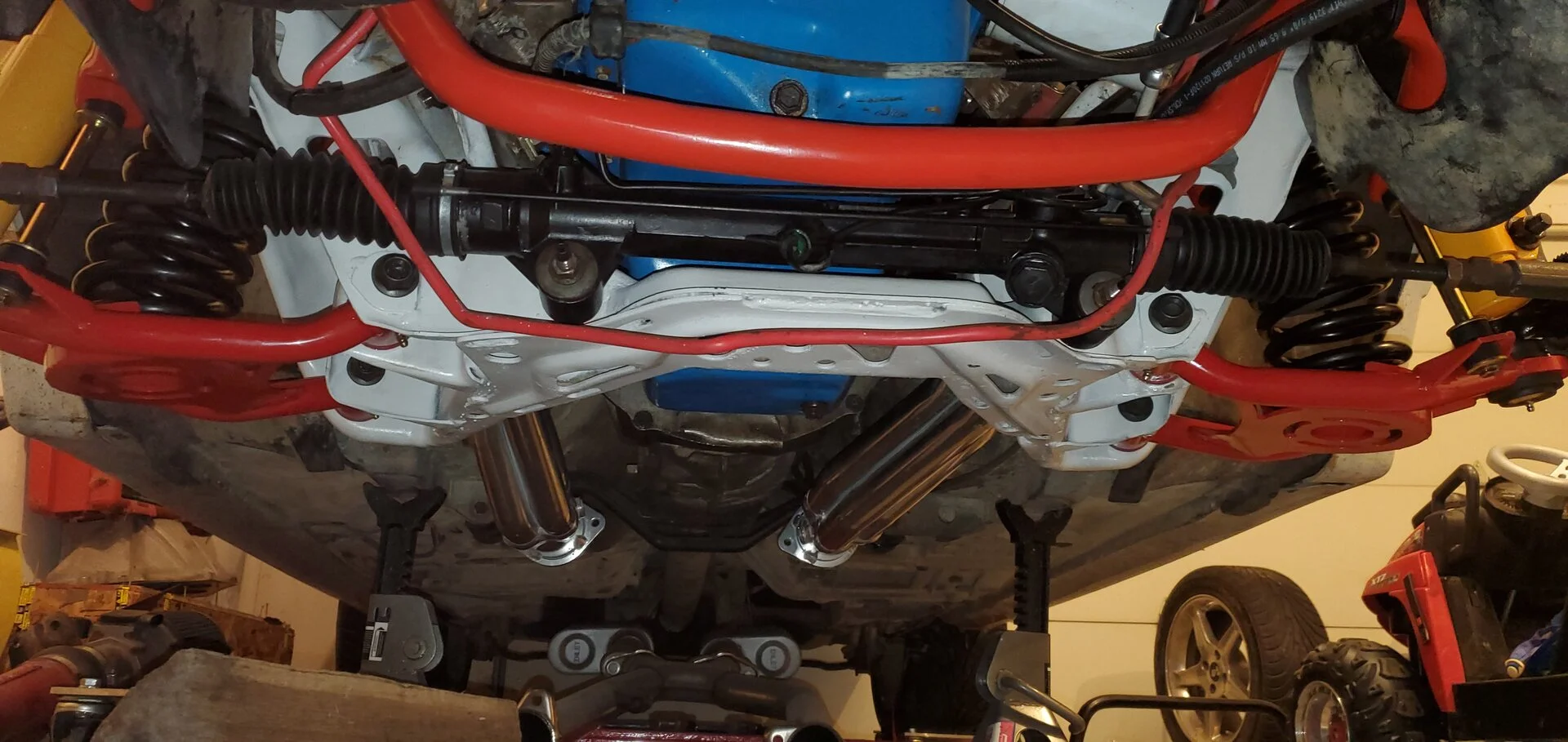

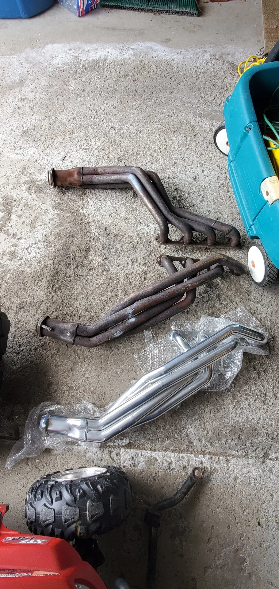

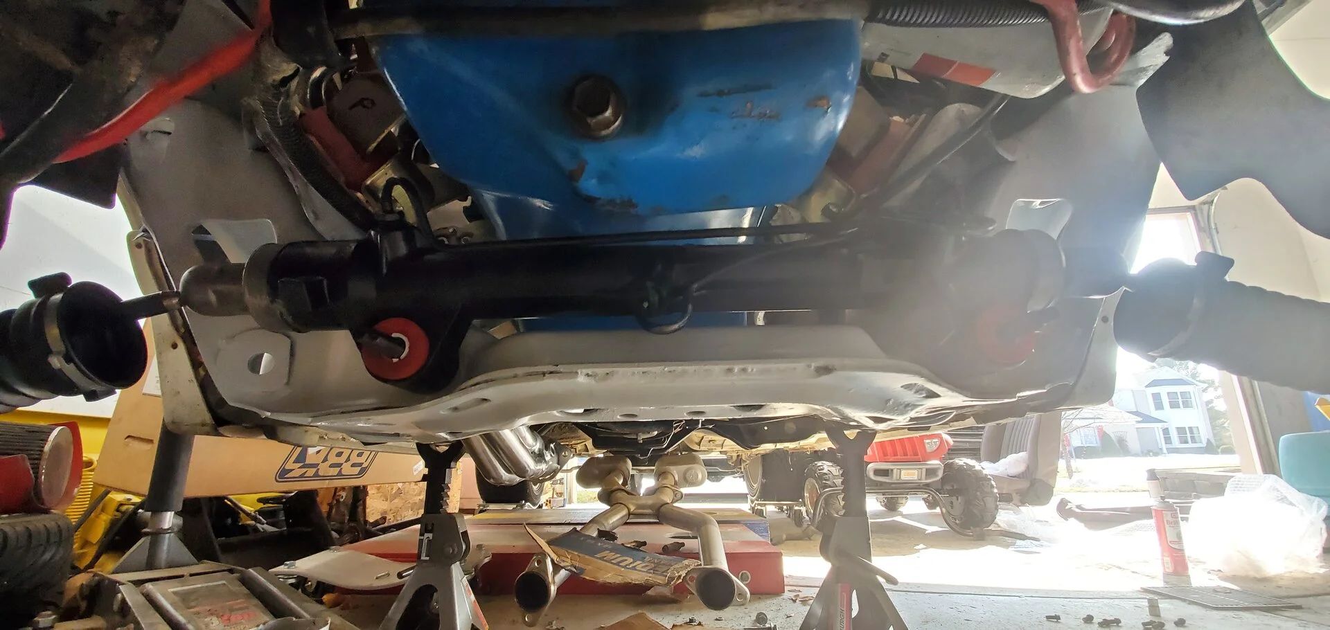

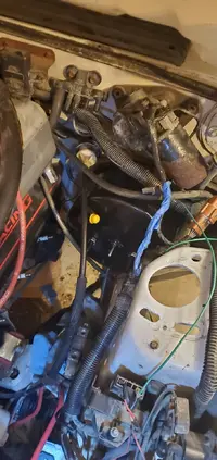

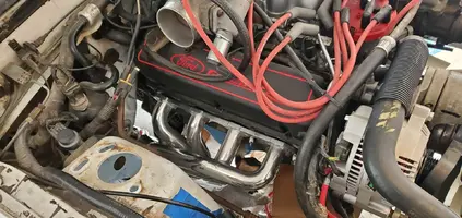

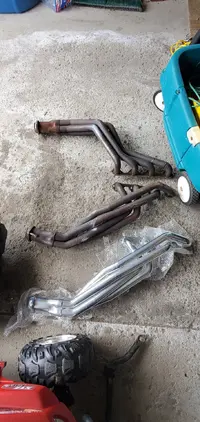

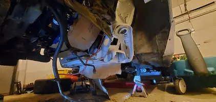

New Headers, Brake Booster (super tight fit), and Terminator Steering Rack

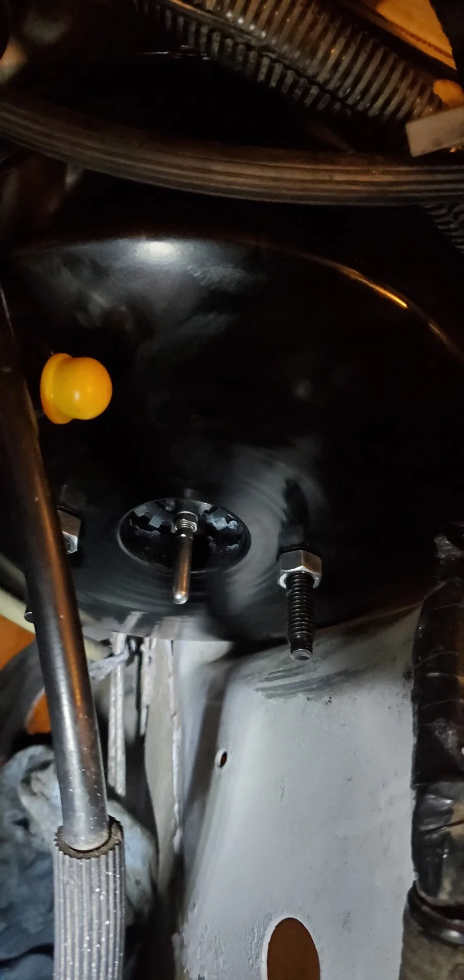

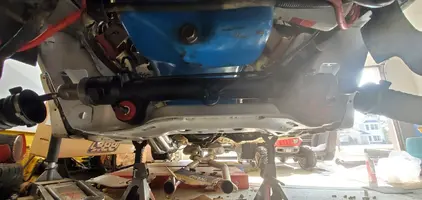

Front suspension back together - Part 1
Along with front tires arriving and centering the wheel to the steering rack

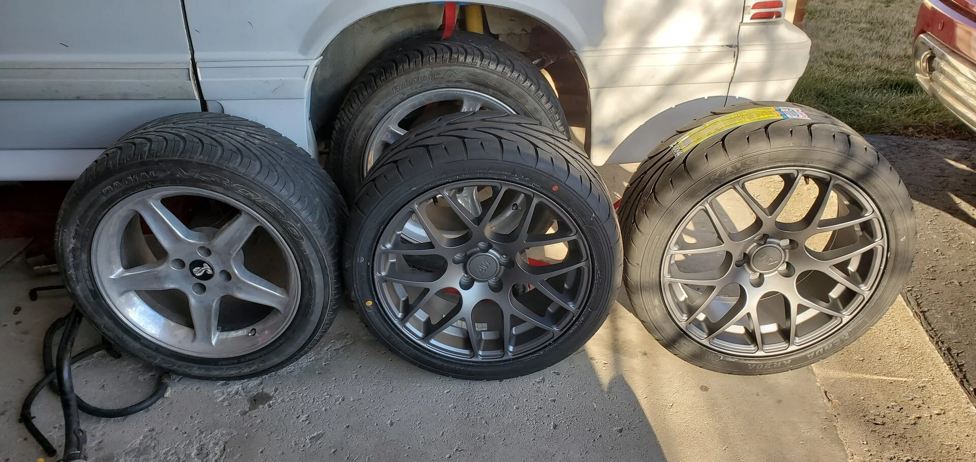

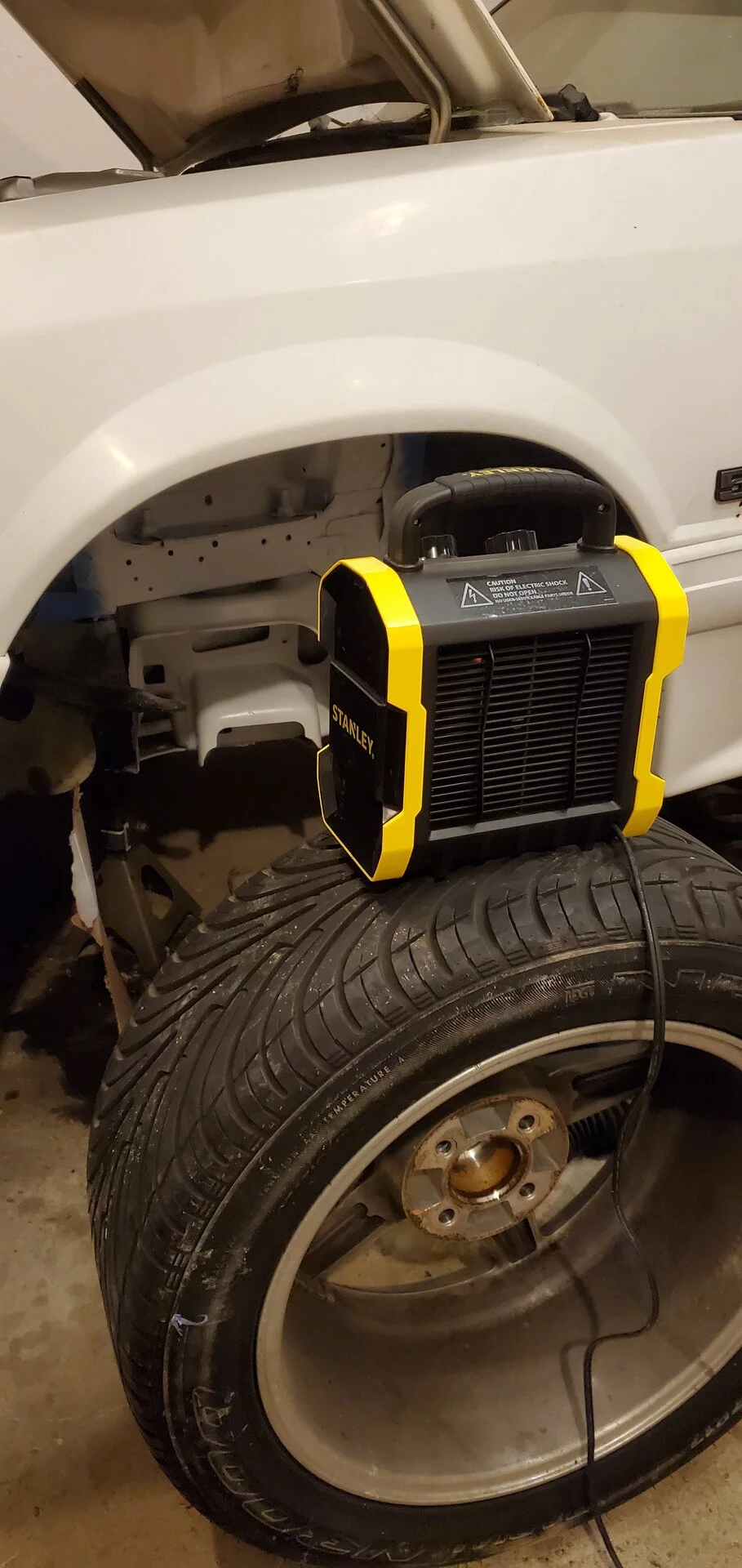

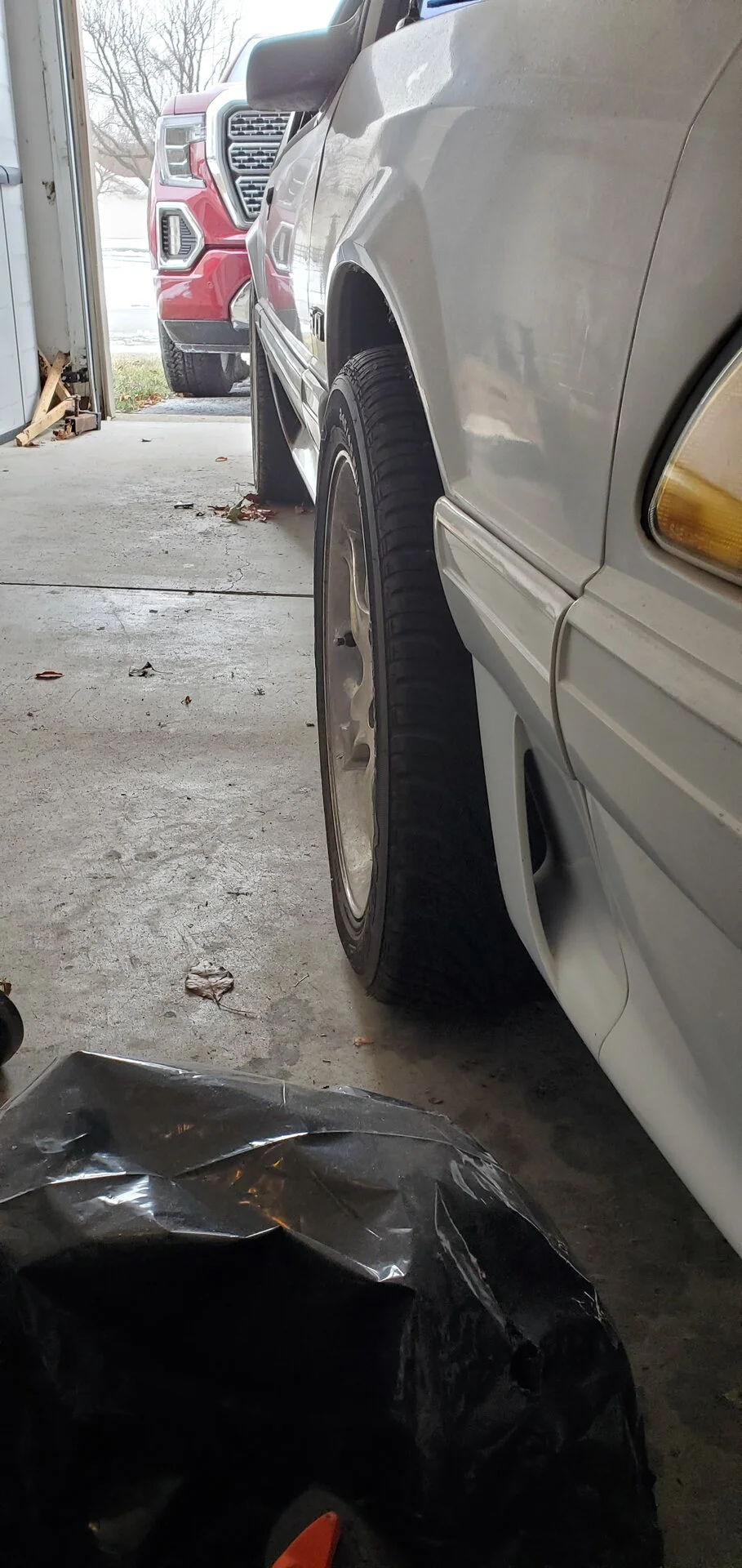

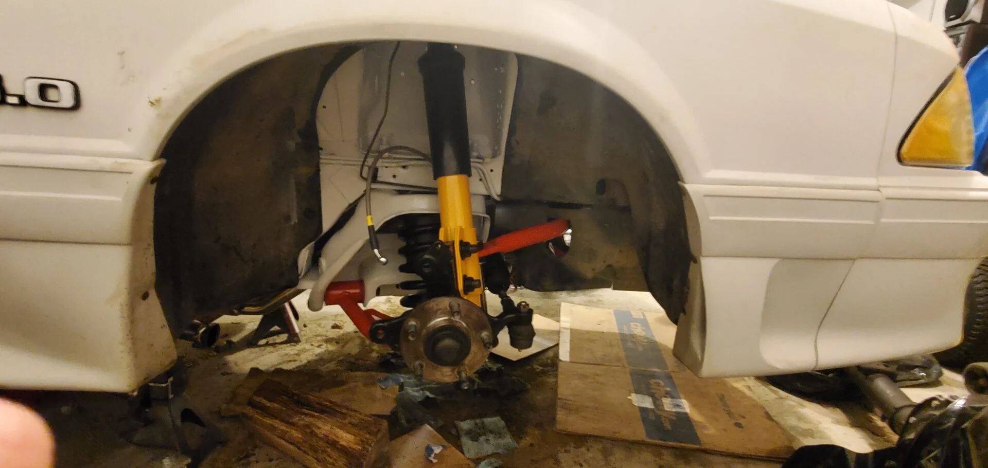

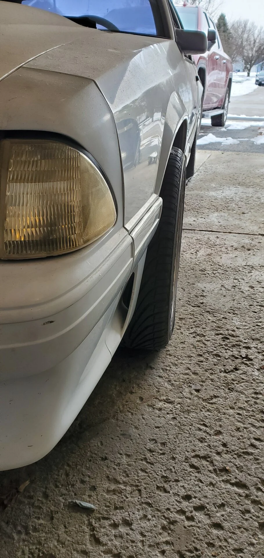

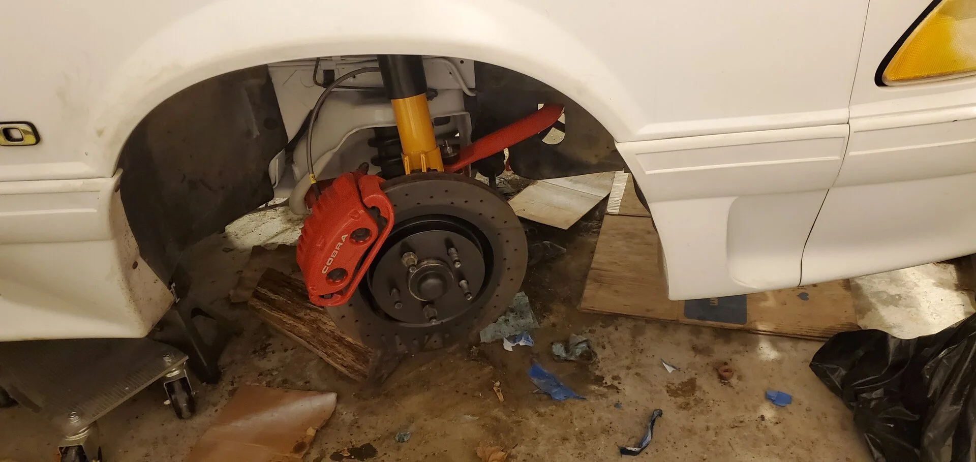

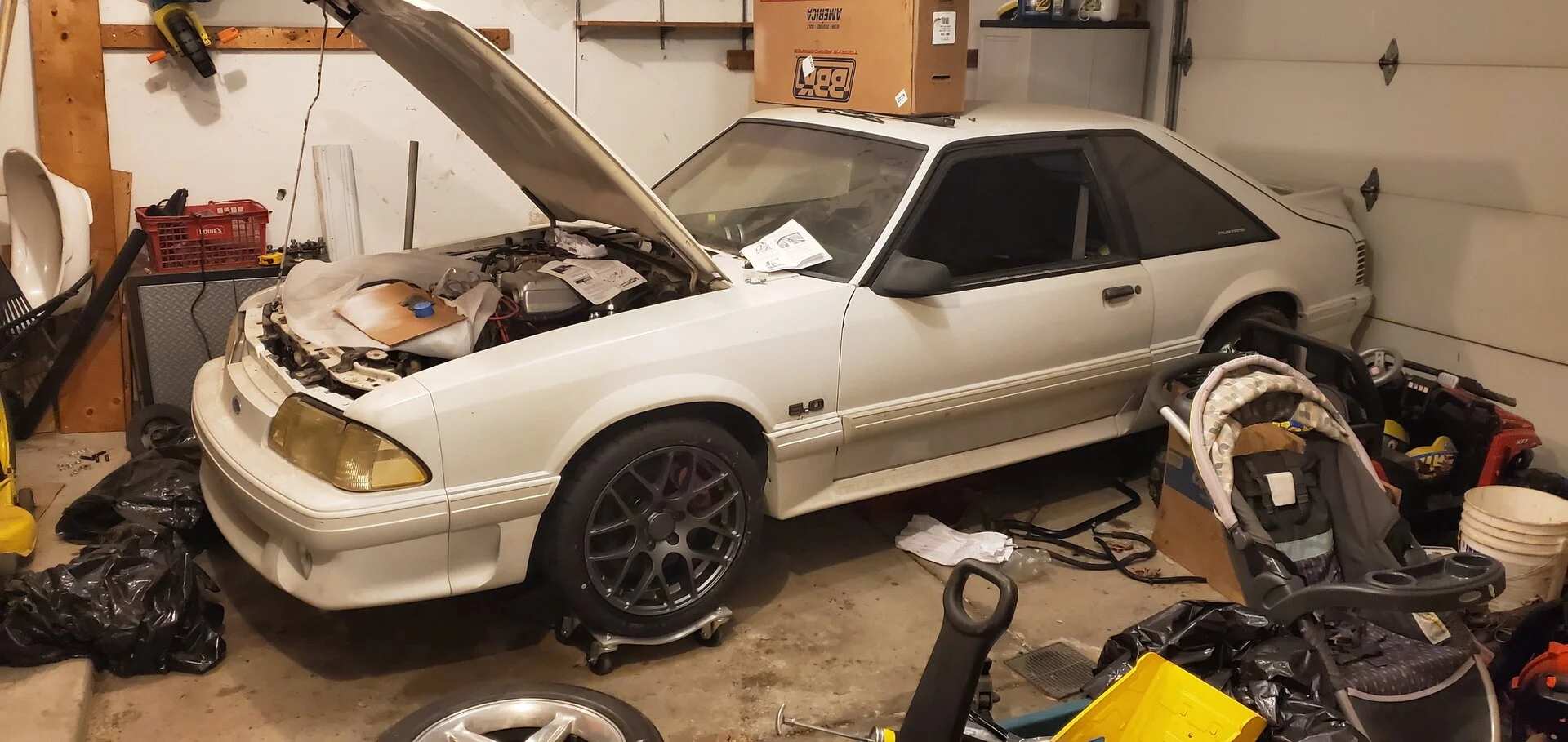

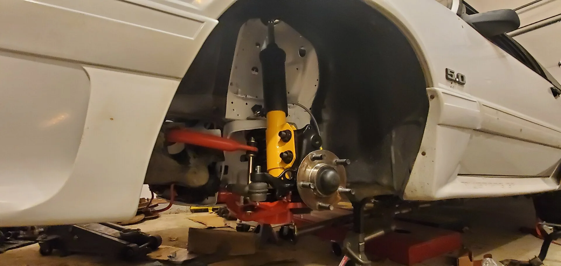

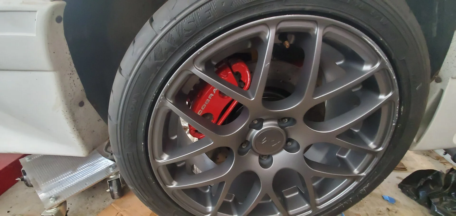

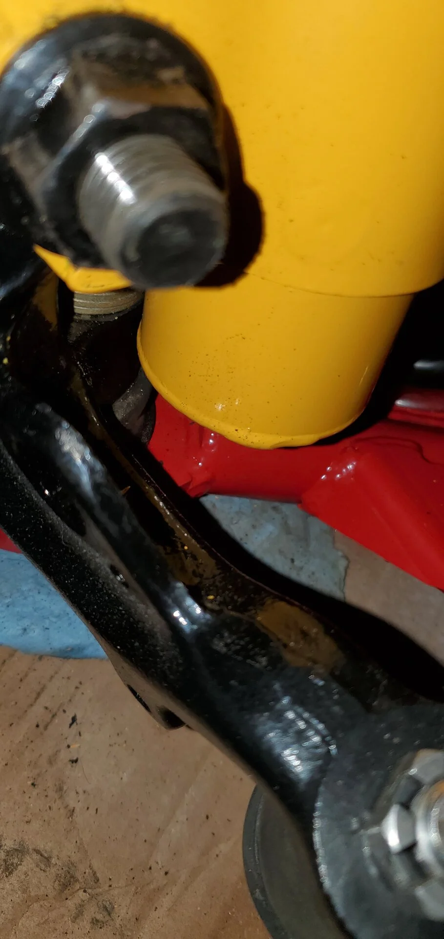

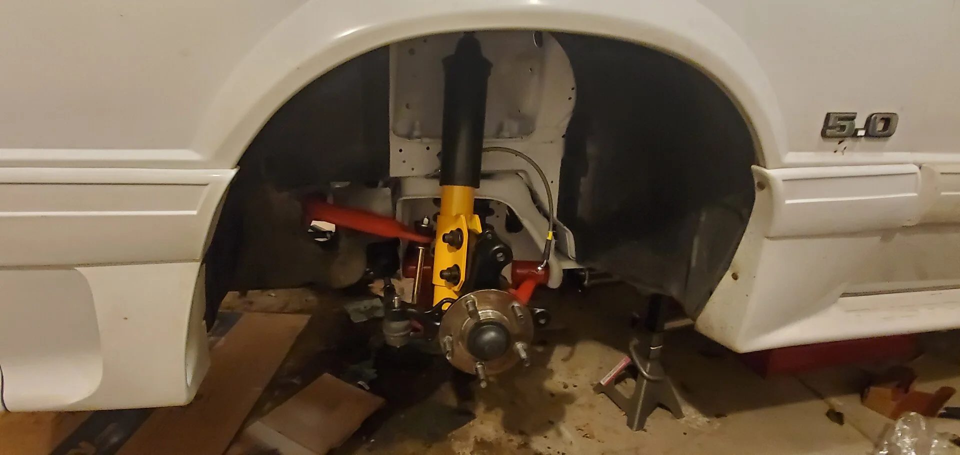

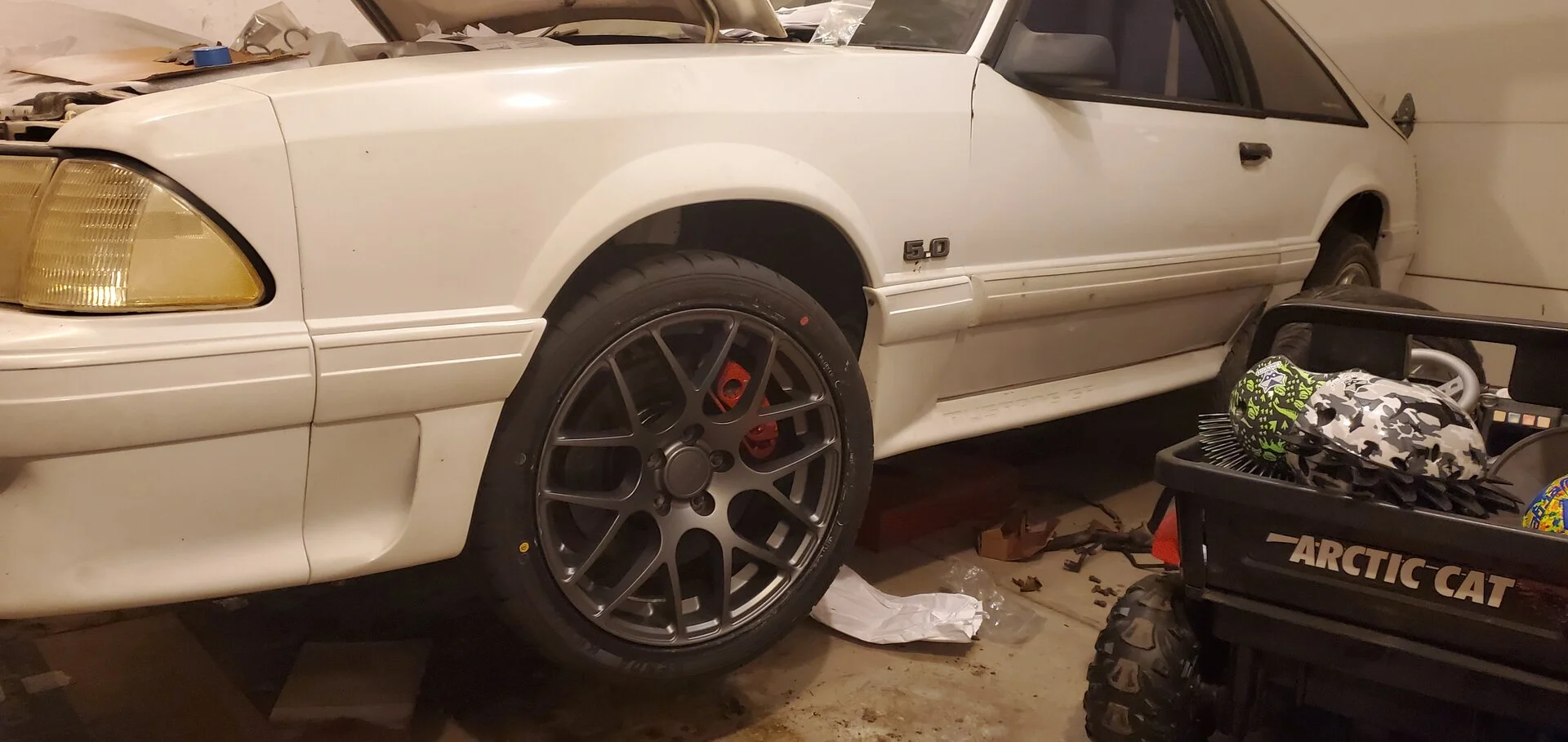

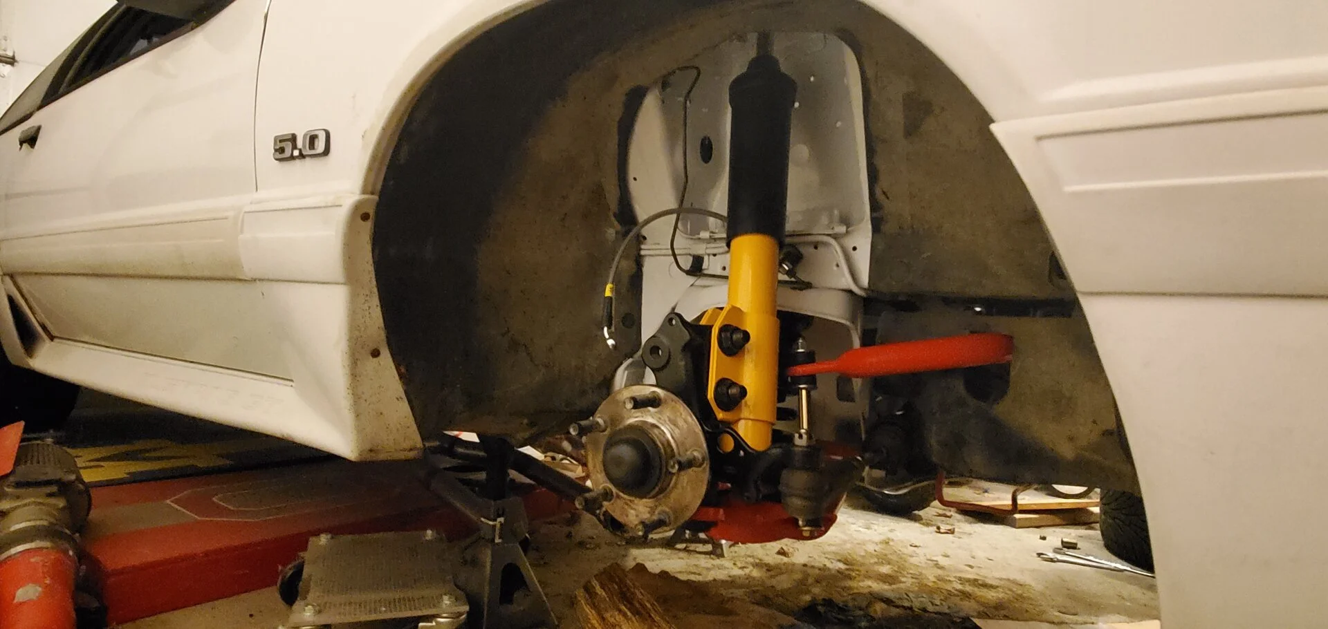

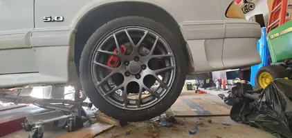

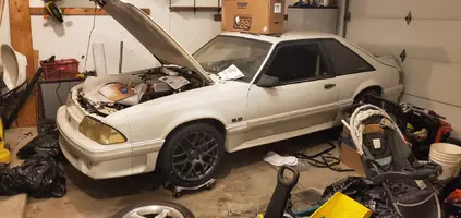

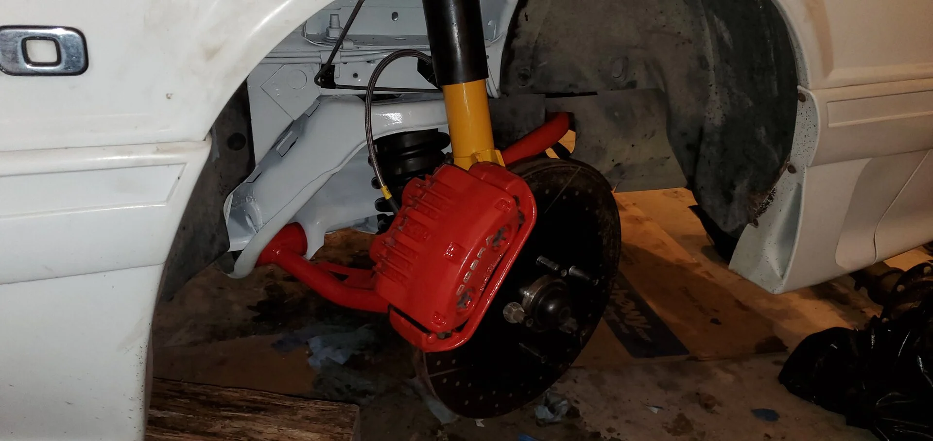

Front suspension - Part 2 (front end done except for MC install, which in real life I did last night)
Install of front rims and tires
Also included, using washers as the ball joint spacer because the outside diameter of the supplied spacer with the BMR Control Arms is too big and rubbed the strut
  • Drool

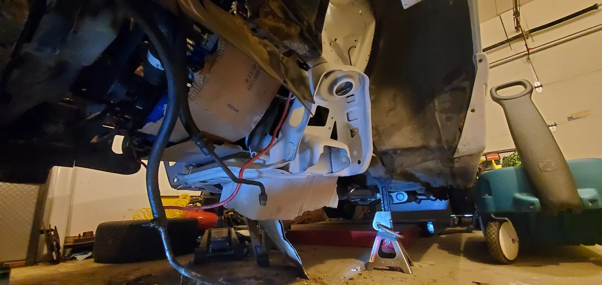

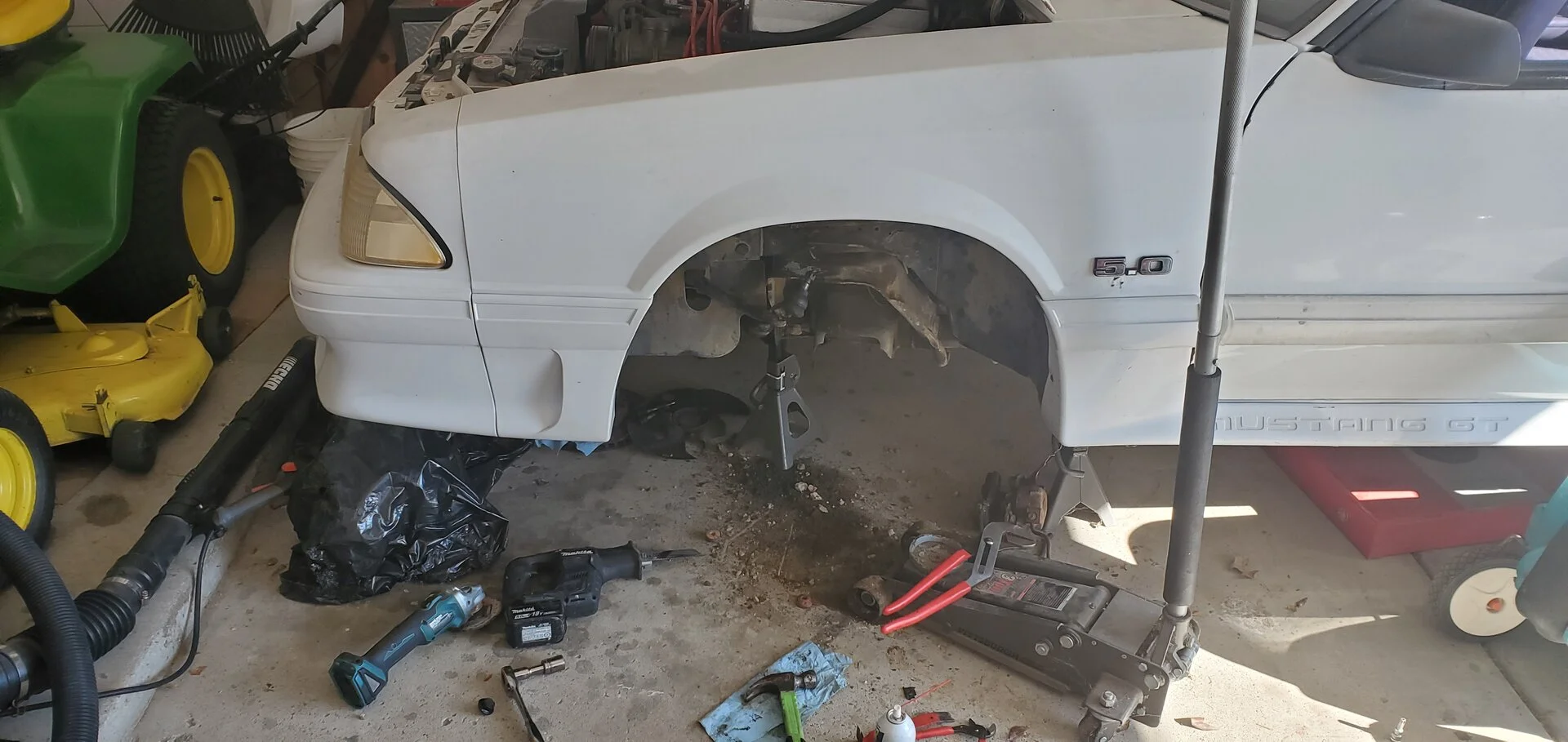

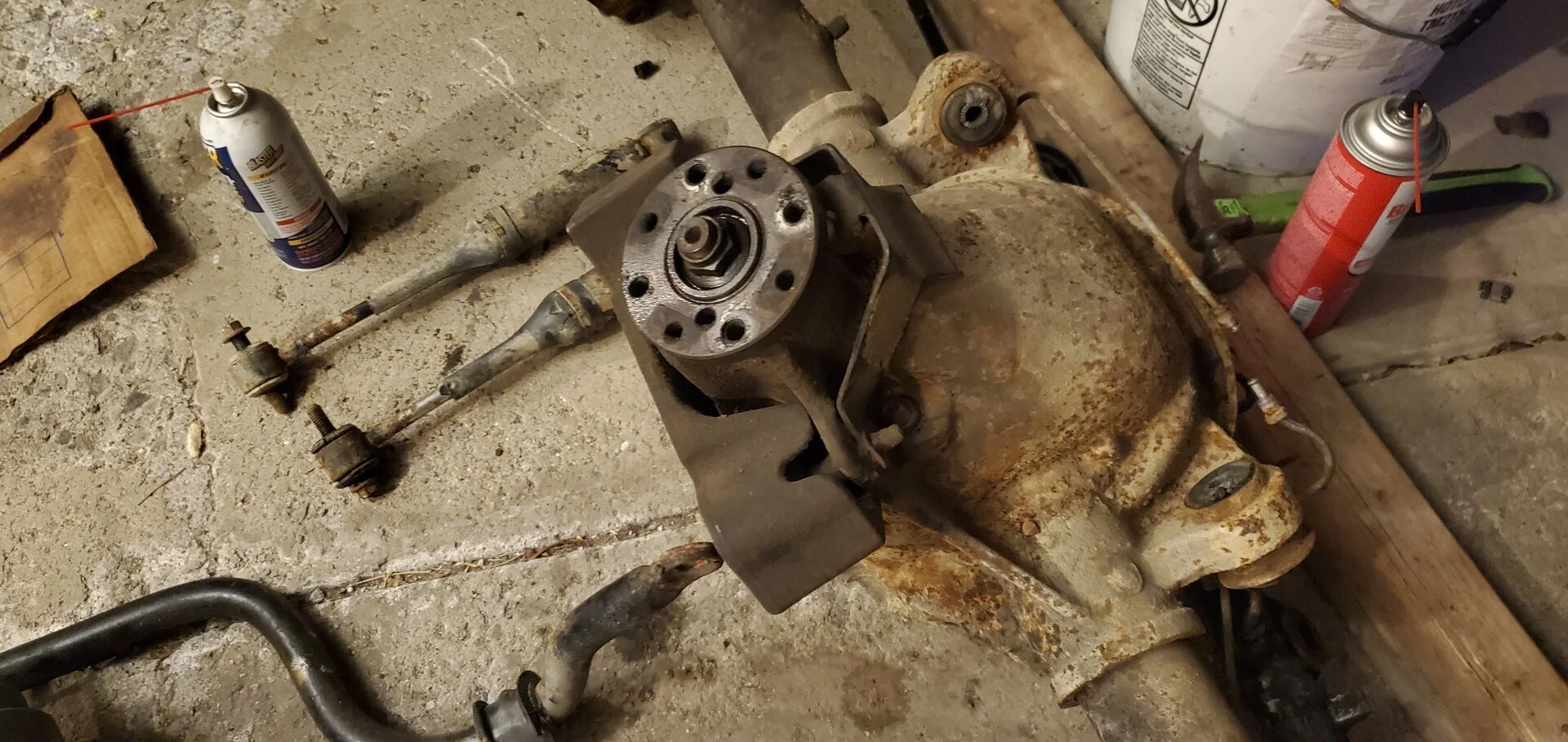

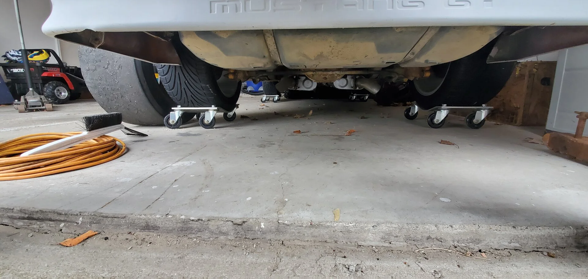

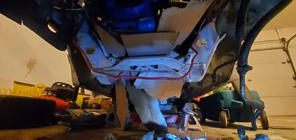

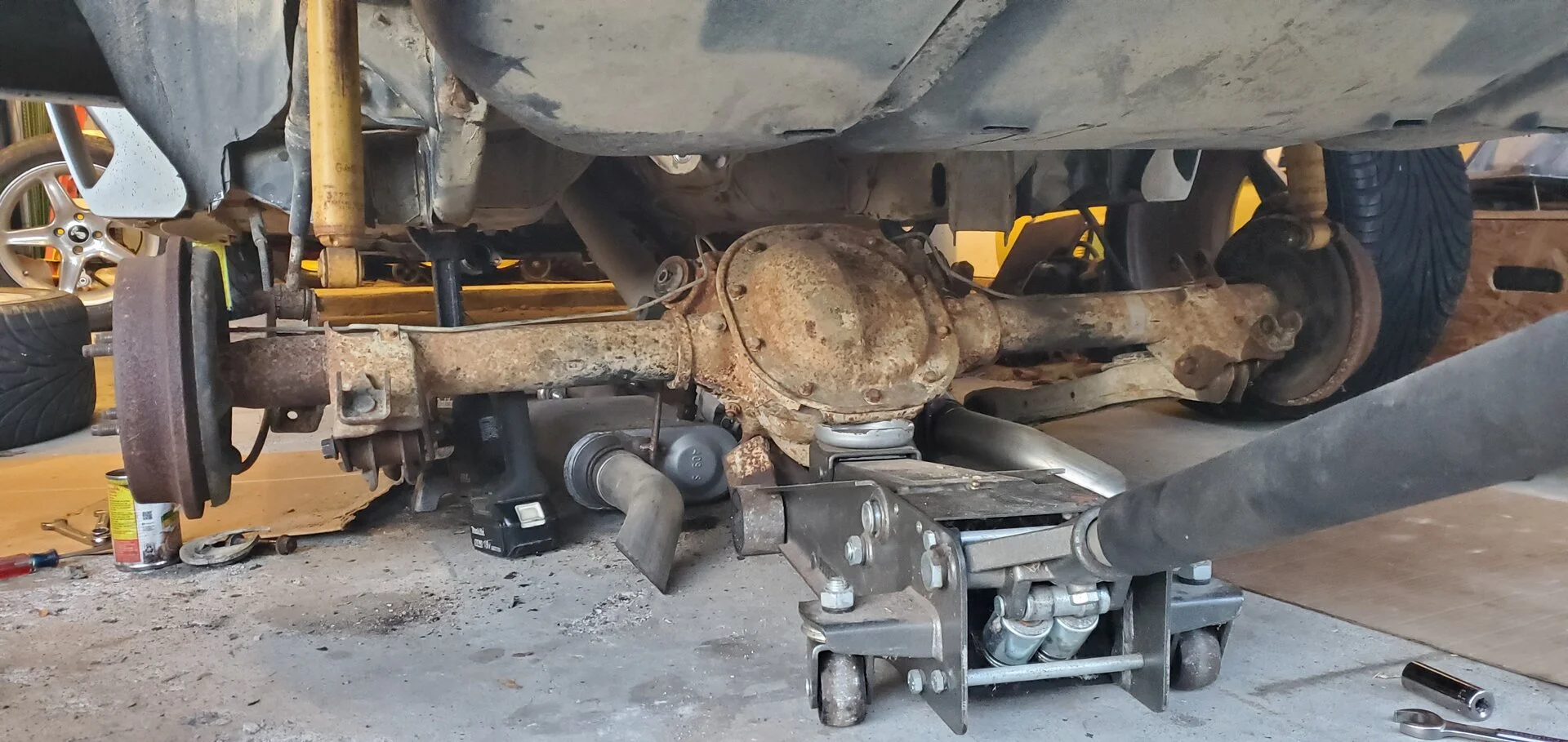

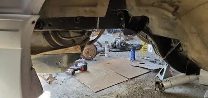

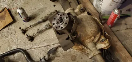

Rear axle removal
(I didn't take enough photos of this stage lol...)

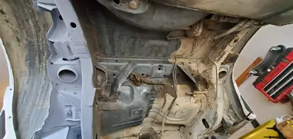

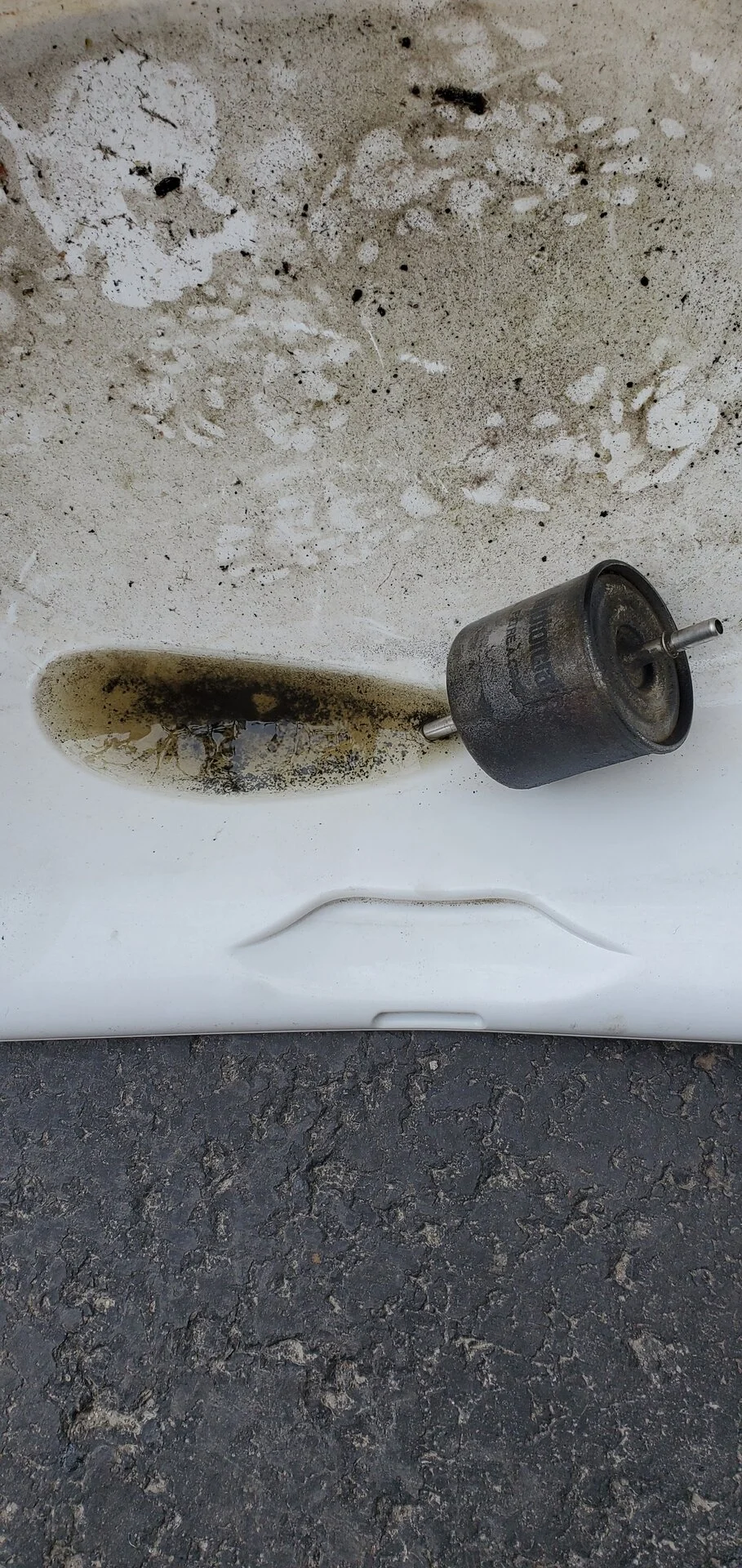

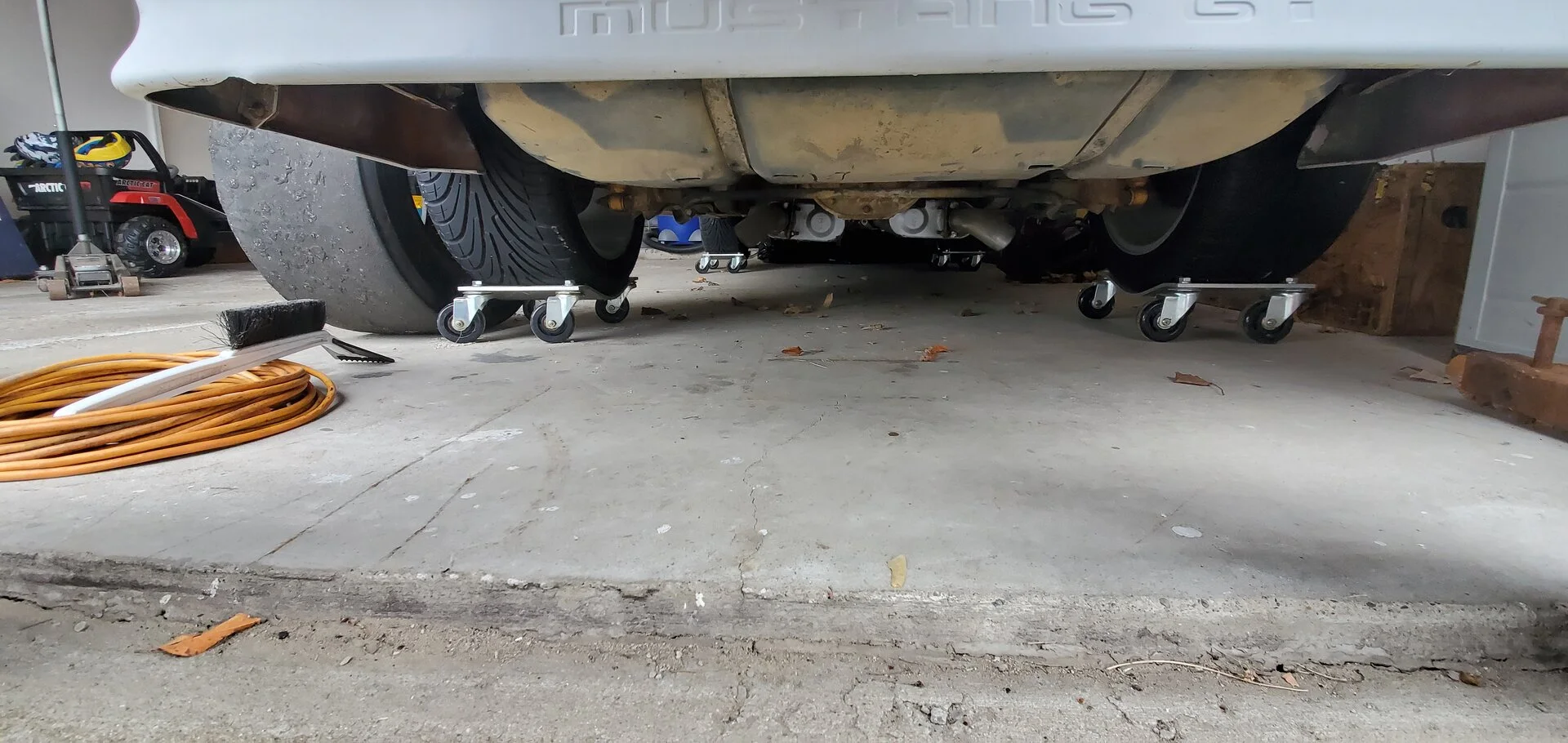

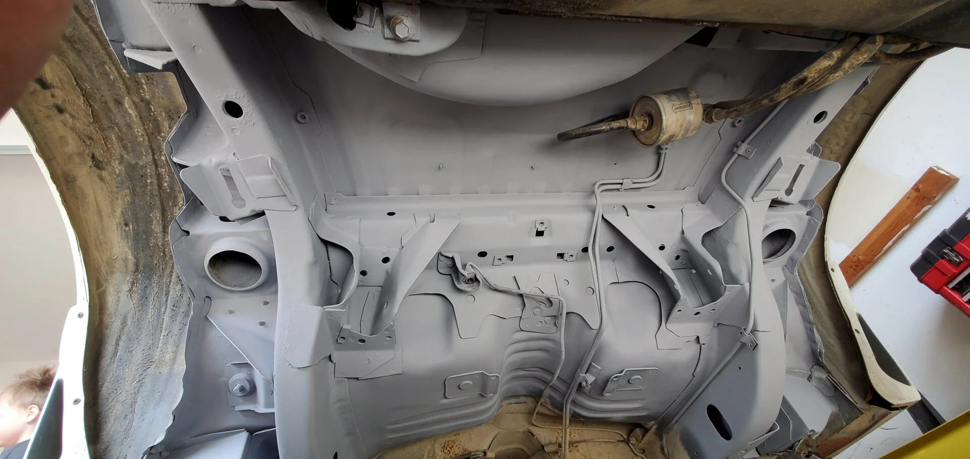

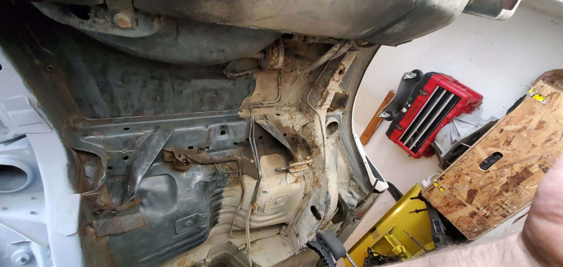

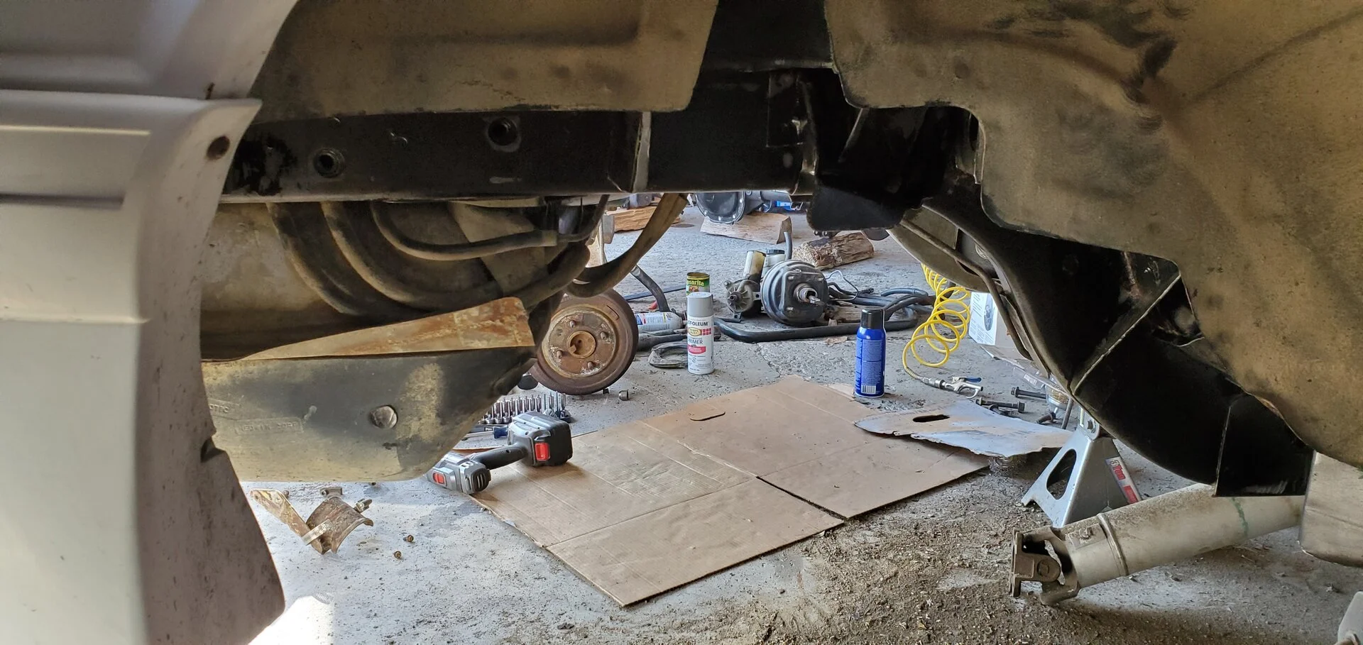

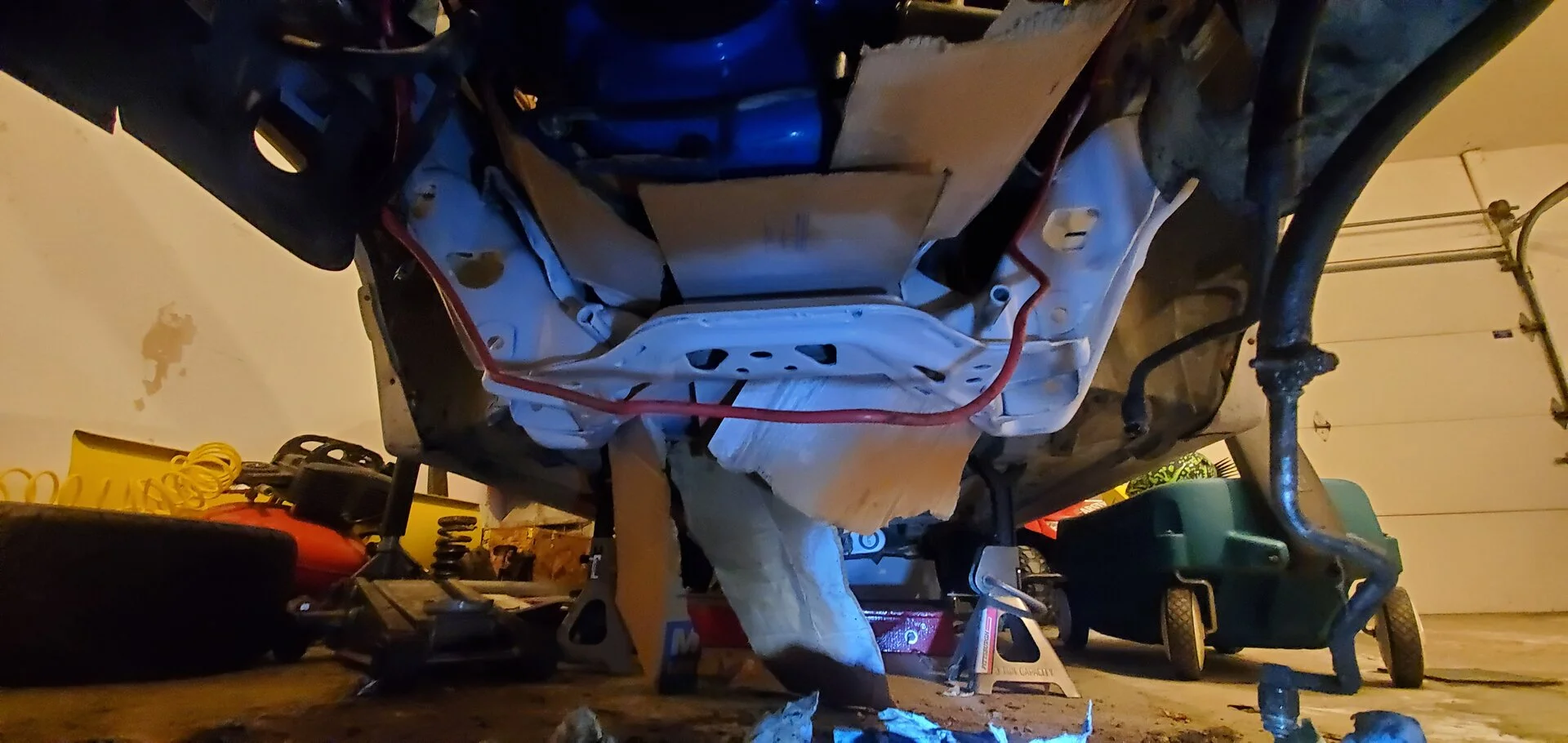

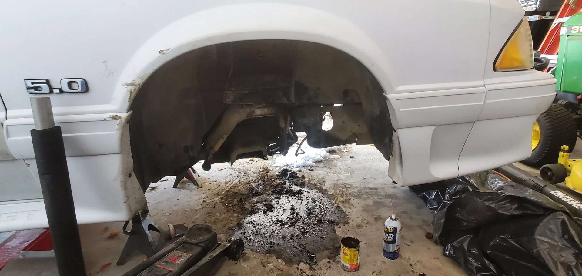

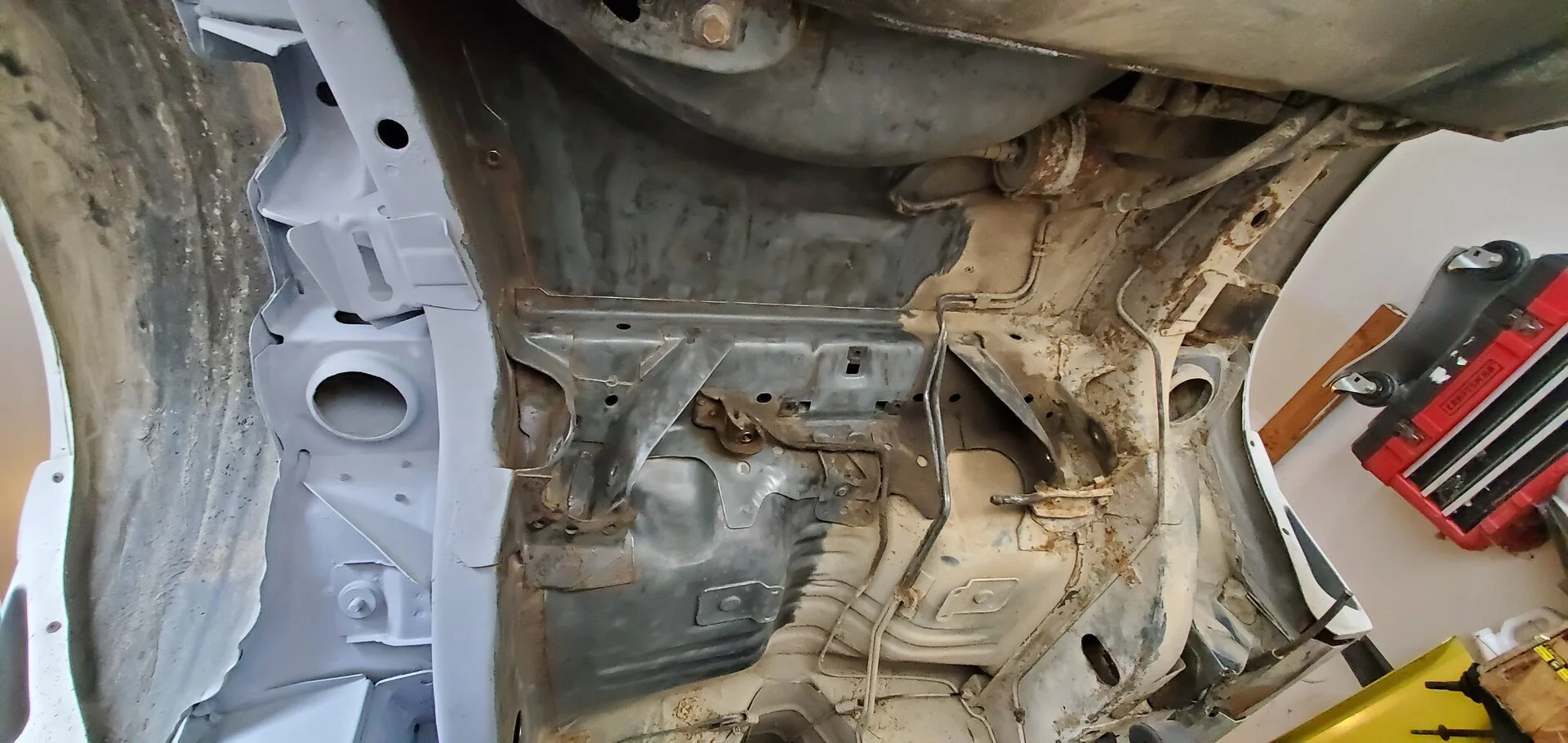

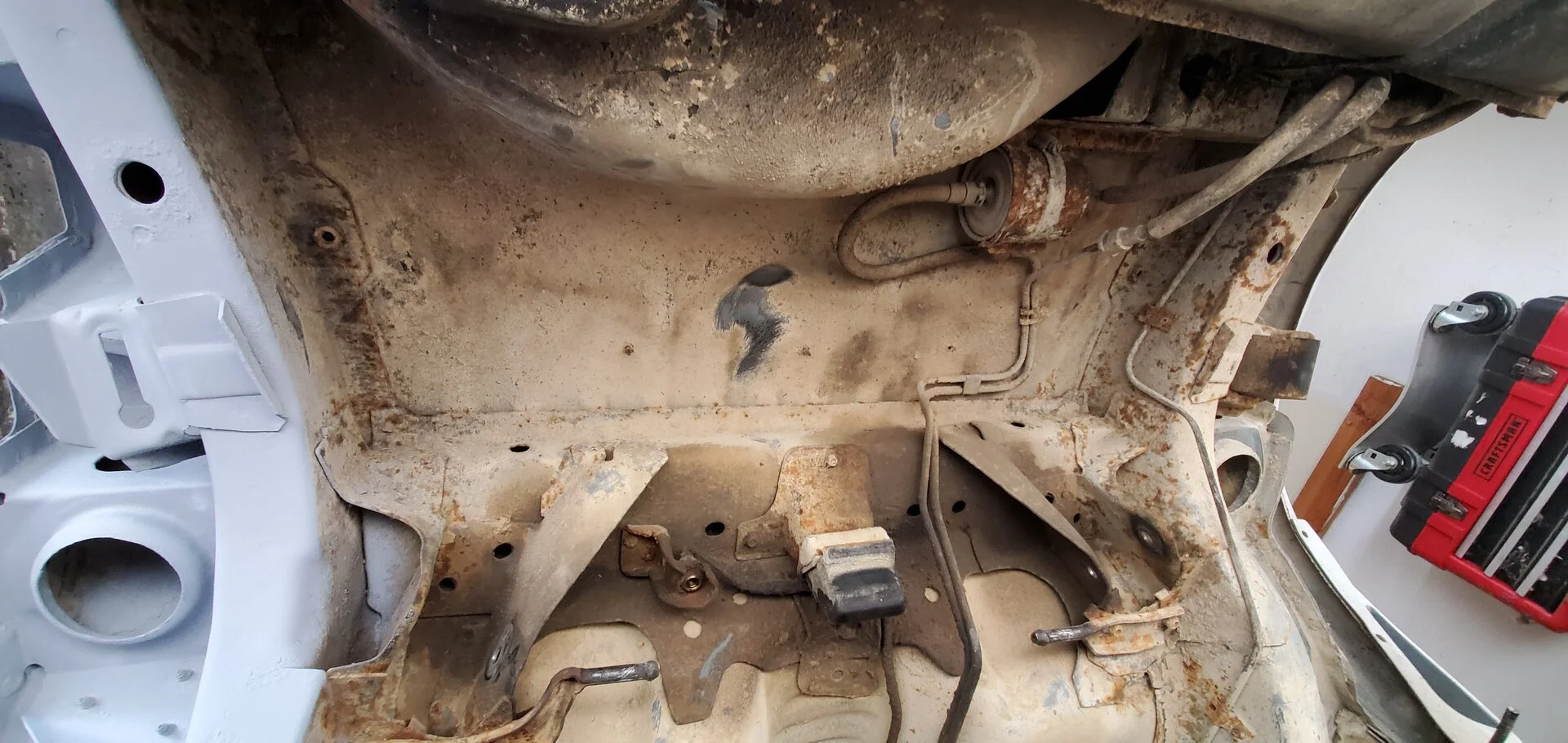

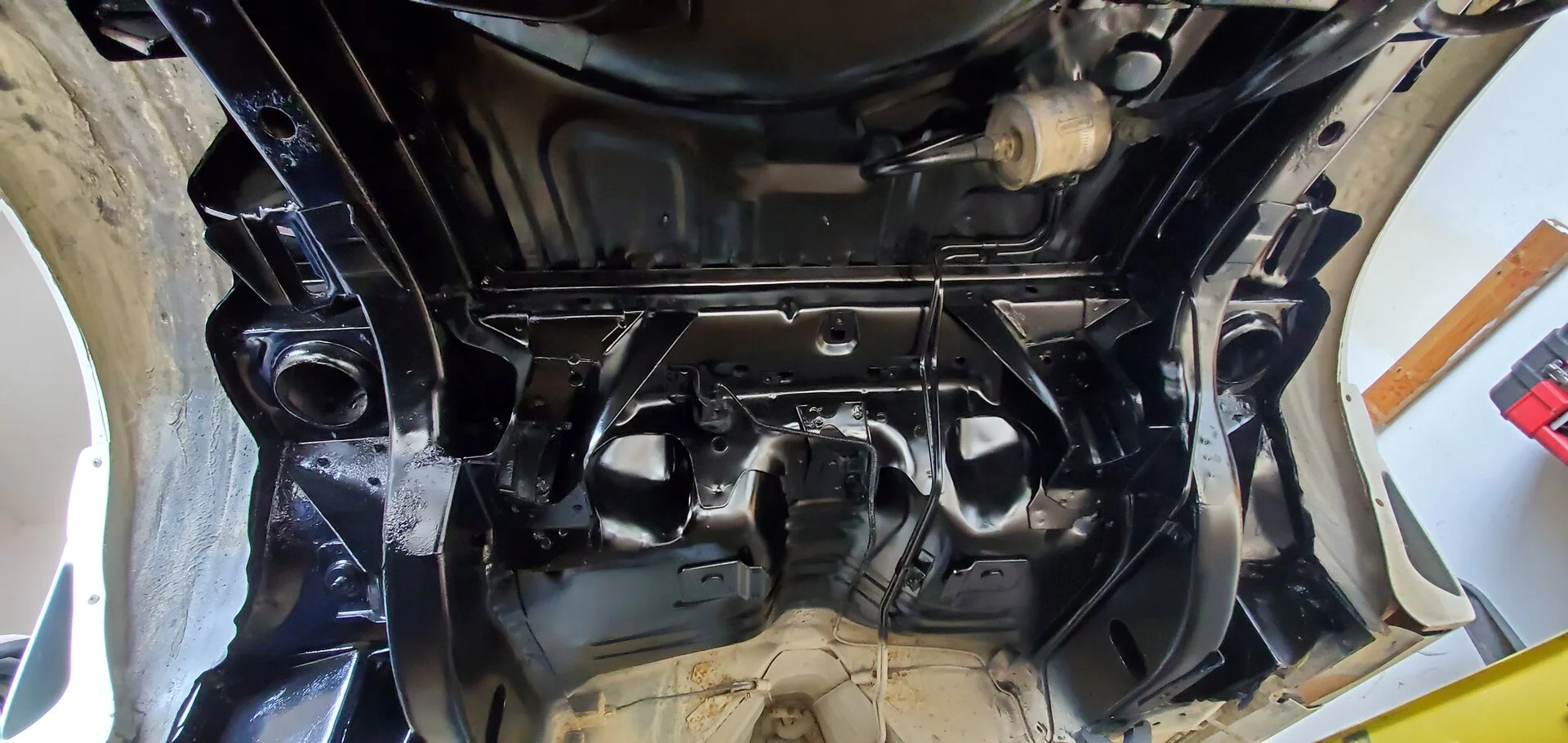

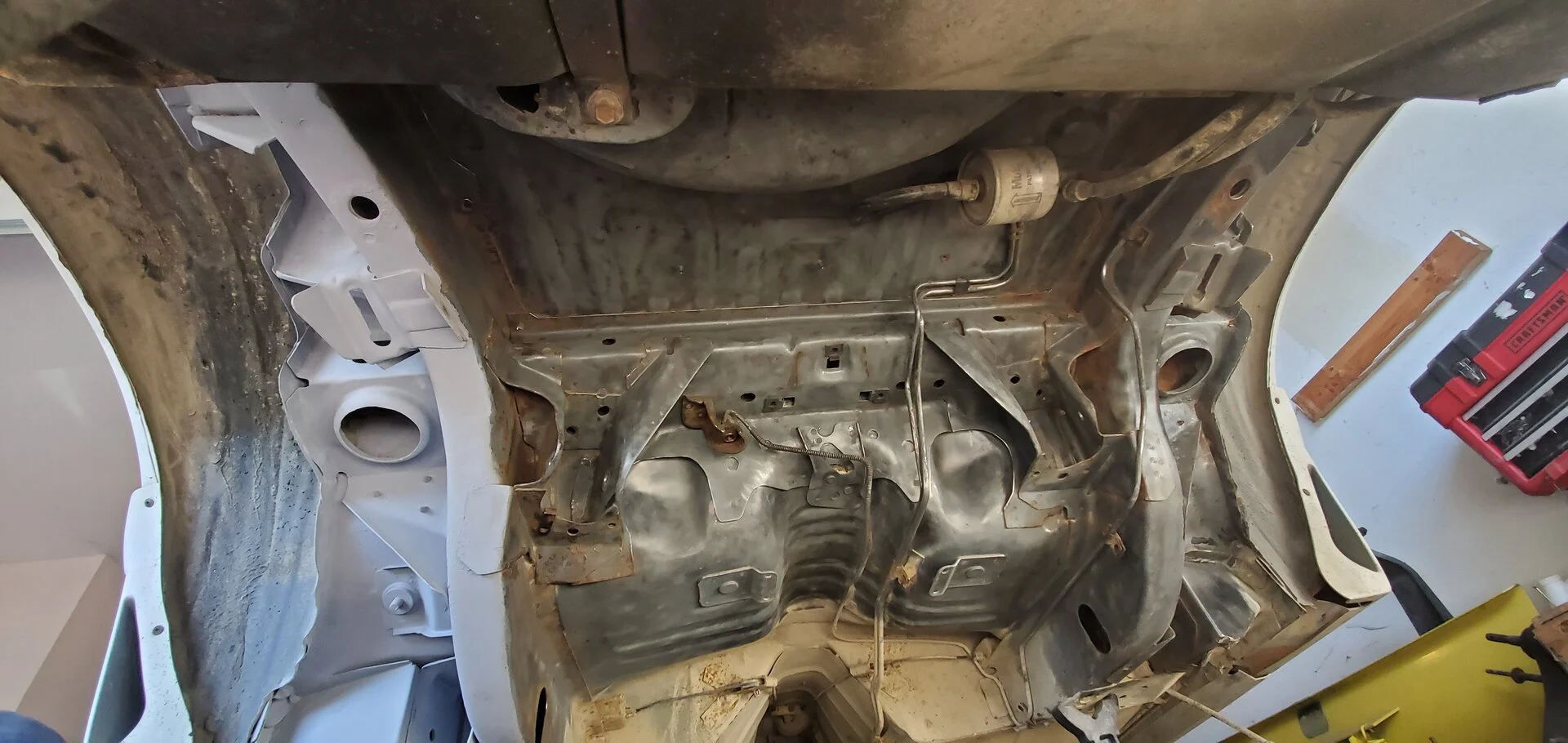

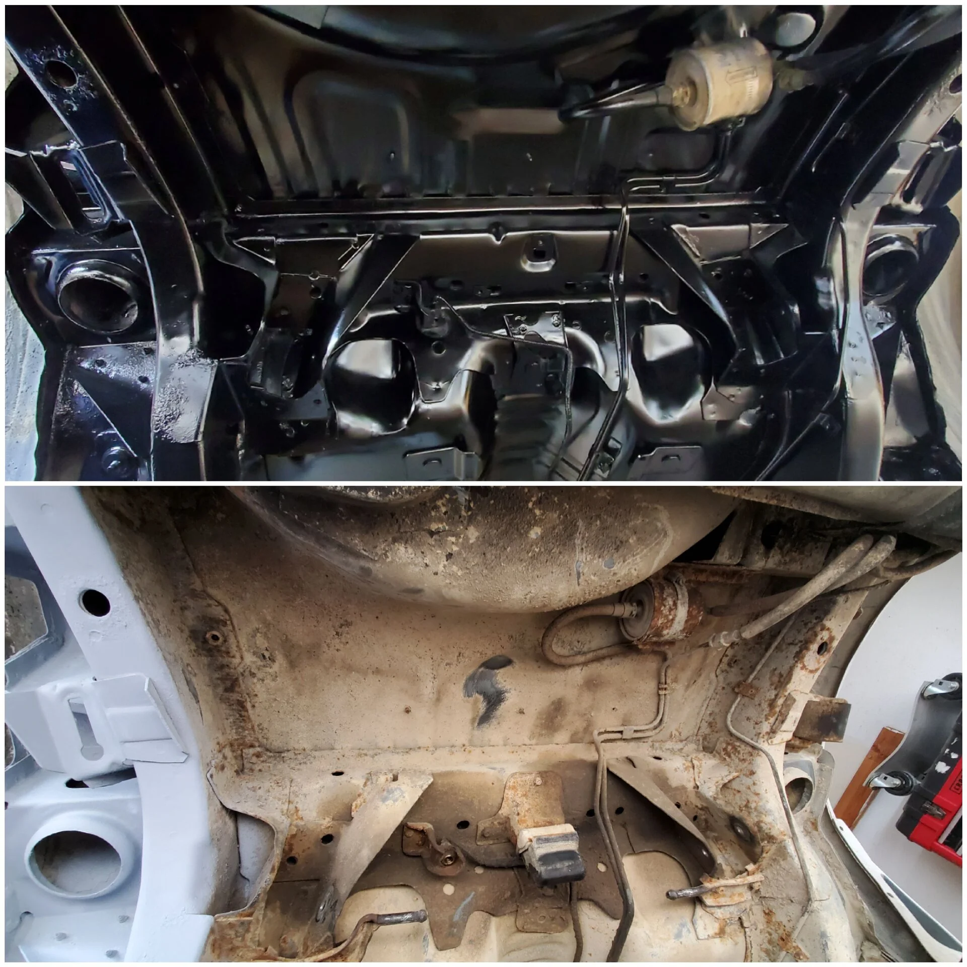

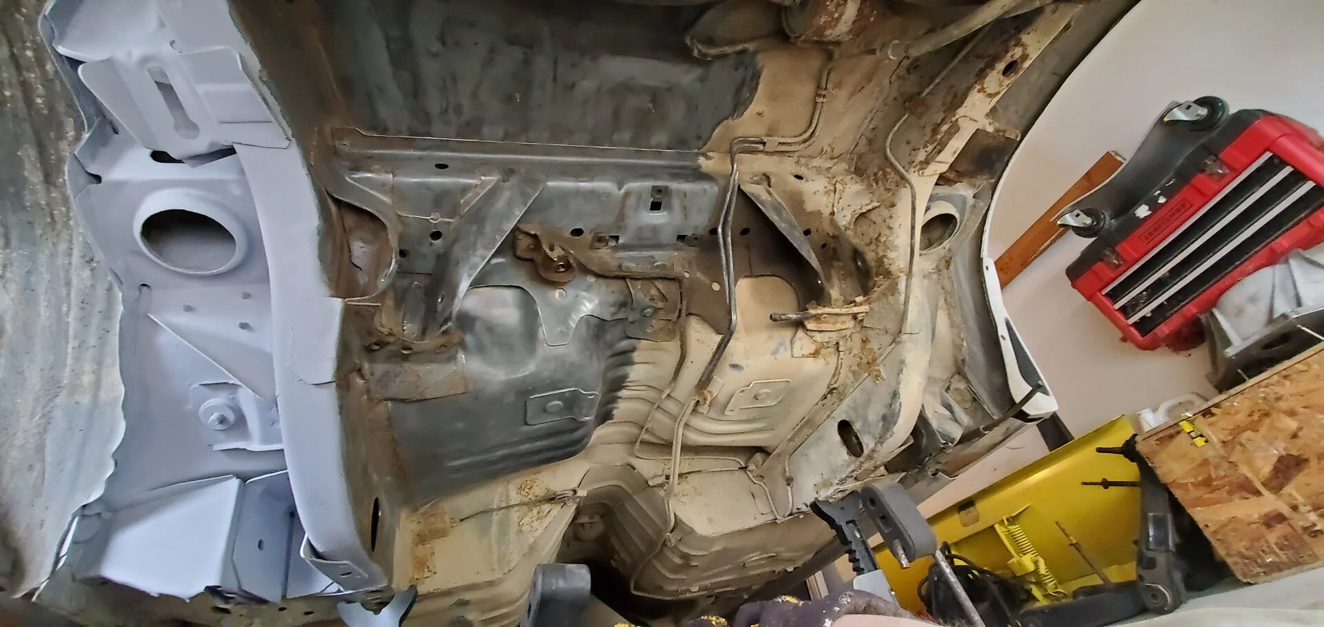

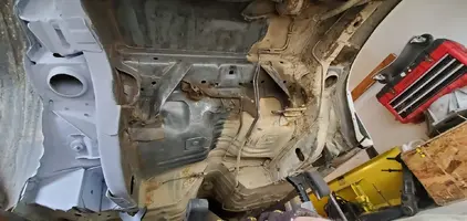

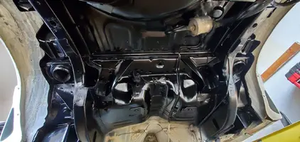

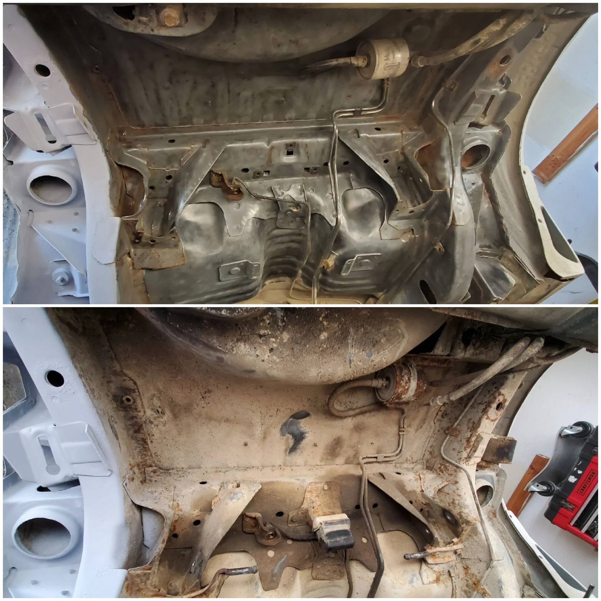

Underbody restoration time (Part 1)...
