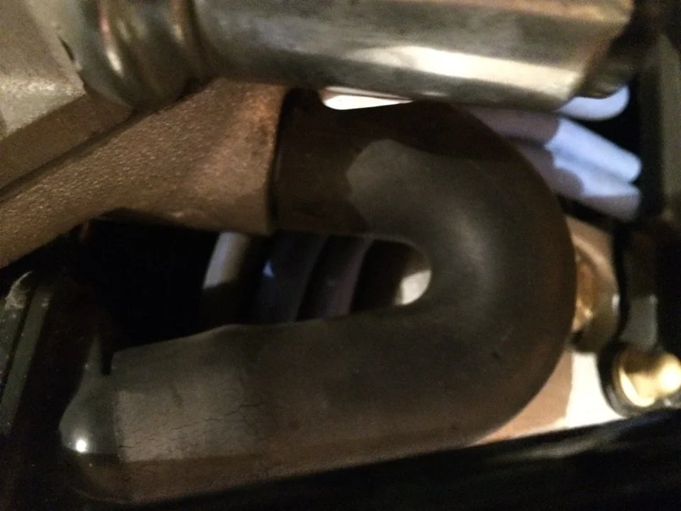

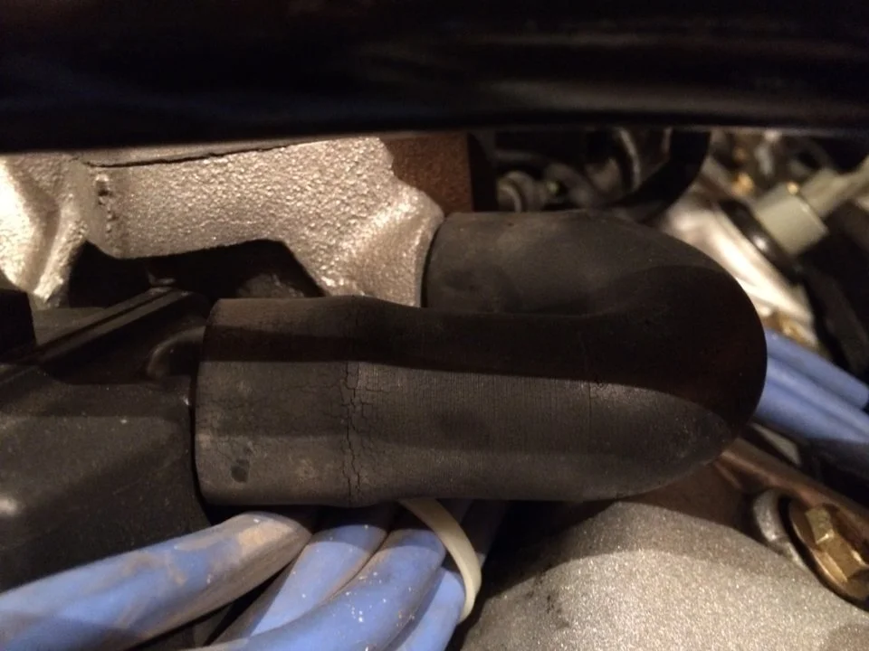

Idk what this part is called, Ik its a vaccum line and elbow but idk the part number, and I went to a local ford dealership parts and I showed the dude the part and he couldn't find it, so, I am asking someone if they can or know how to get the name and part number possibly so I can replace the old line

Ford part number F6ZZ-9H308-BD is what you're looking for, but it's obsolete (discontinued) by Ford. No dealerships or PDCs show to have it in stock, so you're stuck fabricating it out of bulk hose or finding an aftermarket solution (take the hose with you to a parts store and get them to match it up from their pre-molded heater hoses).

Thanks man very very much been looking for that thang sense I had the ducking car man this helped a ton
