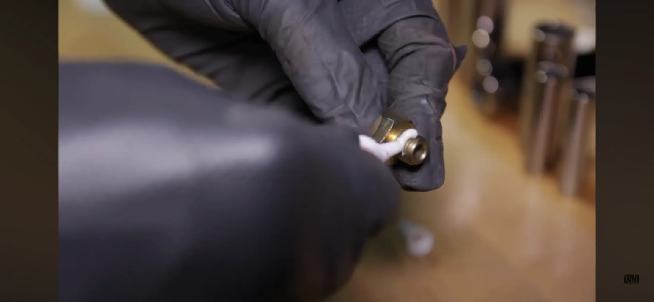

1) Do I use a thread sealer on the passenger side brake line adapter (the Weatherhead 7828)? The old LMR Cobra brake install video shows a sealant, but the part description calls it in inverted flare, and I’ve read you don’t use sealant on inverted flares. Timestamp 16:04

I never have and I have two cars done this way and have helped a few other guys do theirs and never used sealant. Does it hurt? Probably not but flared fittings should not need it like AN fittings do not need it except on the NPT threaded side.
