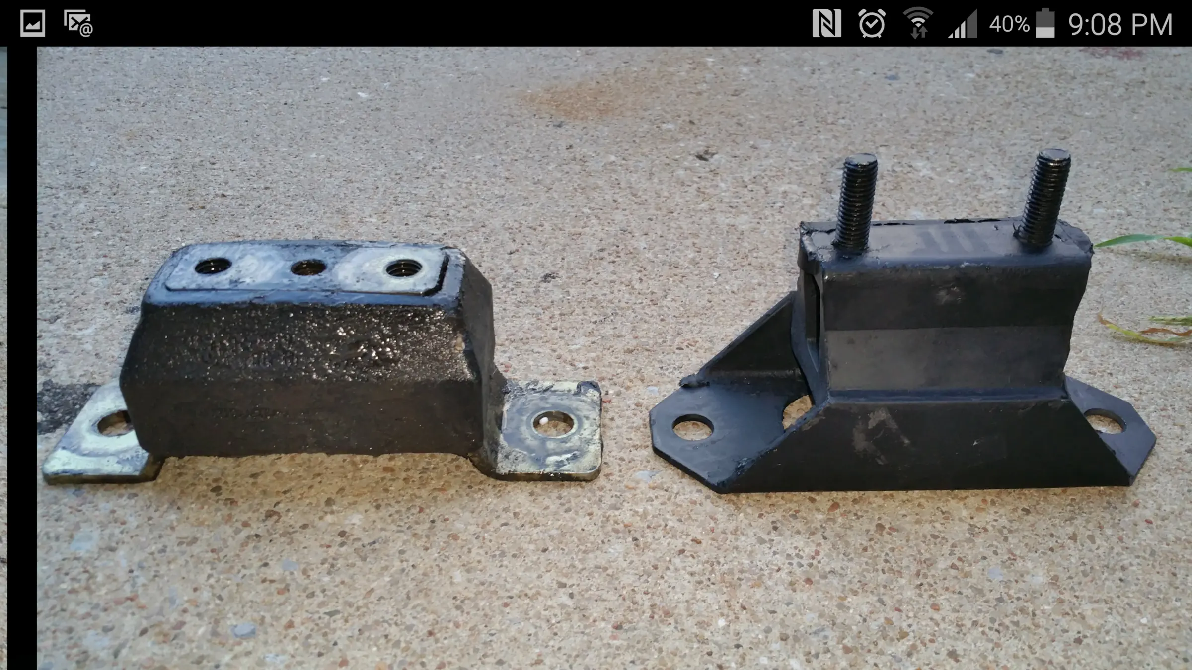

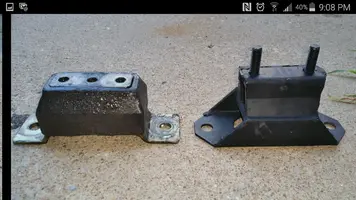

So, I got to pulling everything apart this evening and ran across this bit of a problem... Is there any reason why it went from female to male? Do you think it would be okay to convert?

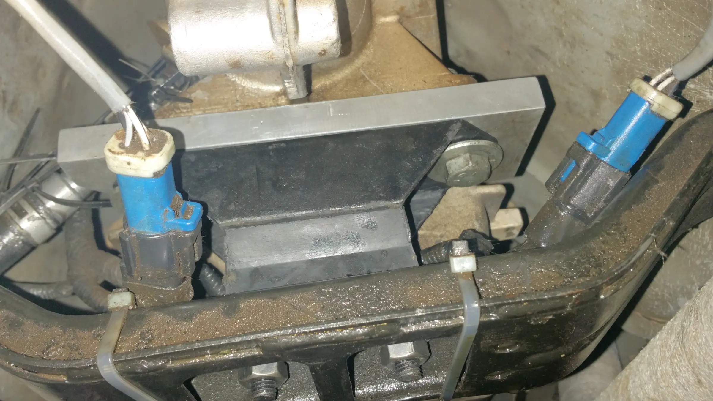

Okay so, I went ahead and converted it to this style since I already had the part and everything is holding just fine. The only problem is that it didn't fix the vibration. Any other ideas?
