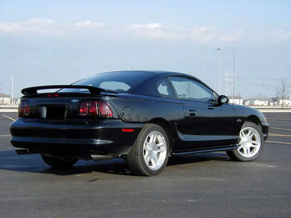

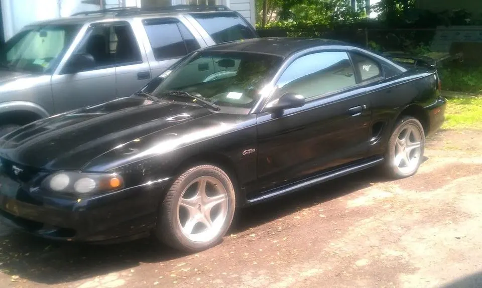

When I bought it (notice the terribly high ride height):

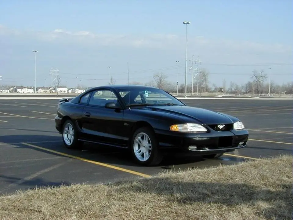

After I lowered it and installed rear wheel spacers:

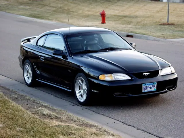

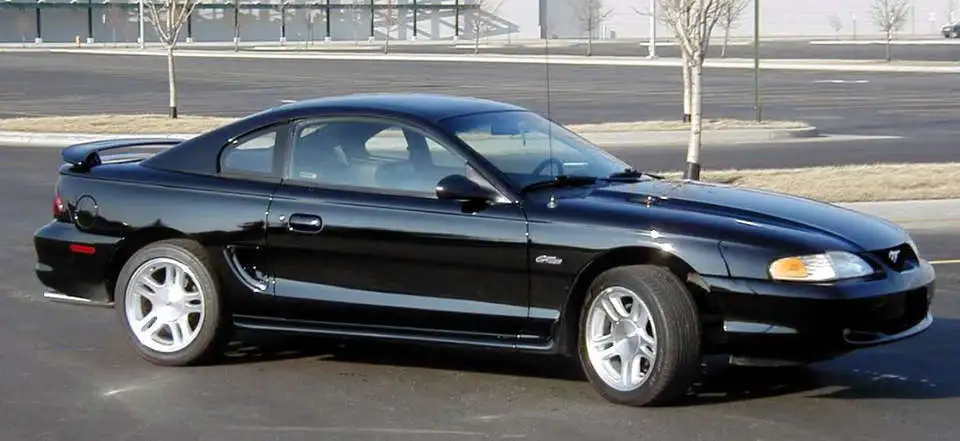

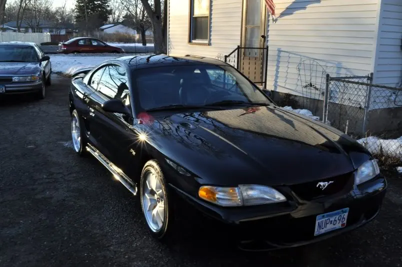

Currently w/ my FR500's:
