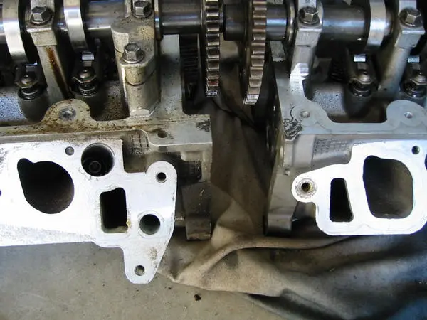

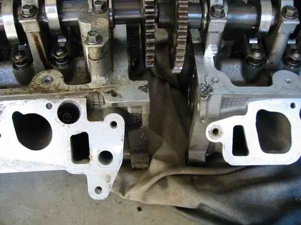

As far as the heads are concerned you need to find the stamping on them to tell for sure if you have PI heads or pull the intake manifold and look at the intake port shape on the heads. Square ports = PI heads, teardrop ports = NPI heads.
NPI on the left, PI on the right
