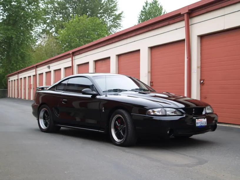

I would start by lowering the car, since it doesn't appear that you have done so already. This is a really bad picture that I cropped out of a much larger image from an event I participated in yesterday. The car on the left is lowered about two inches. The car on the right is stock height.
With 275's, you're still not going to be flush with the fenders unless you have some majorly offset rims. I have 315/35R17's on 17x10.5's. These fill out the wheel well.

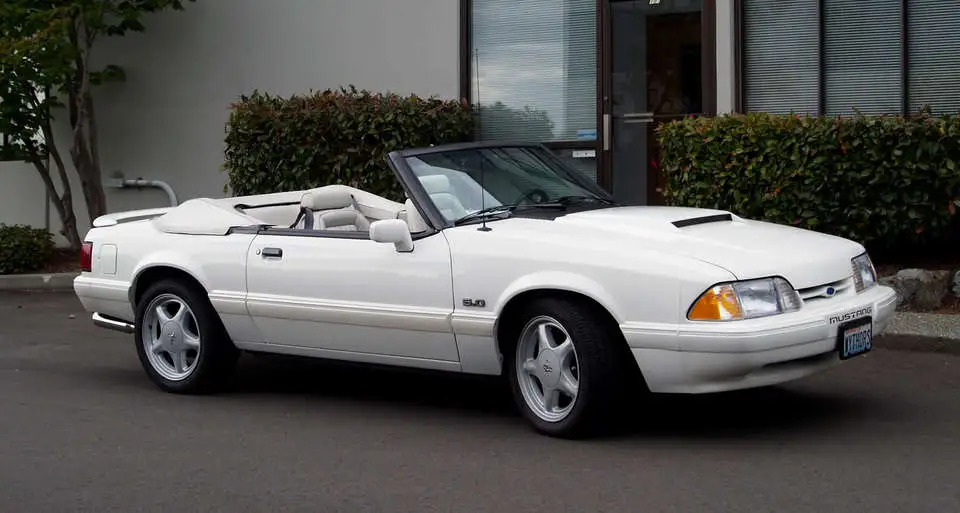

Mine is actually white. Here's the most recent picture I have of it. Not very good, but all I have right now.

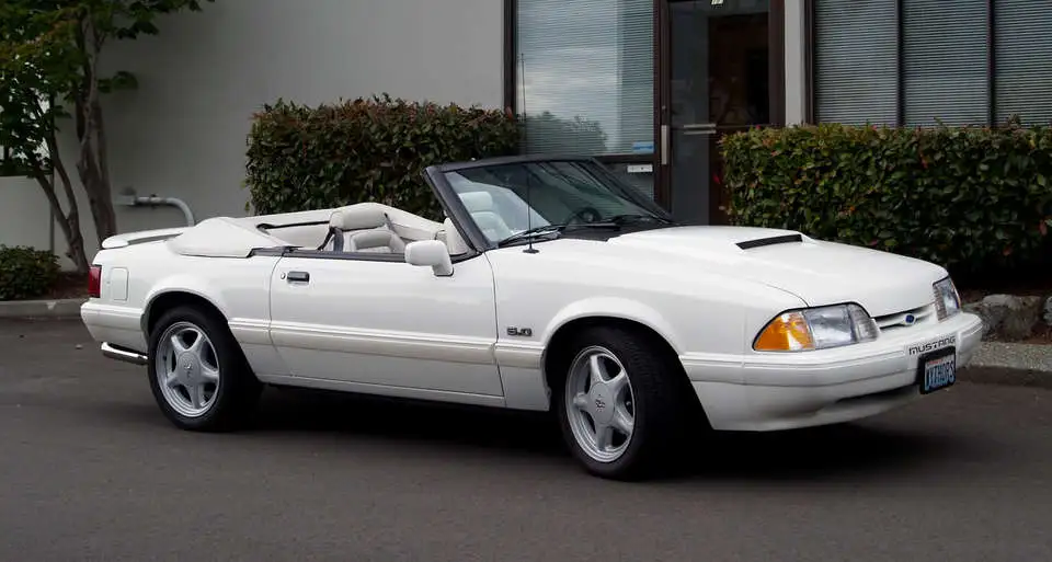

Here's a much better shot before the Air Extractor hood.

wythors said:
Now Chris, I didn't mention you by name. I just used your car as an example. It's not like I did something like this:
Now be nice.... Isnt it about time for you to be workin on that big box o' toys....?
Just as a warning, those 315's are HUGE if you are used to the stock wheel width. They also cost a bit more to replace :nice: Overall a nice upgrade if you plan on adding power down the road and are having issues putting it to the ground.
