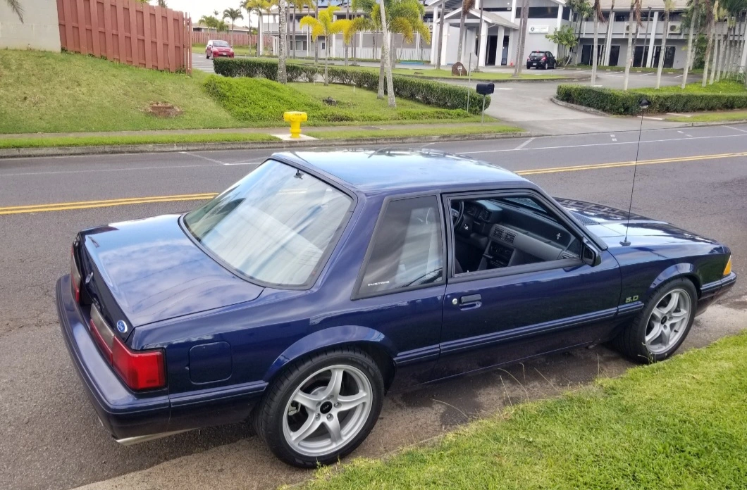

I did get my set of originals cleaned up and mounted new tires. I like them but a 17x9 would allow me to run a 275 in the back. This setup has a 255 in the back.

I think the 17x9 offset would have a little poke on a Fox with SN95 axles. It would be perfect for fox length axles though.

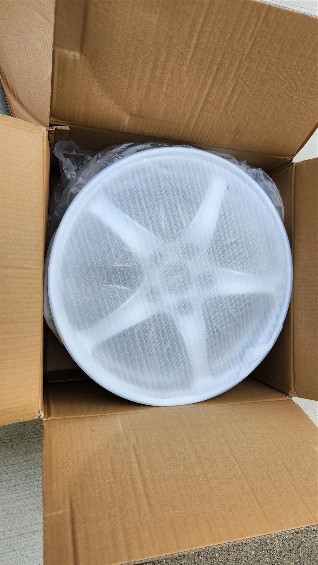

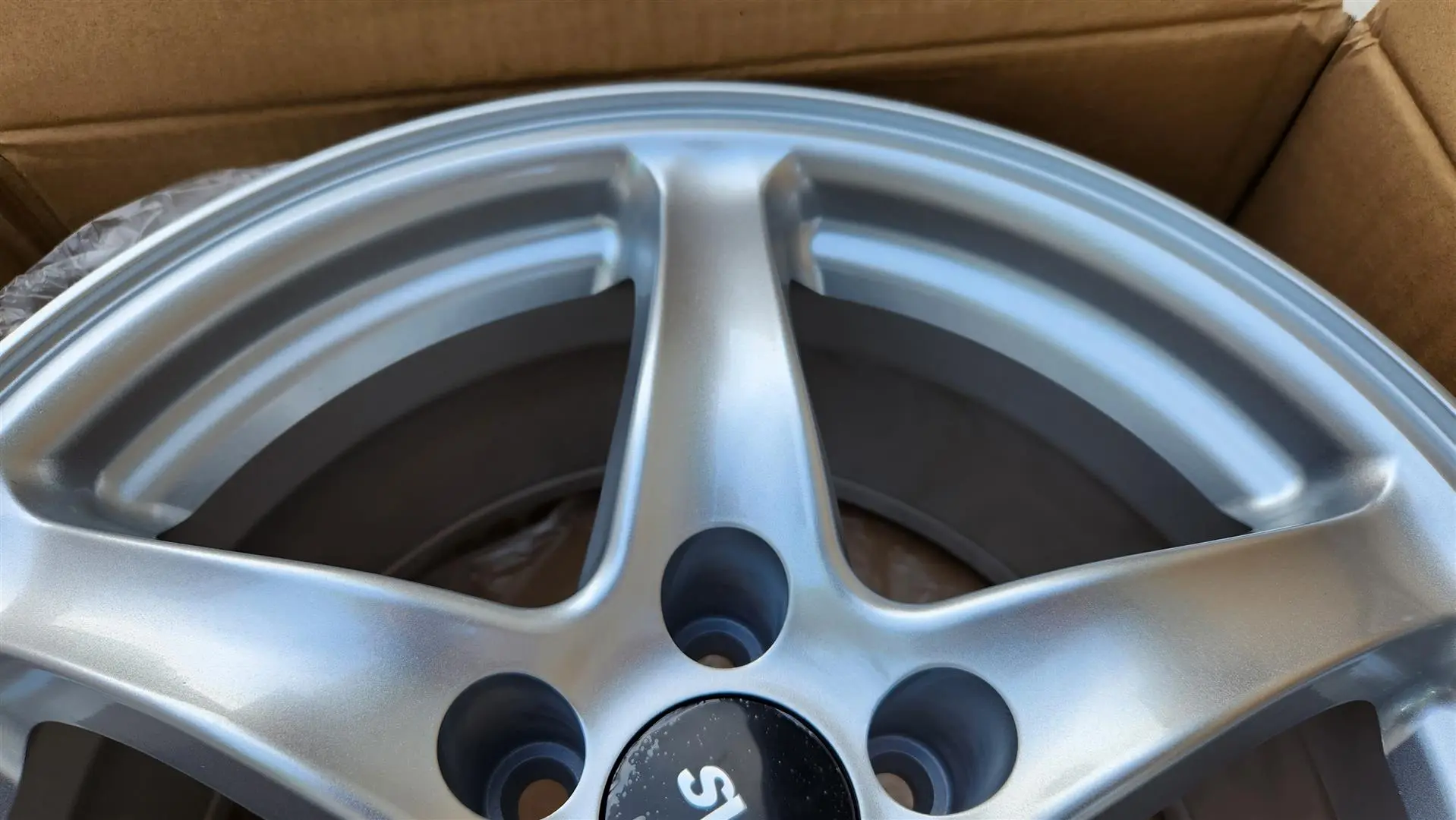

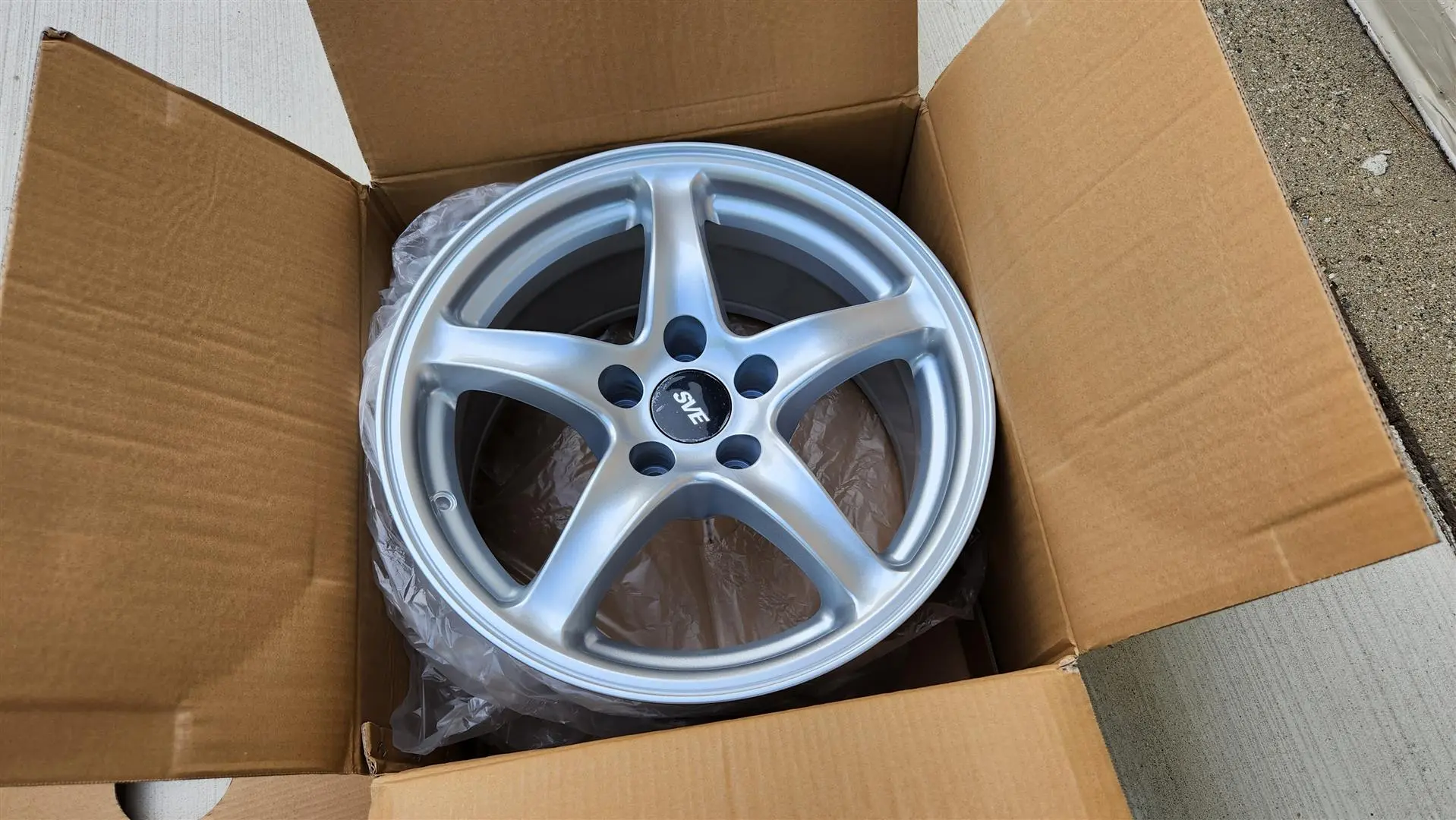

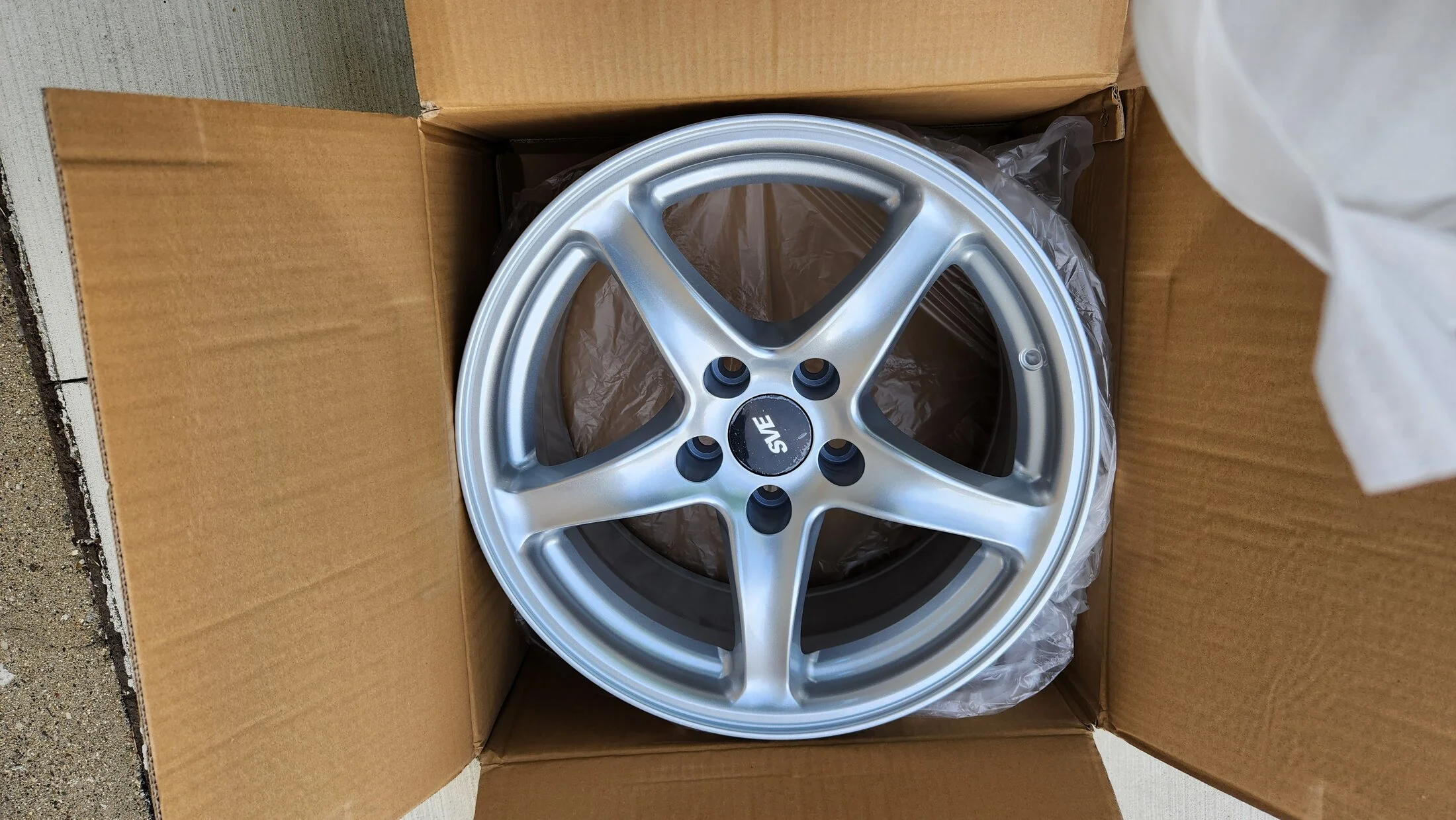

I picked up the LMR 1998 Cobra 17x9s a couple of months ago. I'm very happy with the purchase so far, especially since I've wanted 9"ers for the rear for a long time. Here are my impressions:
  • The shipping / packaging was great. They were better protected than the original FR '98s I ordered from Summit back in 2005. The pair arrived in a giant box that looked like hell (thanks UPS!), but the wheels were all individually boxed inside with no box dents or wheel damage.
  • These reproductions look really good! From what I can tell, the build quality and finish are on par with the originals. I can't comment on the fit since I haven't installed them or had them balanced yet (too busy with work and family stuff).
  • Proportion-wise, they look like a very good match to the originals, even with the expanded width.
  • I'm not much of a paint guy, but the color looks like it's a tad off. It appears to be slightly darker, flatter with more luster and larger metal flake, and a less glossy or thinner clear coat - I hope that makes sense. In all fairness, they do say something about that in the video where they suggest buying a full set for a perfect color match front to rear. I really need to pull one of my original '98s out into the sunlight next to these for a better comparison.
If the color mismatch is really noticeable, I'll probably go to a wheel restoration place (plenty of those around MI due to our potholes) and see if they can re-do the finish to match the originals. I'm not sure where the majority of the cost comes from in re-finishing wheels, if it's from fixing curb rash and dents or the re-painting/coating part, so hopefully it won't be too crazy expensive to just change the color and do more clear coat. If the color is close, I could see if they can add another layer of clear-coat to help match the originals, but I'm not sure if that's even possible with an already coated / painted wheel.
I also have to decide on new tires. I'm not sure how wide I can go with these wheels since they changed the backspacing to fix the rear wheel sucked-in stagger look on the SN95. I would like to go 285s in back to keep the same diameter as the factory width 255s up front, but there aren't many 285/17 options out there in summer performance tires. If it ends up being a 275/245 combo to keep matching diameters, the only benefit could be less tram-liming on the street with the thinner front tires.
I hope this helps anyone else who has been considering these wheels. This seems like a better option and more cost effective than widening a set of original '98s and using wheel spacers, even if some color matching is necessary. Please let me know if you have an thoughts or feedback.
