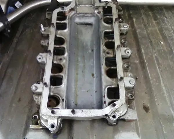

cobra b heads with intake for M90. the intake looks like a modified stock lower. with this lower intake it would be easy to put an 03/04 m112 to make even more power. after saving a grand i am getting the car tuned next week.

im interested in this. do you have any pics of the intake and install. and do you have any info on the setup, something like where can i get one of these lower intakes or what was used to build it and how was it done. it would be nice to find a lower intake, or find out how to make one to fit the stock 96 heads. the 03 cobra swap is a pain so another option would be nice.

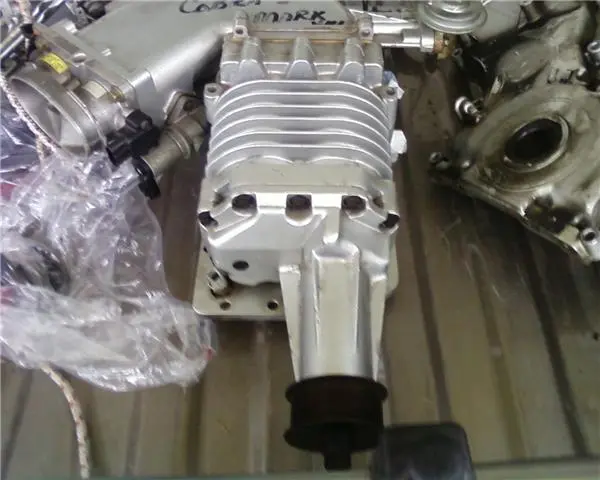

pic of M90 ready to be mounted on the lower intake.
