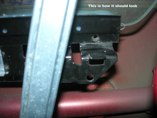

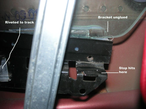

This is what I found as well. The bracket at the back of the door was unglued. There is another bracket above this one that appears to be bolted to the glass. I attached a wire to it and ran it through the hole in the bracket below. I tightened the wire so the bracket stayed in the 'glued' position. I don't know if it will last, but it is working for now.
Sorry, I forgot to take a picture with the wire.
