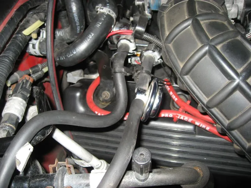

I want to go to a Walbro 255lph High Pressure pump,I have found for kits go up to 1997. Model # GSS340 is the pump to use, is it also direct fit for 98 ?I think I have returnstyle-car build date 08/1997 and model year 1998. This is photo from my car. Is it difficult to change fuel pump basket to make it work with Walbro GSS340?
Yes that looks like what I have (return style). I think they only go to 1997 because some 98's have the returnless style.:shrug: I know 98cobra281 put that pump in his car, maybe he'll chime-in. I also know I'm putting in an external fuel pump in my 1998 but when a get my built block and can up the boost, I'm going with that same Walbro in combination with the external Anderson pusher pump (same as T-rex).
