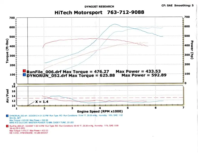

Here's a thread from a local forum I'm on showing the difference between an ON3 turbo kit and a KB. Same car, two different power adders.
http://www.tcstangs.com/forum/showthread.php?119404-Will-it-make-600-today
If you look at the dyno sheets, you'll notice the difference in the torque curve between the two is significant. I know the guy who owns the car and it's a sweet ride. Regardless, seeing the difference in the two dyno graphs should really help you decide what is more important to you. Rush of thrust towards redline (much faster 1/4 mile times and fun to drive in its own way) or rush of thrust right off idle.
Personally, I think I'd prefer the loads of torque and general flat torque curve of a PD blower. However, I do most of my driving on the street and cruising and haven't even been to a race track yet. I realize this really has nothing to do with the topic at hand, but those watching this thread may find this information useful :shrug:
Here's an image of his dyno run... both the 14PSI KB dyno run AND the ON3 turbo dyno run are laid on top of oneanother:
Here's a quote from the owner:
Obviously it doesn't have the instant torque of the KB, but its worth the wait. Its way faster on the road than the KB was. Doesn't feel very fast to me still but meh.
