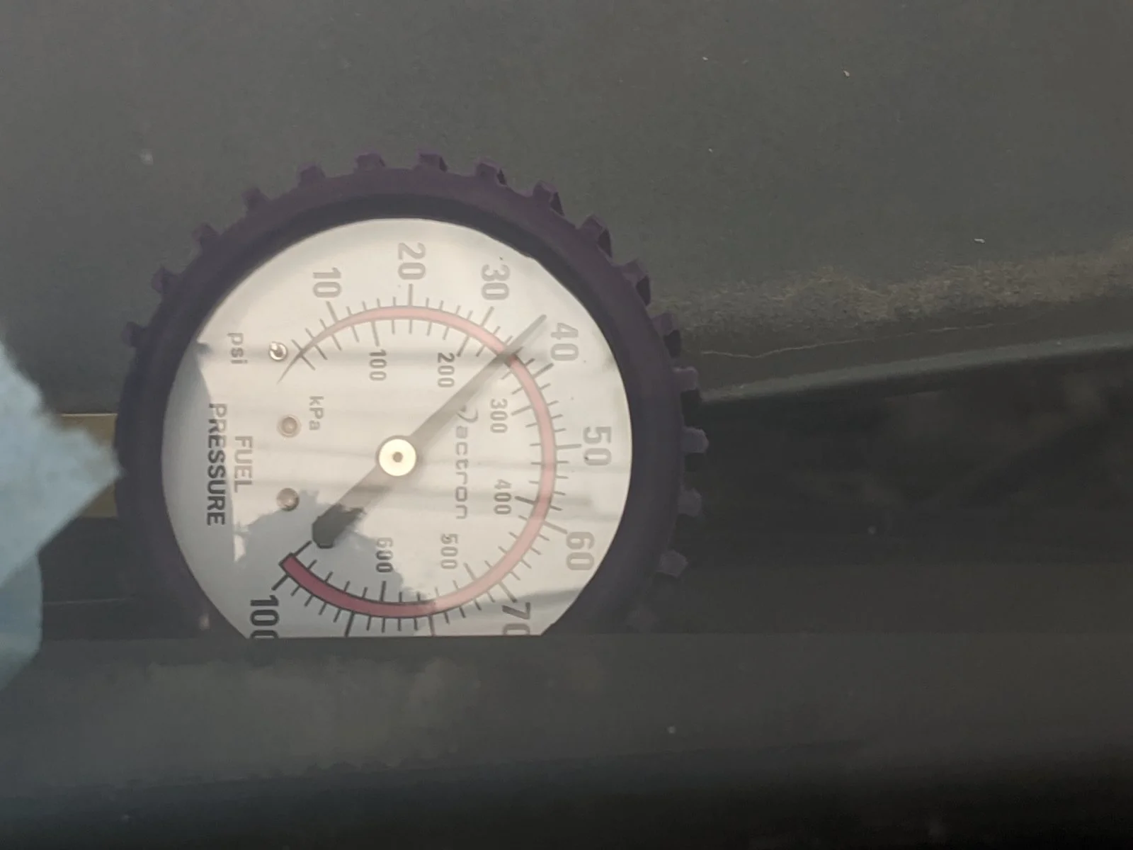

So I finally got this all sorted. I took a fuel pressure test and with the help of wmburns the fuel pressure was higher than it should be. I took the fuel injectors out and took them to a local mechanic shop to clean up. They found that 3 of the fuel injectors were shot they cleaned the ones that were still good. I replaced the 3 bad injectors and reinstalled and the mustang now lives and breathes.
The idle is consistent and strong, and I was able to drive it for the first time longer than about 10 ft.
Thank you again wmburns for your assistance.
Picture of the fuel line pressure just for reference.
