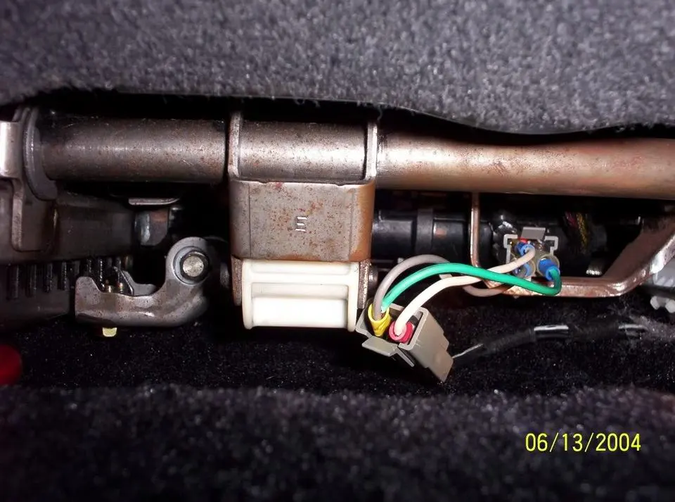

99-04 seats in a 1992 Notchback
here is the wiring
Are you asking about the fronts only or the backs also? Like was said, the fronts will bolt right in with the 99-04 seat tracks, but you will sit up a bit higher. The driver's side tracks are different on the 99-04 and the older models, so some fabricating is required to use the older tracks if you try that idea. I made some measurements and posted them in another thread on here or Corral, but I don't know exactly where it is. The rears will fit, but you will have gaps on the sides. I have some pics if you want to see. I have pics of my seats in my lx hatch in My Garage.
