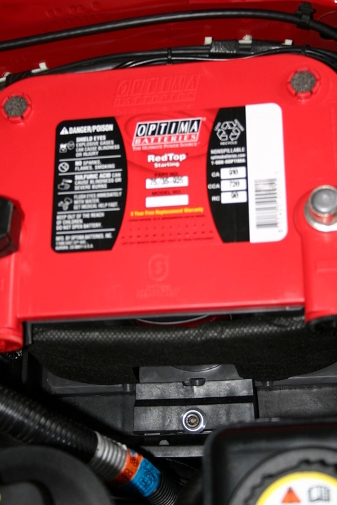

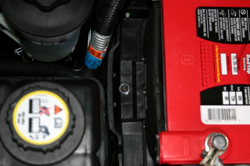

Here's the pics of the mounting bracket, notice how the tray is larger in width and I used the factory mounting bracket, layed it down and drilled a new hole for the mounting bolt.

Do what I did, take your battery tray in to the store with you and test fit the Optima batteries until you get a good fit. There are only 3 bolts holding the battery tray... I got the smaller Optima with a special hold down, it fits perfect with no modifications.
