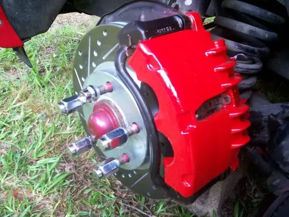

i was in the same situation. my buddy put bullitt brake package on his 2000gt and gave me his old stuff. i put the PBR calipers on, slotted rotors, hawk pads, and SS front lines and noticed a huge difference. i think that the swap was def. worth it. and IMO they look a lot better since they fill out the wheel a little more. if you decide to do the swap here is a link that i found very helpful. http://www.svo73mm.cjb.net/
and here is a pic of them. i also here that the pbr's polish up real nice.

it was worth it to me....

Those PBR's stop really nice...I swapped those onto my notchback. They stop great, and they do clear 16 inch wheels.

I did the swap when buddy went to Baer brakes on his 2000gt. I gave him like 100$ for the take offs to be fair. I got some autozone/advanced pads (I would like to try some EBC/Hawk pads later) and some red paint. I cleaned up the calipers with a wire wheel and painted them. Other than the new bolts I had to get as I lost the stock ones I prob. had 150 or so total.
I did take my time when I was grinding on the spindle as some room needs to be made. I probably test fitted the caliper dozens of times checking clearance.
I can tell the diff. over the stock brakes. For the cost I dont really see how you could go too wrong.
