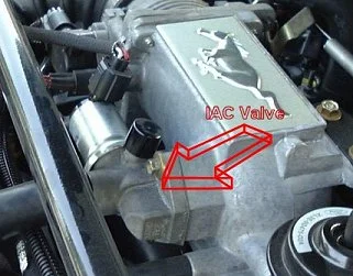

They are about 40 buck at the dealer but most parts stores have them too. You can try cleaning it with some carb cleaner but that is a temp fix at best.
Fuel Filter is located right infront of the gas tank. Its an easy change. You should have been changing it AT LEAST evry 30,000 miles. I change mine every other oil change. From the sound of it, it could be a number of things. 1. most common on fords is the Air Idle Control (IAC) valve. 2. EGR Valve, 3. Throttle position sensor, 4. Vacuum Leak. Try cleaning the IAC Valve and EGR valve with carb cleaner. un plug the plug on the Throttle Position sensor and see if the car will idle. DO NOT DRIVE IT with the TPS unpluged though. If the car idles normal with the TPS disconnected, then thats the problem. I had the same problem on my 01 GT. Took me a few days to figure out the TPS was the problem. My car wouldn't idle, changed the IAC, no joy. Cleaned the EGR, no Joy. I was about to take it to the dealer because I was getting pissed. I unpluged the TPS for the hell of it and BAM!! Nice smooth idle. Changed the TPS and never had a problem after. Like I said, this is just a suggestion. It very well may be your IAC, but it that doesn't work then you have other ideas. It's much easier to unplug the TPS and see what happens before you have to blow $40 on an IAC. Good luck!!

joshheat25 said:
I am also having problems with my stangs idle I was wondering where I could get a diagram of all these parts you are talking about just like this diagram.
If you look at the pic I attached above you can see the TPS in the upper left just behind the strut tower brace. The EGR is in the lower right. You can see about 1/4 of it. It is the disc shaped part.

which one is the TPS? I'm going to try and disconnect it... i don't know which one for sure it is from that picture... anyway you can circle it?
