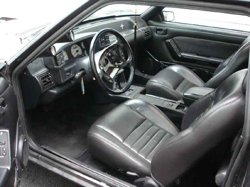

btw Mustang5L5 those seats look pretty good in your car

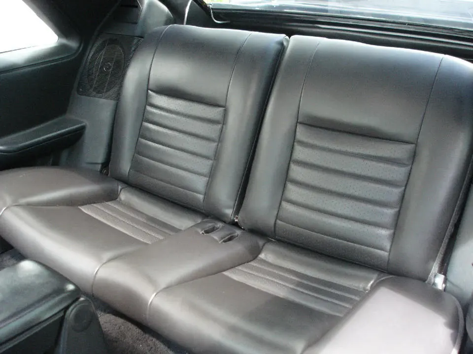

The fronts bolt right in. The rears are narrower in a coupe but I think in a hatch they would fit good. I put seats from a Mach in mine and they are comfy. Machs, Bullitts, or Cobra seats would be the only ones I'd use though since they have the side supports.
They bolt right in. They sit up higher. I had them in Hack Job, but didn't notice they sat higher, because I also had the 99+ titlt steering column in there.
I remember you putting the newer interior in Hack Job however I've installed the rear seats out of a Mach and they are quite a bit narrower in my 92 coupe. How did you overcome this problem?
I used the bottom of the back seat from the 99-04 Mustang.
I had the stock notchback backrest recovered in 2001 GT vinal and pattern to match. Leather was a rip off and NO Mustang came with leather back seats from 99-04 anywyas. The last year for leather rear seats was 1998.
94-98 rear seats a MUCH nicer.
Even the Cobra's and Machs? I might have an upholstry shop try to use some of the material from the back so I can keep the same look. The machs have the ribbed center and I'd like it to match the fronts.
