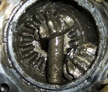

It is actually the spline count on the bevelled spider gears inside the carrier that have to match the axle shafts.
In this picture you can see the gear with the splines behind the broken cross shaft. I pulled all the guts out and replaced them with a 28 spline mini-spool and made a new cross shaft. A 31 spline would surely have fit right in if I had the matching axles.
