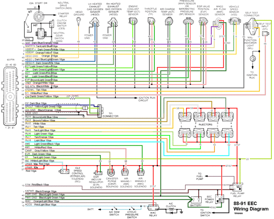

See the following website for some help from Tmoss (diagram designer) &
Stang&2Birds (website host) for help
Using the above diagram, check the resistance between the injector and the
computer. Clean and check the 10 pin connectors since they are a potential
trouble source. Any resistance greater than 1 ohm between the injector to
computer wire and the matching pin on the computer connector is a problem.
See http://fordfuelinjection.com/?p=6 for more help
