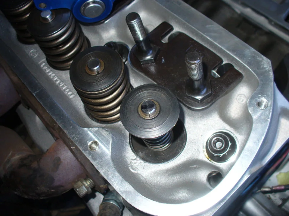

I will not recommend Trick Flow heads. I bought a pair several years ago, before I knew as much, as I know now. (Obviously)
In 2005, I got a pair that are good for the shorter lift cam:
http://www.summitracing.com/parts/tfs-51400002-m61/all
In 2012, I finally got around to getting the engine built and while the heads were at the machine shop, I learned that one of my heads came from the factory with a bent valve. So, even though the heads were still new in the box, the 90 day warranty was not honored. I guess I shouldn't be surprised at that. However. Trick Flow heads require a longer than stock push rod. This is nothing new if you are using performance camshaft. They don't tell you that, when they advertise "bolt on performance".
Also, they use a different shape for a guide plate, so if you need a new one, it has to be one of theirs.
The other aftermarket heads use all standard parts. ( To the best of my knowledge).
Purely for the sake of convenience, I would now rather have spent my money on an Edelbrock, or AFR head. Just less BS, for the cost....The hundred or so dollars, would have been money ahead for me today.
