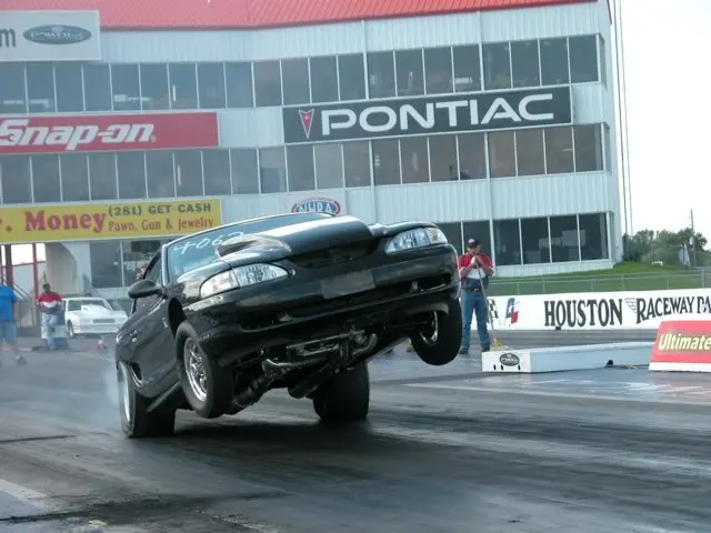

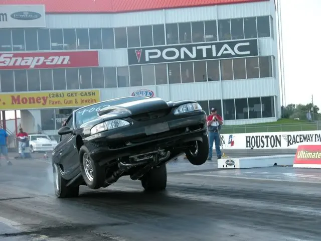

I know it has the wrong tails but I'm going by the side skirts. Anyways I think he's making a little power under the hood, but I may be mistaken. :nice:

It only jacks the front end up if you have to get out of it, and it slams back down. If you can keep your foot in it, everything is fine. As for that first pic. That car is all twisted up. I used to know a guy that had a Maverick with a built 351W, and a two-stage 300 shot. When we turned left on the street the driverside front tire came off the ground like we had hydros. It was pretty sweet. It had lowback seats, and it was everything you could do to keep from staring at the cieling though first and second.
