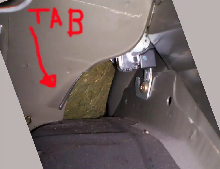

I feel like a broken record because anytime someone says somethign about a trunk noise I bring this up, but check the tabs where the back seat bracket meets the wheel well area. Mine was making a clunking/squeaking noise when I went over bumps. All you need to do is stick a screwdriver between the tabs and bend one back.
Hope this helps.
