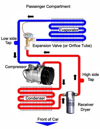

it should be in the same general location of the picture below....
*points up to the picture*
That is the wrong system. That is not what is in the 91 Mustang.
