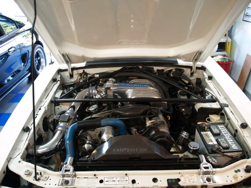

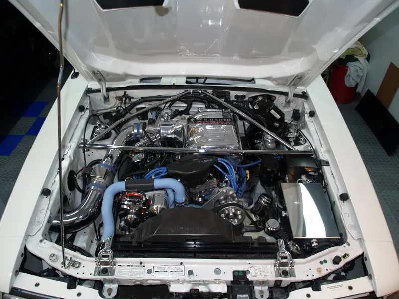

I live in Seattle where it rarely gets hot and I rarely, if ever, drive my car with the top up. I ditched it to clean thngs up under the hood.
Before:
After:
