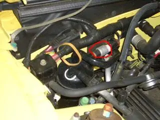

svttech76 said:
most likely the low side cycling switch is bad. could also be a CCRM fault or a high side switch,.
Yep what he said. I had the same problem with my 97 and was told on another A/C thread here that the low side cycling switch was bad. The part only cost like 12 bucks at ORalley's or Autozone. Give it a try. I tried to attach a pic of 4point6's underhood. Hopefully he doesn't mind, but anyway I circled in red the switch that I replace that gave me instant cold A/C...
