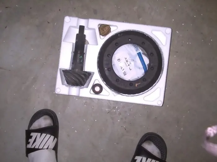

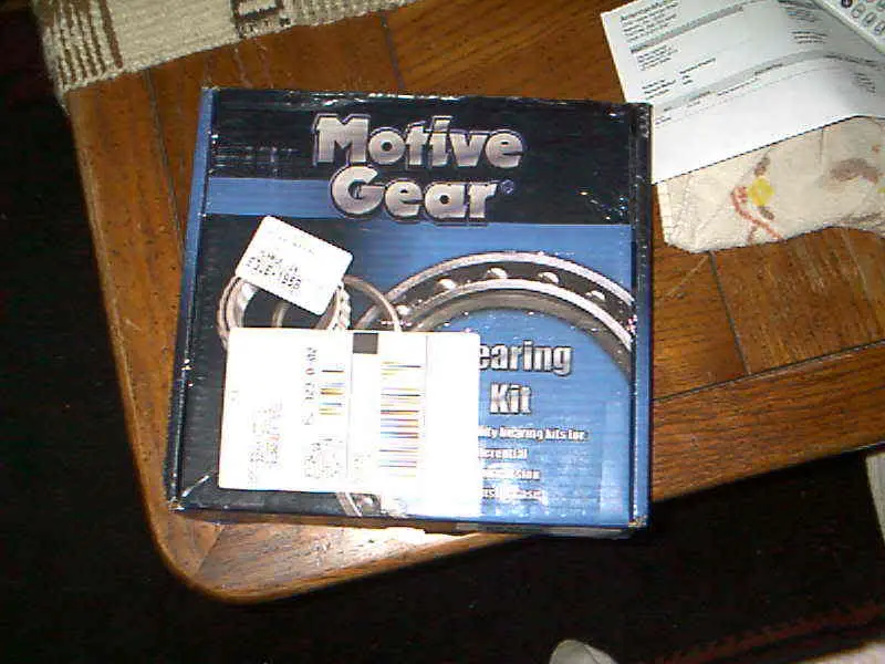

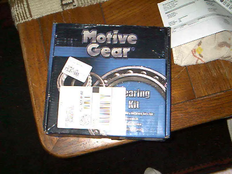

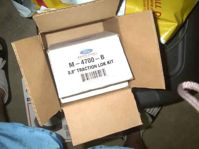

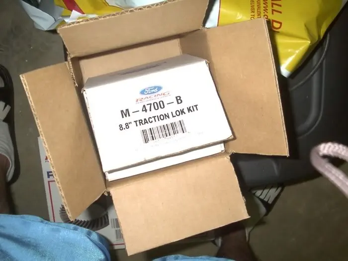

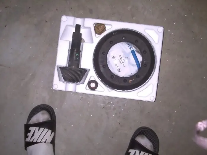

Well 2 of the 3 pieces to complete the rear end puzzle came today.
