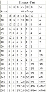

I hate to thread jack but jrichker I'm doing the 3g swap what the maximum length of wire I can go before I run into problems I'm trying to run it from the back of the alternator into the fender around the bumper to the starter solenoid

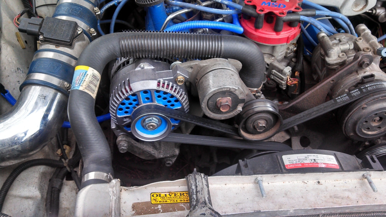

ok guys. Thanks to you guys I got my 3g alternator in and wired up. It was a breeze with the direction you guys gave. Can't thank you enough. What ya think?
Wire size current table:
  • 53745d1205096904-how-determine-proper-fuse-wire-size-wire-gauge-current-capacity-lenght-chart.gif

K thanks man looks like I will need 2 gauge wire for 12 feet
