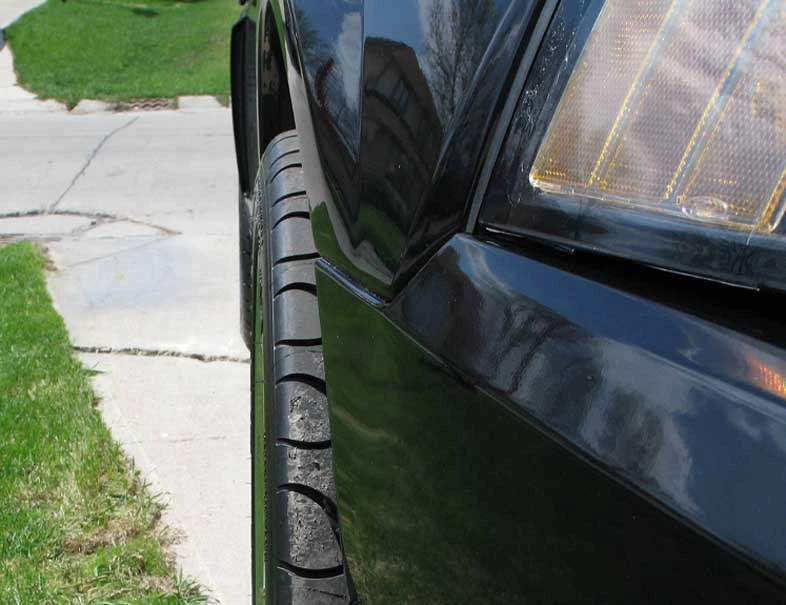

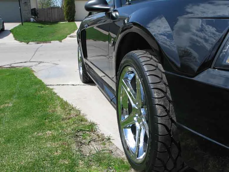

Definately don't go with 275 on the front, i just got my new wheels on friday, 18x9 with 275 on all four, and they stick out of the front fender...
I dont know if its more the fault of the 9 inch rim or the 275 tire...do you other guys with 275 up front look like this? How about a 9 inch rim with 265 or 255 tire, do they not stick out this much?

4.6_02_black_gt do you have any pics of a rear view so i can see how big the 275's look from behind? i really want to get 295's b/c of how much they stand out in the rear, but i might go 285's due to the fact that thats the biggest some companies make (i.e. the eagle f1 gs-d3's). but if 275's look decent i might go w/ them to save a few extra dollars.
blk01gt do you have any side views of those saleens? at first the seemed like they were 17"s in the bottom picture. im going to get 18" chrome saleens in about a month whenever the first summer job pay check comes in!
