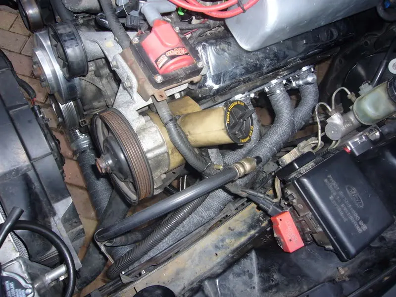

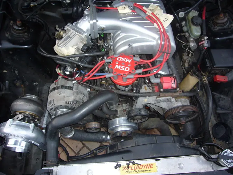

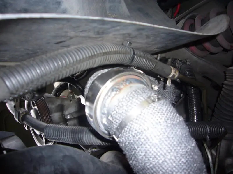

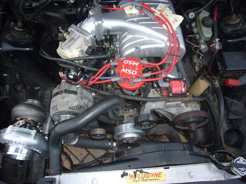

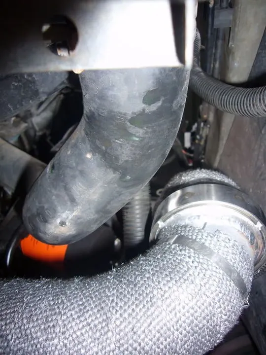

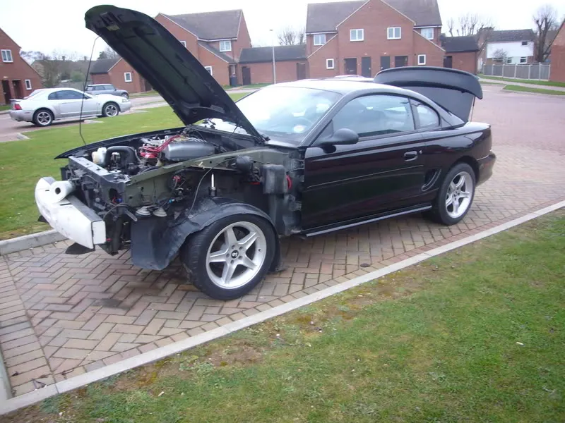

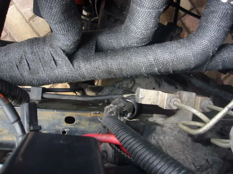

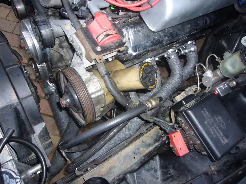

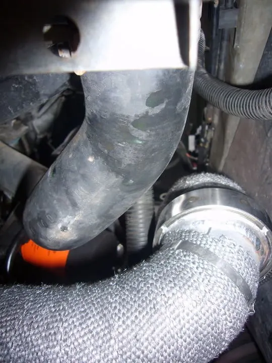

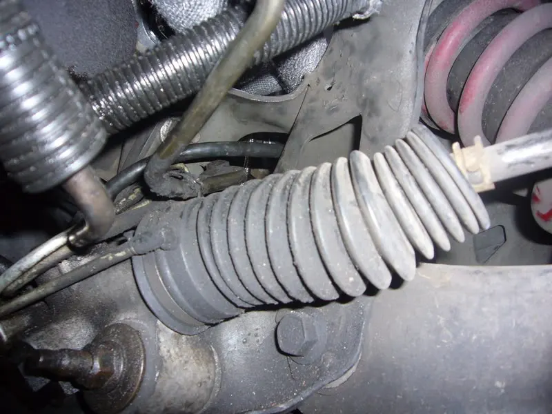

Well it has begun first off i will recap what has been done so far to make it fit; the ABS module has been moved under the frame to make way for the cold pipe coming off of the turbo, the sway bar had to be removed because the drivers header was hitting it, the starter wire and clutch cable have been rerouted so they are no longer hitting the drivers side header, and i bent the power steering line away from the drivers header as well. So far the fit seems pretty good except for the clearance issues which aren't to big of a deal. I would have liked to keep the sway bar, and i may look into spacing it down to get it to fit but I'll see how it handles first.
here are some current progress pics and i'm hoping to have most of the kit installed by the end of this upcoming weekend.

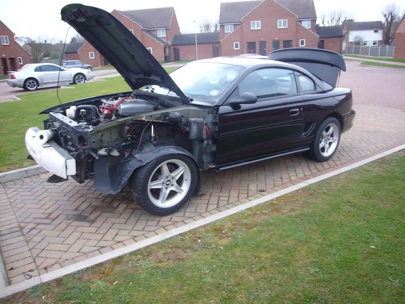

won't have any progress till tommorow but here are some more pics of whats done so far.........
my work area.......

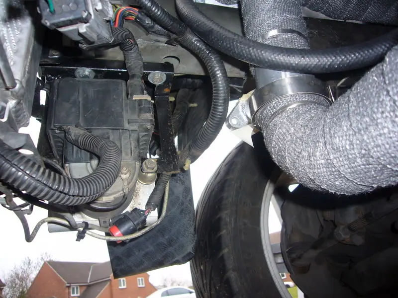

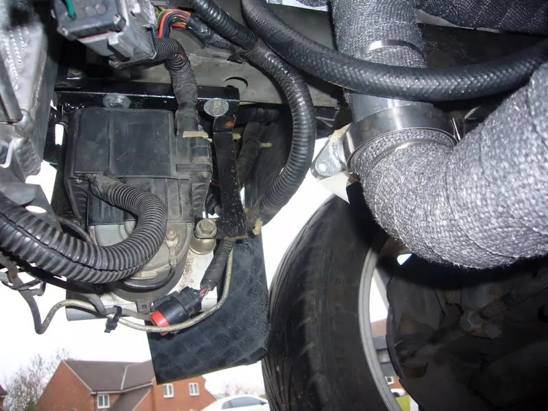

the ABS module relocation........

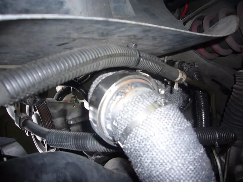

the clearance of the lower radiator hose......

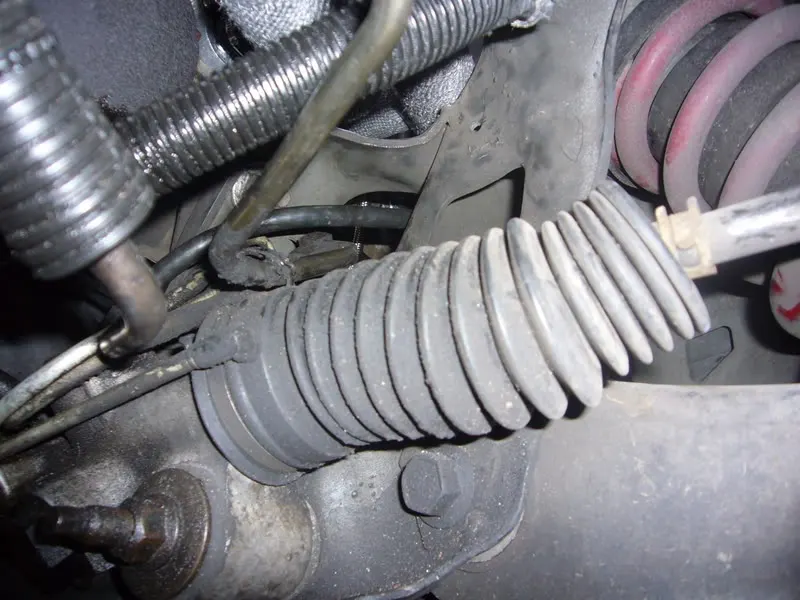

clearance of power steering lines (think i need to move the one further away still........

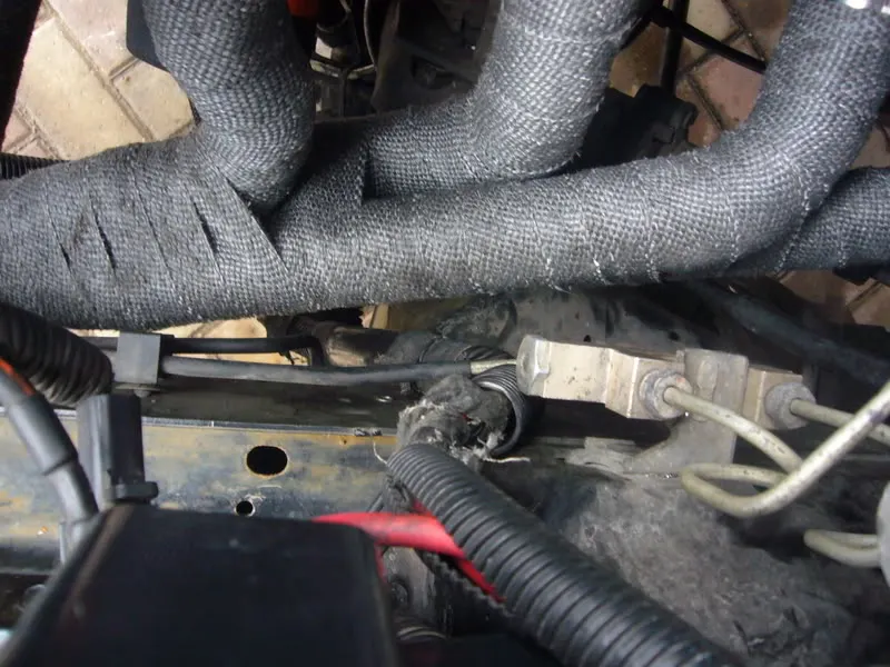

clearance on the starter wire.........
the clutch cable rerouted through the motor mount.......

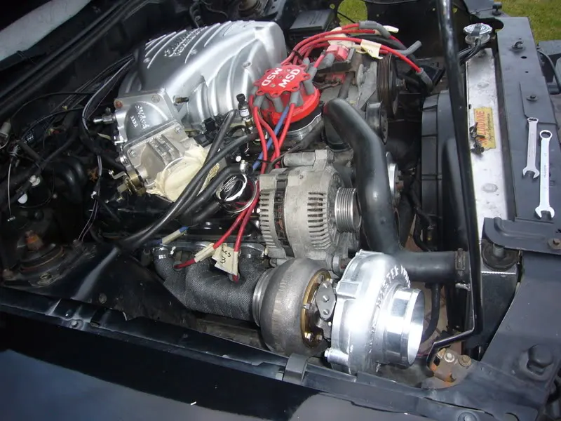

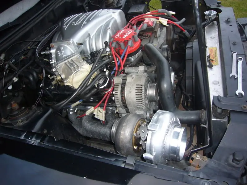

wow... looking good turbo's seem to be the way stang owners are heading...it looks like your oil fill tube and your tb are damn close are you gonna have enough room...?? and the other pic with the toilet paper on the bumber whats up with that when you saw the turbo auctually in the car did you boom boom your pants lol :D
all joking aside it looks like your having fun and a damn cool project and looks to be coming a long nicely
i've been watching your install at turbomustang.com. i replied a few times.
like i said great job man.
what style of filter do you have for that thing?
I have the shortest one i could find, about 3" long but i'll still have to do a little cutting and loose my hood support rod. I'm planning on putting one of those strut kits on.
