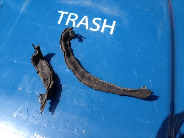

Getting the old weatherstrip off was hard enough. You have to use pliers to rip out the old weather strip, which is rubber with a thin metal core, and sits in a groove attached to the quarter window. It takes a twisting motion and comes off in small chunks..

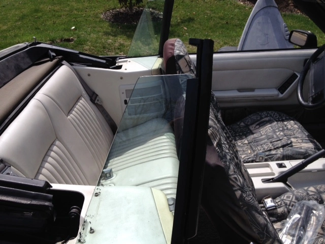

And then you need to push the new weatherstrip into the groove, which is a tight fit. I lubed it up with WD40 as suggested in the video, but only managed to get it "almost" in, at the expense of ripping the skin off my fingers, and getting several blisters. At the moment, I cant get it all the way in, and I'm not sure I can get it out again either without having to go through the process described above, which would destroy it.
Here's a picture of as far as I've gotten it after about 2 hours of messing with it, and beating the crap out of my hands by trying to inch it down a bit at a time. Eventually I just had to give up for now. At the moment my hands are beat up so I'm not sure how to go forward from here? It's such a straight forward relatively little thing to try and fix.. But it's turned out to be a real pain!

Yeah I've done it a couple times. Lubricating is a must. Like someone mentioned up top, I also applied Vaseline. I put it in the track on the glass in an attempt of keeping it off my fingers. I also learned that if you pull the new seal down in from the bottom instead of pushing it in the track it works better. When you pull in down from the bottom it seems to stretch somewhat making it a tad smaller and goes in easier.
When pushing it down from the top it seems to bunch up making it tighter. I pulled from the bottom and pushed from the top, worming it in so to speak. Either way it will put up a fight but pulling did seem easier.

I haven't pulled the trim off yet, but before my fateful trip yesterday that ended in a boom I tried one more to move the weatherstrip. It was totally stuck. Eventually in the process of trying to pull it off, so I could try and re-lube it, I ended up pulling it's head off it (the top part). So it's trashed.
Seems silly to have to buy another pair just replace the one, but it looks like that's what I'm going to have to do.. Unless someone out there has a spare passenger side weatherstrip they want to sell me. Hopefully I'll do better on my 2nd try. I appreciate everyone's helpful comments so far, and hopefully if I apply them they'll help me get it this time.
