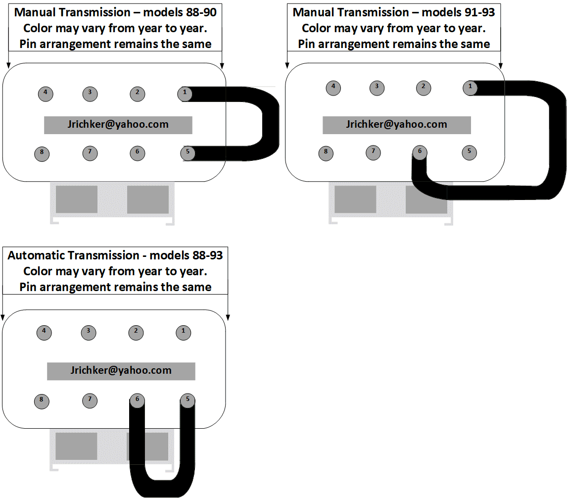

Verify your o2 sensor harness jumper is set correctly for your transmission and ECU (manual or auto are pinned differently)

Is the jumper with the wire that loops around in the same connector?
The jumper is on the o2 sensor sensor harness normally under the MaF. You really need to pay attention to how it’s pinned as improperly pinning it will fry an ECU.
usually the issue is mixing and matching harnesses in non-original cars where harnesses are sourced from other cars.
here’s how to repin the harness
do not put another ECU in until you verify and check for voltage on pin 46. Constantly running fuel pump is a symptom of a fried ECU.
the o2 harness jumper should match the ECU, and the ECU/o2 should match the actual transmission in the car
