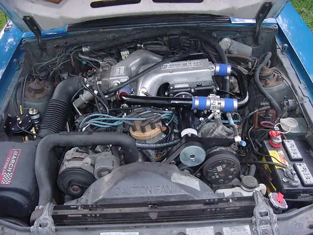

This may help a little:
If you look up in the back against the firewall next to the salt and pepper shakers you'll see the one way check valve that goes between the discharge manifold and the MAP sensor. The fuel is ramped up by two methods... a Kenne Bell Boost-a-pump (which is boost referenced) and the FMU (also boost controlled). I currently have 24 lb injectors installed and see roughly 7 lbs of boost in the heat of the summer (9lbs when it's cooler outside).

jaymac said:
how do 24#ers work w the speed density computer?
It's hit or miss. Some folks have to have a custom tune or ECU tuner to get them to function correctly. If you're only planing to run 5-6 lbs of boost then it's not something you really need to be concerned with. The 19s will work just fine with an FMU and either a larger fuel pump or boost-a-pump.
