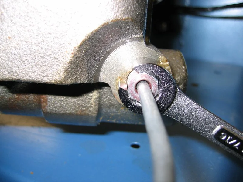

Great upgrade - I did it on my 02 GT...well worth the money, no leaks here...use the PROPER TOOLS. Most auto parts stores have an inexpensive set of flare line wrenches you'll need - spend a few bucks and save some cussing.
