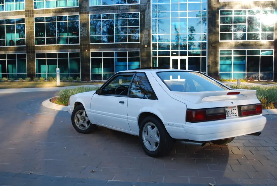

As the title says... im about to throw on some H&R super sports. Any suggestions or helpful pointers that i could use? Heres a pic before:
Any help/advice is appreciated :)

The onlly thing I will say is that when I put H&R's on my car (Sport, not Super Sport) The rear sat a bit lower than I liked so I ended up buying some adjustable rear control arms to rais the rear up a bit. They say both the Sport and Super Sport springs lower the car 1.0 in the rear, but mine went down more than that. Maybe yours will sit differently, but that was my experience.

If you care to take a look at the stance of the car there are pictures in the thread below.
http://www.stangnet.com/mustang-forums/840808-new-paint-pictures.html
