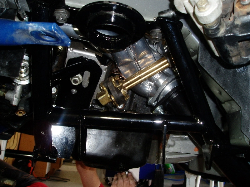

Does anyone make a tubular K member and A arms that don't require a coil over conversion? I'm not sure I want or can afford a full coil over swap right now but i would like to put a tubular K member in this winter. Does anybody know of one?
You may also remember that with a K-member and A-arm swap, you're going to need a tie rod-end kit, and probably some caster camber plates (assuming you change to different springs that lower the car).
What kind of shocks/struts are you running ?
Finally, is this something you drive daily on the street, or is this like a weekend racer type deal ?
PA Racing will weld in spring perches for you.
I run my stock A-arms and Eibach Pro-Kit springs on mine.
You will need C/C plates to get it in alignment.
More Info here PA Racing K-Member
