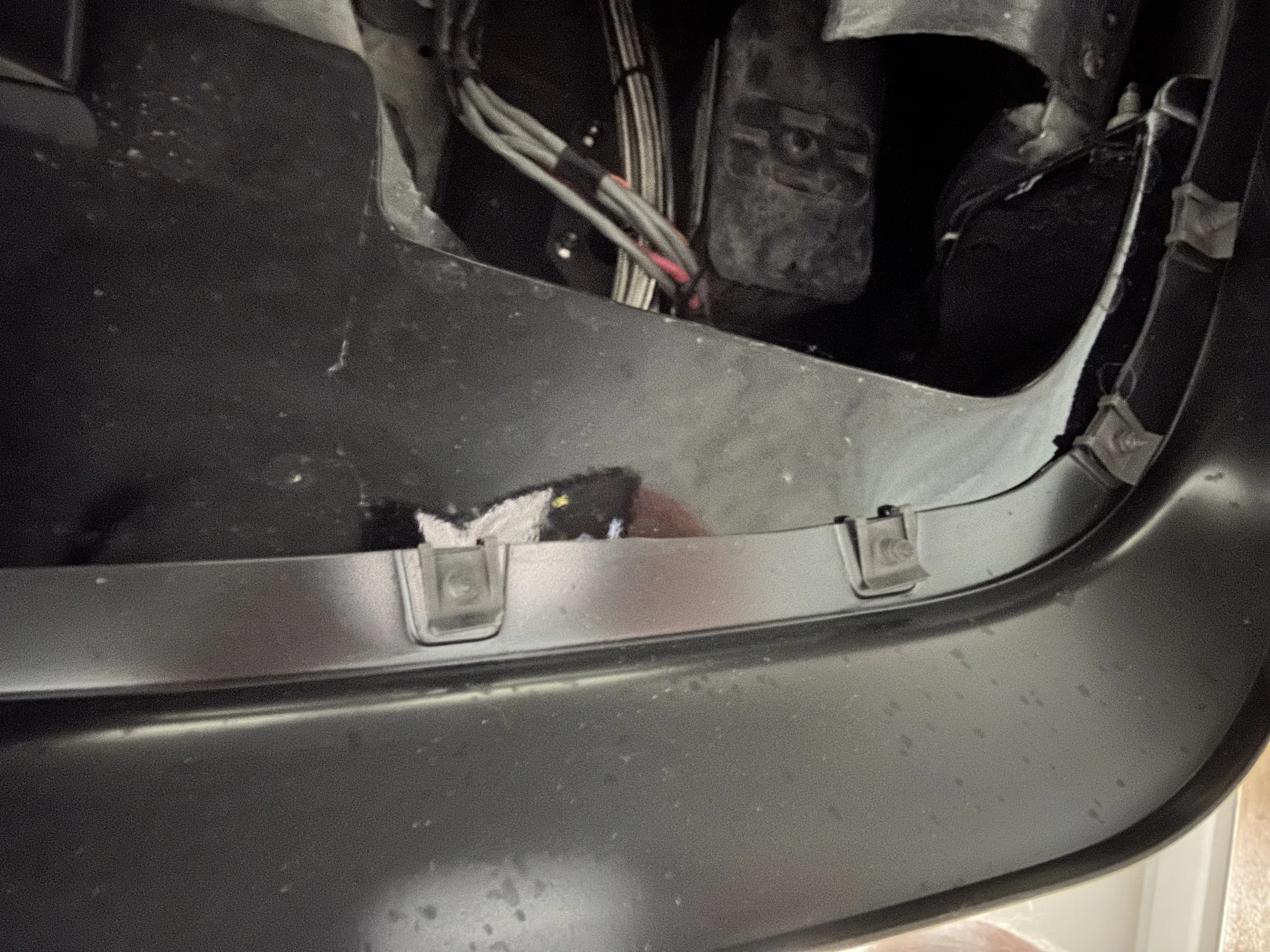

May 17, 2025
#27
  • May 17, 2025
  • #27
Well seven days later isn’t bad…my apologies as work and life stuff got in the way. This is as good as I can do as it would take removing the inner wheel well to get a better shot.
So this is looking up while under the front of my car from the passenger side. I remember having to massage the stock bracket a little bit it was an easy fit.
