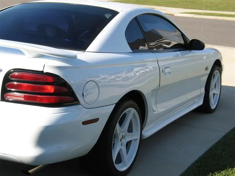

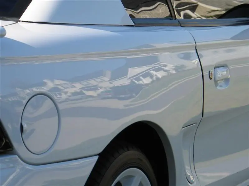

Yup a real buffer and some compound will really wake the paint up. Here mine I just did last week (I used Wolfgang's Deep Gloss Sealant for paint protection)
A far as I know this car has spent the better part of it's life outside 24/7. Now it looks better then some other new white gt's I've pulled up next too.
