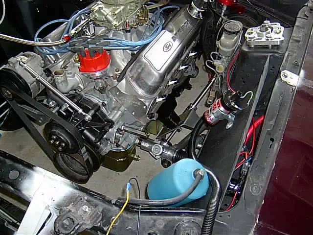

Dont mean to hi-jack your thread or anything but i have a question along these lines. I already have removed my AC and SMOG on my stang but i just yesterday got a KILLER deal on a FR Manual steering kit ($150 shipped - NEW) and want to know if any of you know how to route the belt after removing the PS pump. All i need to run is my water pump and my alternator off that belt, trying to figure out how to do it. If you have any good ideas let me know.

Take a look at my motor! Thats all I'm runnig_ go to my cardomain page!
Forward rotation water pump from Jegs' and March adjustable alt bracket

I got my a/c and smog delete kits from upr and I like them both. I got the idler pulley kits on both of them. as for the belt when you get done hold you old belt up to the pulleys you have left and see how much extra you have and go get the new belt.
Hey, how's that setup for belt slip. It's exactly what I have now but haven't fired it yet (winter). I used to have the UPR setup that moved the tensioner to the drivers side, but it would squeel like a pig when I had any kind of load on the 3G.
