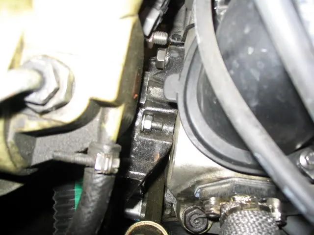

yeah, before doing it, make sure you have the belt. lol other wise your car might be down, until you can get one. i bought Marches AC/PS delete kit. BUT, if i want to delete both(which i did) it also deletes the smog pump. i guess they dont want AC/PS/SP delete in the title. it wasnt hard to install, BUT on mine it relocates the tension pulley where the AC was. when i put it on, everything looked fine, but the pulley was slightly out of alignement with the rest of the pulleys. so i just used a couple washers as shims. and it works beautifully.

forgot to add a pic for reference:
kind of a bad pic. if you need another one let me know.

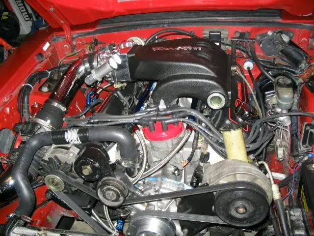

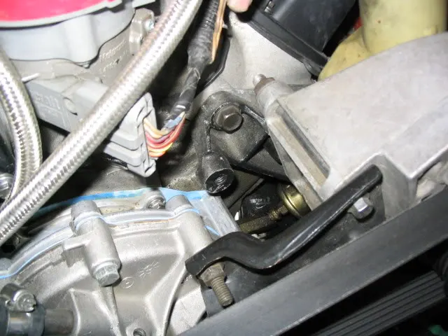

here is some pics of the ford delte kit on a 351. the hardest part is taking the time to shim the pump with washers until you can get it to where the belt stays on all the pullies.
